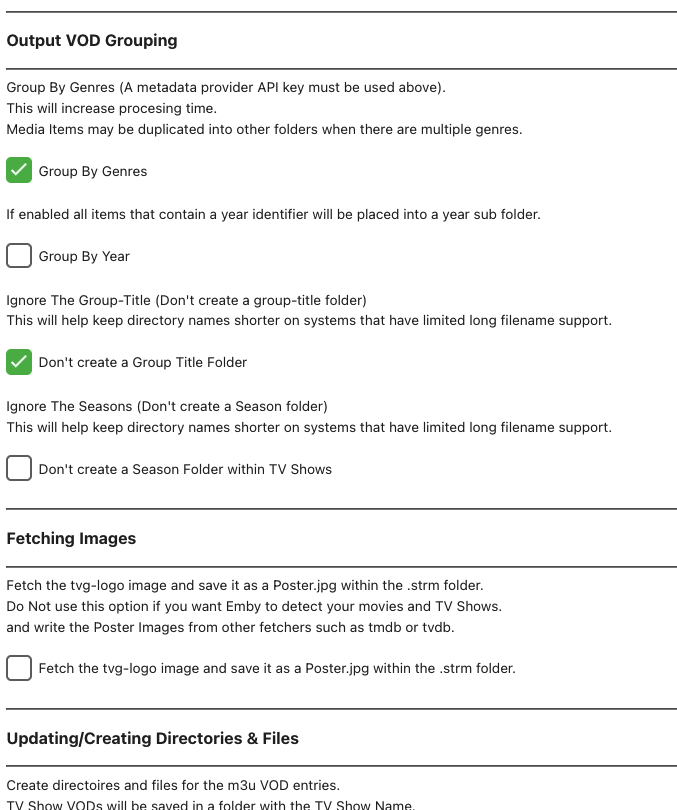

sftech13 25 Posted March 15, 2025 Posted March 15, 2025 6 hours ago, mickle026 said: OK, here goes! Its different, so copy your old dll, and the VODtoSTRMscheduledTask.xml from the plugins/configuration directory and back them up. Currently the only thing I know that is not working is fetching the Icons/Poster images. Also I still haven't tested the group by Genres yet, so don't know if that is working or not. The detection section has changed! Include will override the ignores. You can use your personal API keys from TMDB, TVDB or OMDB to add Provider Ids or collect Genre Information VOD Output grouping has more options Choose what you wish to output, you can now output whatever strms you like. Choose what you wish to log A LOT of work has gone into this - Let me know you findings! I have taken onboard as well that this might get used to output different things, so I am also thinking about adding a saved profiles section, so that it could be run with different configs. What do you tink? VODtoSTRMscheduledTask.dll 676 kB · 6 downloads Great work.....I like it.

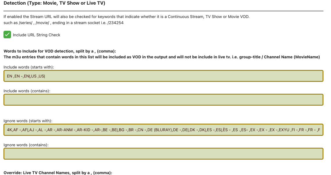

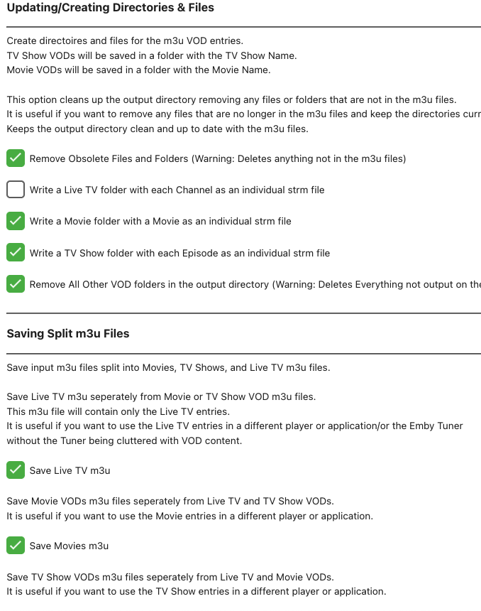

gillmacca01 220 Posted March 16, 2025 Posted March 16, 2025 Ok, VODS are created now, but if I add an additional ignore word, content is not being removed. Both boxes are ticked related to removal
BigIrn 10 Posted March 16, 2025 Posted March 16, 2025 (edited) 11 minutes ago, gillmacca01 said: Ok, VODS are created now, but if I add an additional ignore word, content is not being removed. Both boxes are ticked related to removal If you make a change to the plugin, save, and reopen the plugin, does it save your changes? Mine keeps reverting. I'm also having file locks around PRIME PPV US/ PRIME PPV 6 - MLS 360 EN ESPAÑOL Sat 15 Mar 23/20 8K EXCLUSIVE. Are you having any file locks? I have to restart the whole server each time. Do you mind sharing your filters? Edited March 16, 2025 by BigIrn forgot what I was talking about

gillmacca01 220 Posted March 16, 2025 Posted March 16, 2025 It appears to be saving OK. As far as i am aware, no file locks and it always completes. I'm using Mickle026 ignore list, which worked, but I then added 4K to the 2 ignore fields and that's where it is failing

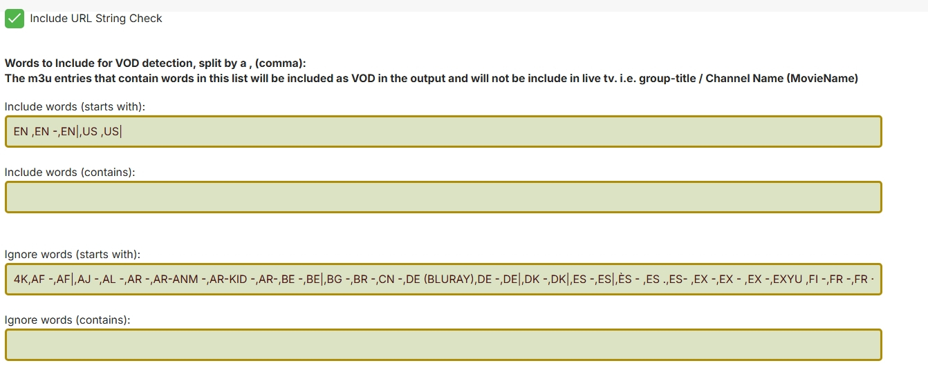

fbrassin 47 Posted March 16, 2025 Posted March 16, 2025 (edited) I run the plugin with your config, but i think ignore doesn't ran as it should. I.E. XXX has been created. In requested words also i think doesn't work as it took files also without those words. This is my config <?xml version="1.0"?> <PluginConfiguration xmlns:xsi="http://www.w3.org/2001/XMLSchema-instance" xmlns:xsd="http://www.w3.org/2001/XMLSchema"> <EnableTMDBApi>false</EnableTMDBApi> <EnableOMDBApi>false</EnableOMDBApi> <EnableTVDBApi>false</EnableTVDBApi> <chkSaveUnknownsm3u>false</chkSaveUnknownsm3u> <chkLogSplitting>true</chkLogSplitting> <chkRemoveAllOtherVodFolders>false</chkRemoveAllOtherVodFolders> <chkWriteLiveTVVods>false</chkWriteLiveTVVods> <chkWriteMovieVods>true</chkWriteMovieVods> <chkWriteTVshowVods>true</chkWriteTVshowVods> <IgnoreSeasonFolder>false</IgnoreSeasonFolder> <chkLogIO>true</chkLogIO> <chkEnableURLChecking>true</chkEnableURLChecking> <IgnoreGroupTitleFolder>true</IgnoreGroupTitleFolder> <GroupByGenres>false</GroupByGenres> <GroupInYears>false</GroupInYears> <TMDBApiKey /> <OMDBApiKey /> <TVDBApiKey /> <m3uImportVODFile>/tmp/list.m3u</m3uImportVODFile> <m3uImportVODFile2 /> <m3uImportVODFile3 /> <chkRemoveObsoleteEntries>true</chkRemoveObsoleteEntries> <chkLogMultiThread>true</chkLogMultiThread> <VODInclusionWords>vod,video on demand,movie,film,video,apple+ tv,netflix</VODInclusionWords> <m3uOverrideLiveTVChannelNames /> <m3uOverrideMovieVODChannelNames /> <m3uOverrideTVShowsVODChannelNames /> <IncludeWords_StartingWith /> <IncludeWords_Contains>EN ,EN -,EN|,US ,US|</IncludeWords_Contains> <IgnoreWords_StartingWith /> <IgnoreWords_Contains> 4K,AF -,AF|,AJ -,AL -,AR -,AR-ANM -,AR-KID -,AR-,BE -,BE|,BG -,BR -,CN -,DE (BLURAY),DE -,DE|,DK -,DK|,ES -,ES|,ÈS - ,ES .,ES- ,EX -,EX - ,EX -,EXYU ,FI -,FR -,FR - ,FR-,FR|,GR -,GR|,IL -,IL|,IN -,IN-,IN|,IR -,IR-,IS -,IT -,IT|,JP -,JP|,KR -,KR|,KU -,KU|,LA -,LAT -,LAT-,LATT -,LAT.. -,LATINO,MT -,MT|MT,NF -,NF - ,NF-,NF - ,NL 24,NL FILMS,NL F,NL HBO,NL M,NL NETFLIX,NL R,N -,NL -,NL ,NL|,NO -,NO|,PK -,PL -,PT -,PT ;,PT|,QC -,QFR -,RO -,RU -,RU|,RX ,SC -,SC|,SE -,SE|,SH -,TOP -,TOD -,TR -,TR|,VIU -,WIT-,XU -,XU|,###,(DE),(FR),(GR),(IR),(KR),(RU),(TR),FOR ADULTS,XXX,XXL</IgnoreWords_Contains> <chkfetchImages>false</chkfetchImages> <chkSaveLiveTVm3u>true</chkSaveLiveTVm3u> <chkSaveMoviesm3u>true</chkSaveMoviesm3u> <chkSaveTVShowsm3u>true</chkSaveTVShowsm3u> <m3uExportFiles /> <chkLogm3uToStrm>true</chkLogm3uToStrm> <chkLogVerbose>true</chkLogVerbose> <m3uExportMovieSTRMS>/media/S3/m3u</m3uExportMovieSTRMS> </PluginConfiguration> And also full log. FileWriteDebugLogging [M3UToStrm]16.mar.2025.txt ScheduledTask-[M3UToStrm]16.mar.2025 - 07.40.30.txt Edited March 16, 2025 by fbrassin

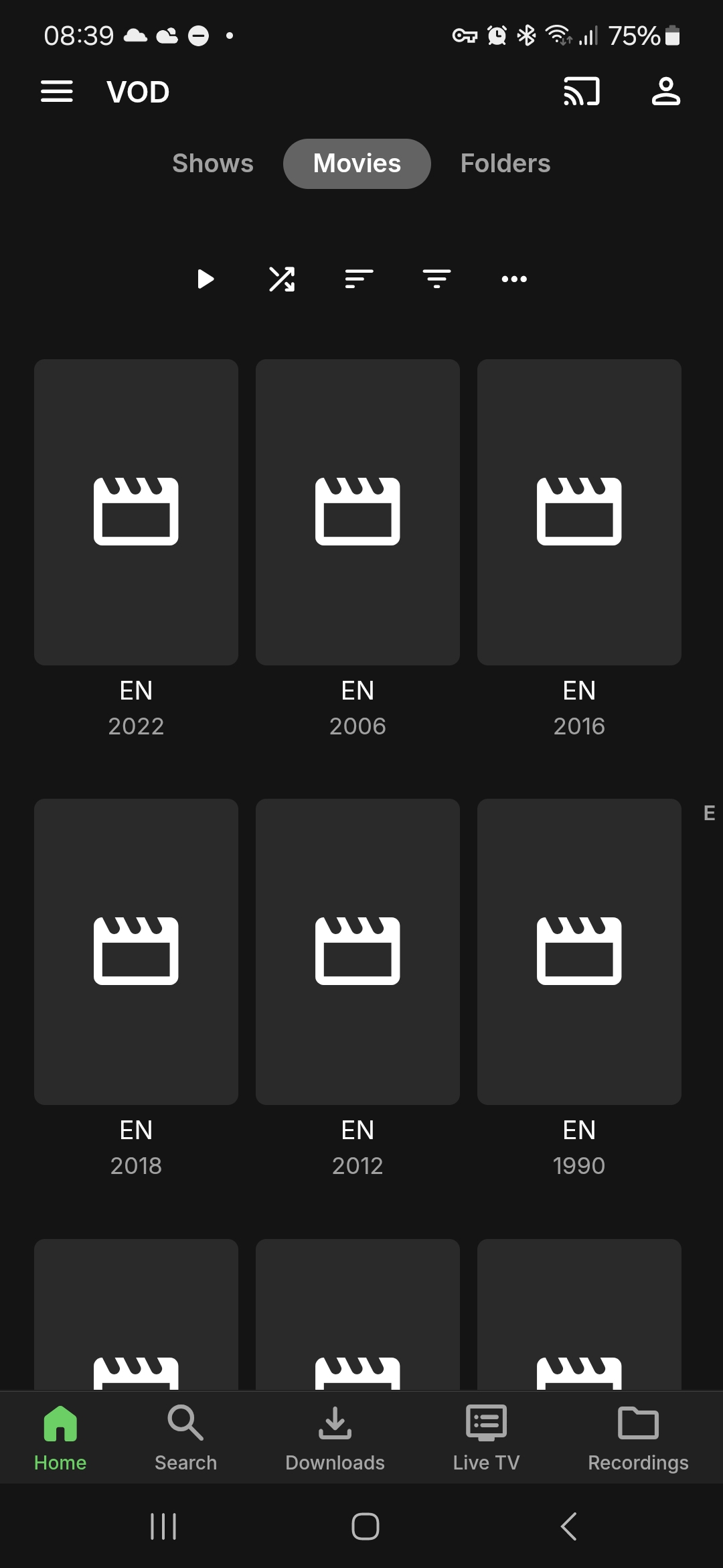

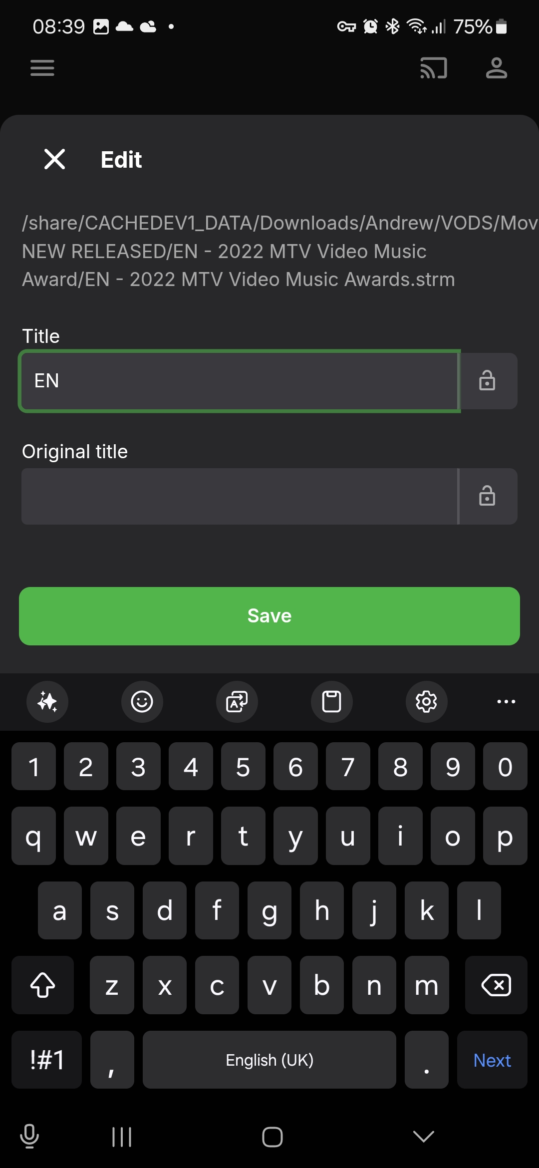

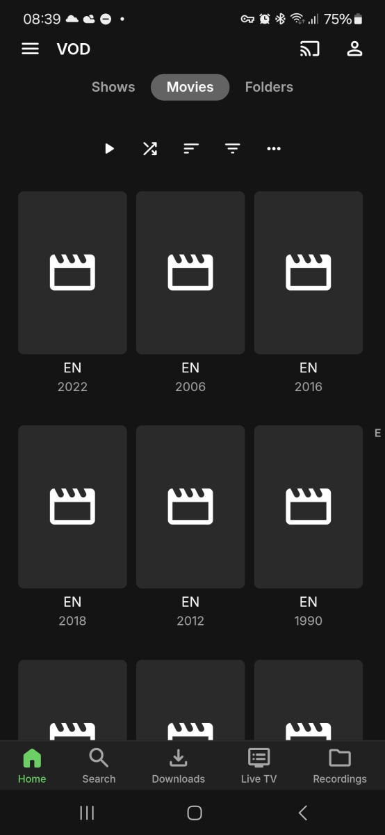

gillmacca01 220 Posted March 16, 2025 Posted March 16, 2025 Your gonna start hating us. Come across another problem, but this may be an Emby issue. Attached 2 screenshot. 1st is what Emby is calling it. The second is the metadata screen
BigIrn 10 Posted March 16, 2025 Posted March 16, 2025 1 hour ago, fbrassin said: I run the plugin with your config, but i think ignore doesn't ran as it should. I.E. XXX has been created. In requested words also i think doesn't work as it took files also without those words. This is my config <?xml version="1.0"?> <PluginConfiguration xmlns:xsi="http://www.w3.org/2001/XMLSchema-instance" xmlns:xsd="http://www.w3.org/2001/XMLSchema"> <EnableTMDBApi>false</EnableTMDBApi> <EnableOMDBApi>false</EnableOMDBApi> <EnableTVDBApi>false</EnableTVDBApi> <chkSaveUnknownsm3u>false</chkSaveUnknownsm3u> <chkLogSplitting>true</chkLogSplitting> <chkRemoveAllOtherVodFolders>false</chkRemoveAllOtherVodFolders> <chkWriteLiveTVVods>false</chkWriteLiveTVVods> <chkWriteMovieVods>true</chkWriteMovieVods> <chkWriteTVshowVods>true</chkWriteTVshowVods> <IgnoreSeasonFolder>false</IgnoreSeasonFolder> <chkLogIO>true</chkLogIO> <chkEnableURLChecking>true</chkEnableURLChecking> <IgnoreGroupTitleFolder>true</IgnoreGroupTitleFolder> <GroupByGenres>false</GroupByGenres> <GroupInYears>false</GroupInYears> <TMDBApiKey /> <OMDBApiKey /> <TVDBApiKey /> <m3uImportVODFile>/tmp/list.m3u</m3uImportVODFile> <m3uImportVODFile2 /> <m3uImportVODFile3 /> <chkRemoveObsoleteEntries>true</chkRemoveObsoleteEntries> <chkLogMultiThread>true</chkLogMultiThread> <VODInclusionWords>vod,video on demand,movie,film,video,apple+ tv,netflix</VODInclusionWords> <m3uOverrideLiveTVChannelNames /> <m3uOverrideMovieVODChannelNames /> <m3uOverrideTVShowsVODChannelNames /> <IncludeWords_StartingWith /> <IncludeWords_Contains>EN ,EN -,EN|,US ,US|</IncludeWords_Contains> <IgnoreWords_StartingWith /> <IgnoreWords_Contains> 4K,AF -,AF|,AJ -,AL -,AR -,AR-ANM -,AR-KID -,AR-,BE -,BE|,BG -,BR -,CN -,DE (BLURAY),DE -,DE|,DK -,DK|,ES -,ES|,ÈS - ,ES .,ES- ,EX -,EX - ,EX -,EXYU ,FI -,FR -,FR - ,FR-,FR|,GR -,GR|,IL -,IL|,IN -,IN-,IN|,IR -,IR-,IS -,IT -,IT|,JP -,JP|,KR -,KR|,KU -,KU|,LA -,LAT -,LAT-,LATT -,LAT.. -,LATINO,MT -,MT|MT,NF -,NF - ,NF-,NF - ,NL 24,NL FILMS,NL F,NL HBO,NL M,NL NETFLIX,NL R,N -,NL -,NL ,NL|,NO -,NO|,PK -,PL -,PT -,PT ;,PT|,QC -,QFR -,RO -,RU -,RU|,RX ,SC -,SC|,SE -,SE|,SH -,TOP -,TOD -,TR -,TR|,VIU -,WIT-,XU -,XU|,###,(DE),(FR),(GR),(IR),(KR),(RU),(TR),FOR ADULTS,XXX,XXL</IgnoreWords_Contains> <chkfetchImages>false</chkfetchImages> <chkSaveLiveTVm3u>true</chkSaveLiveTVm3u> <chkSaveMoviesm3u>true</chkSaveMoviesm3u> <chkSaveTVShowsm3u>true</chkSaveTVShowsm3u> <m3uExportFiles /> <chkLogm3uToStrm>true</chkLogm3uToStrm> <chkLogVerbose>true</chkLogVerbose> <m3uExportMovieSTRMS>/media/S3/m3u</m3uExportMovieSTRMS> </PluginConfiguration> And also full log. ScheduledTask-[M3UToStrm]16.mar.2025 - 07.40.30.txt 69.03 MB · 0 downloads FileWriteDebugLogging [M3UToStrm]16.mar.2025.txt 903.63 kB · 0 downloads Check if your password is in the log before attaching it publicly. I didn’t look for myself but I’ve managed to do it several times the last two weeks.
BigIrn 10 Posted March 16, 2025 Posted March 16, 2025 41 minutes ago, gillmacca01 said: Your gonna start hating us. Come across another problem, but this may be an Emby issue. Attached 2 screenshot. 1st is what Emby is calling it. The second is the metadata screen What happens when you change the view to a list? Does the title appear?
gillmacca01 220 Posted March 16, 2025 Posted March 16, 2025 2 minutes ago, BigIrn said: What happens when you change the view to a list? Does the title appear? Never thought of trying that, but unfortunately still the same

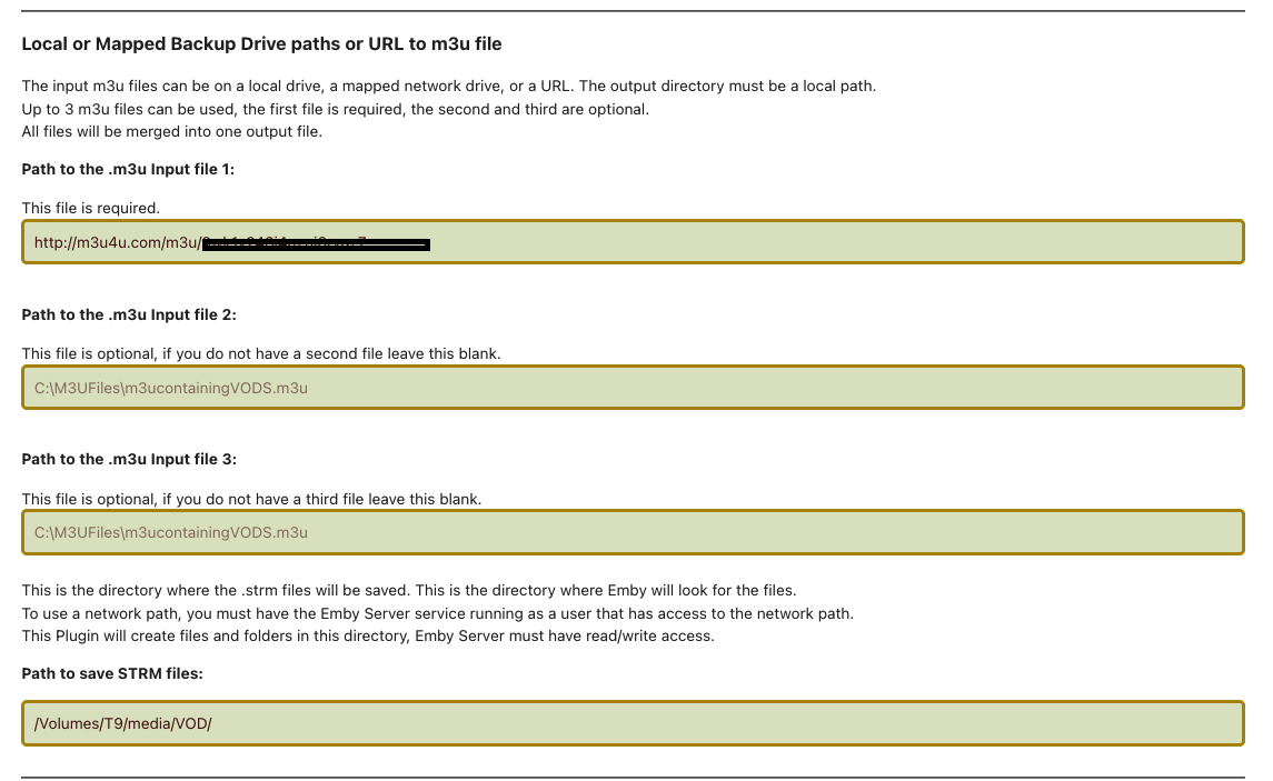

gillmacca01 220 Posted March 16, 2025 Posted March 16, 2025 (edited) 26 minutes ago, BigIrn said: Check if your password is in the log before attaching it publicly. I didn’t look for myself but I’ve managed to do it several times the last two weeks. Strangely enough, on the old version, I had to set xxx as ignore. This version, is automatically ignoring it - I don't want xxxx anyway Edited March 16, 2025 by gillmacca01
fbrassin 47 Posted March 16, 2025 Posted March 16, 2025 38 minutes ago, BigIrn said: Check if your password is in the log before attaching it publicly. I didn’t look for myself but I’ve managed to do it several times the last two weeks. I checked, but i don't think my password is in the file. Did you see it?
gillmacca01 220 Posted March 16, 2025 Posted March 16, 2025 1 minute ago, fbrassin said: I checked, but i don't think my password is in the file. Did you see it? Either you edited the file or you are using a Downloaded file - either way your good 1
fbrassin 47 Posted March 16, 2025 Posted March 16, 2025 24 minutes ago, gillmacca01 said: Strangely enough, on the old version, I had to set xxx as ignore. This version, is automatically ignoring it - I don't want xxxx anyway For me, it is not ignoring XXX even though i put xxx in ignore
