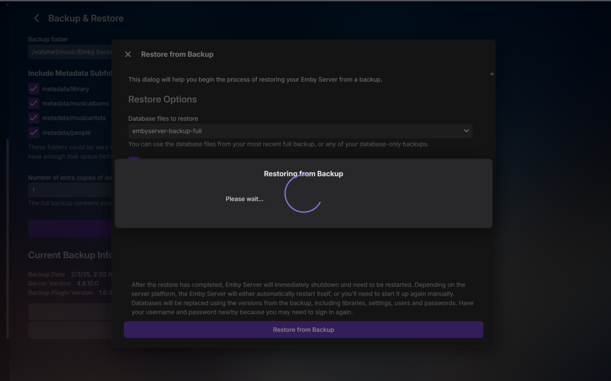

Kiniu 22 Posted February 12, 2025 Posted February 12, 2025 (edited) it seems to be stock at the very beggining. when i start "restore from back up" the turning whell is turning for hours and nothing happens. i tryed to restart serwer. couple of times nothing works Edited February 12, 2025 by Kiniu
Luke 42180 Posted February 12, 2025 Posted February 12, 2025 Hi, it works just fine, but depending on the size of the backup it can take a long time. If you still think there's an issue then please attach the emby server log: How to Report a Problem Thanks.

Luke 42180 Posted February 12, 2025 Posted February 12, 2025 But it looks like you tried to make changes in Emby library setup during the restore?
Kiniu 22 Posted February 12, 2025 Author Posted February 12, 2025 well.. yes i didnt knew if it is working so i tryed to do few things
Kiniu 22 Posted February 12, 2025 Author Posted February 12, 2025 so i understand that i have to leave it allone for that time?
Luke 42180 Posted February 12, 2025 Posted February 12, 2025 So the last step of the restore process is that the server either will automatically restart, or it will just shutdown entirely if auto-restarting isn't supported on your platform. In this situation, you just need to manually start it again after that happens. But I wouldn't do anything until that happens. I would do the restore again and then wait for that to happen. Please let us know if this helps. Thanks.
Kiniu 22 Posted February 12, 2025 Author Posted February 12, 2025 i sure will. thank u 4 your help. just to let you know it might be a while....
Kiniu 22 Posted February 13, 2025 Author Posted February 13, 2025 it did work eventually, after tenth time haha there was an error couple of times but i tryed again and again and i did it im very glad. thank you for your support 1
