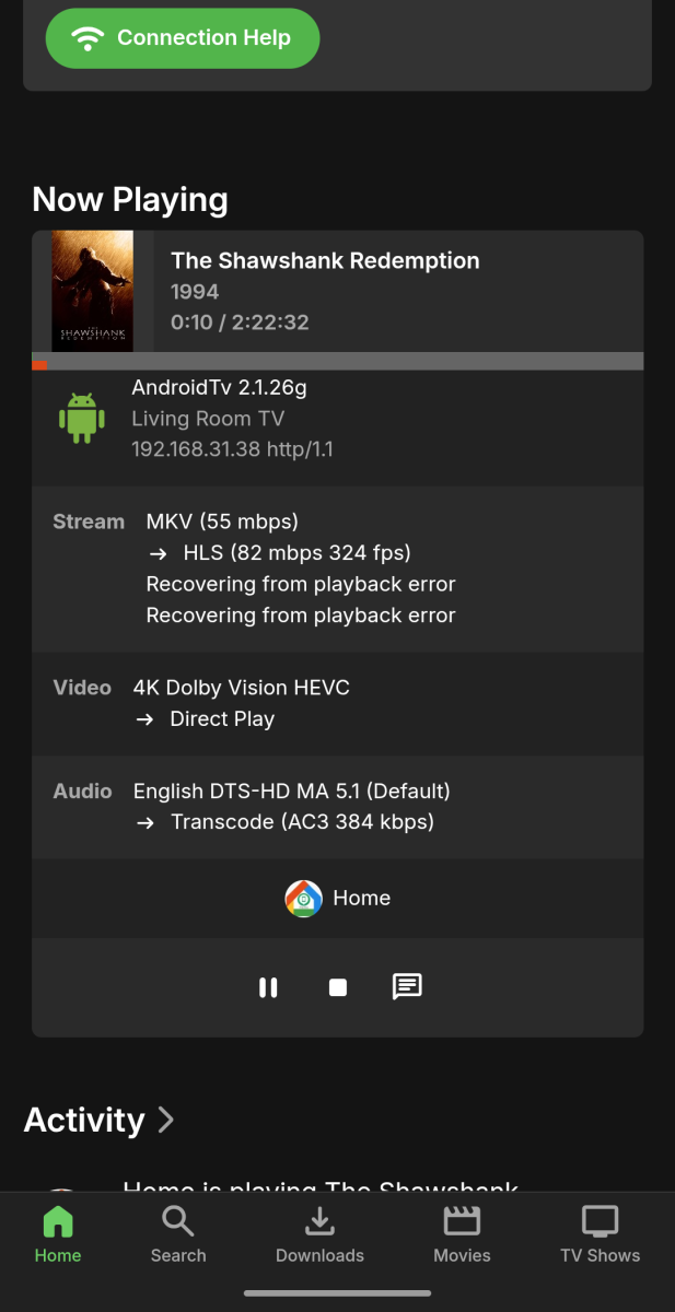

faandfo69 2 Posted February 28, 2025 Author Posted February 28, 2025 Hey, Sorry for the late reply i somehow missed the notification. Here a movie for example that transcodes in emby but not on jellyfin. (Se7en) Also for some reason i cant connect my headphones(SBC headphones or AAC earbuds tested so far) tv to watch anything But just like the above problem it works on jellyfin With emby EAC3 works every time but everything else is a bet In this example(se7en) But on the same TV with the same file somehow jellyfin is able to which is bending my mind Maybe it's using the equivalent of software decoding in emby but the audio is not the same in emby software decoding and jellyfin direct play But i guess the problem is that emby has no option to direct play all the time and if it can't direct play an audio just down mix to stereo instead of when I turn the feature on (manually in settings) down mix to sterio, it uses software decoding no matter what even if it is supported by the hardware still software decoding which messes with the audio The auto feature just transcodes if it cant direct play an audio and i have never seen it auto switch to dowmix to sterio so that it can avoid transcodingffmpeg-remux-5157e0a6-b9e9-44bb-8e0f-f62a985a7aec_1.txtffmpeg-remux-5157e0a6-b9e9-44bb-8e0f-f62a985a7aec_1.txt

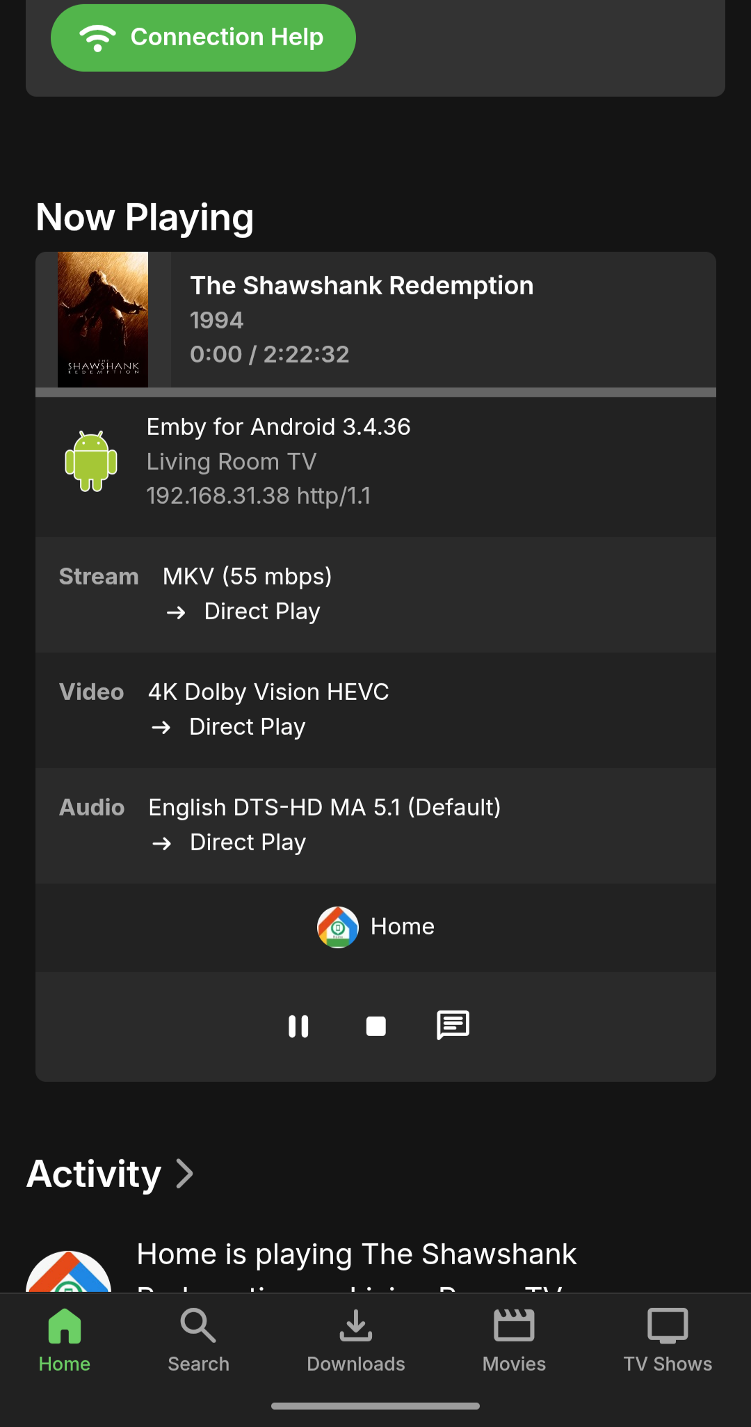

faandfo69 2 Posted February 28, 2025 Author Posted February 28, 2025 Hey Luke, Using the Standard Android app on my TV is not a great experience All the problems under the dedicated thread aside If Emby For Android TV can't direct play without software decoding it does not even start to play it on the android app on TV sinsce it cant transode

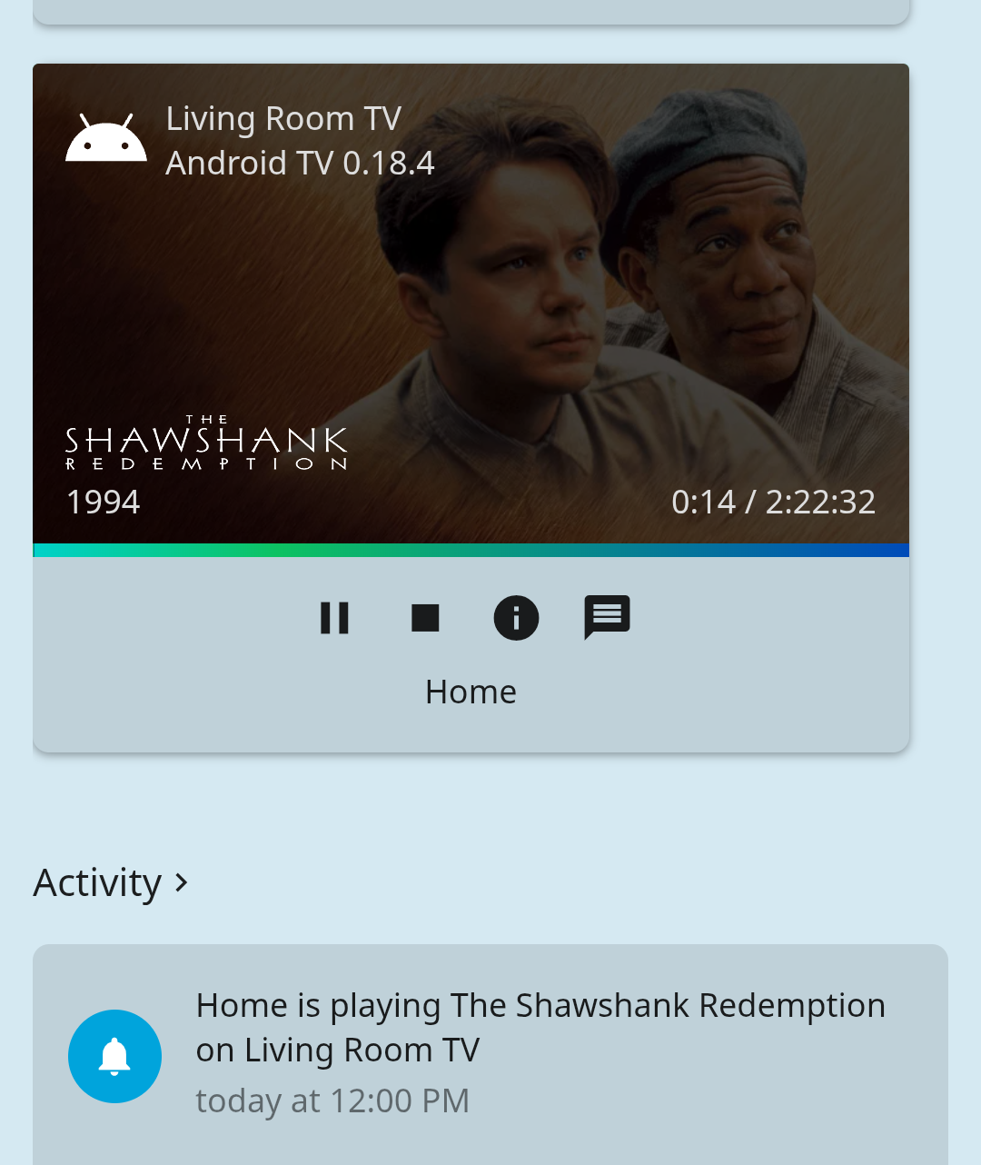

faandfo69 2 Posted February 28, 2025 Author Posted February 28, 2025 Same Movie Same Audio Track Same file Same Device Only difference is the App Used

ebr 16336 Posted February 28, 2025 Posted February 28, 2025 14 hours ago, faandfo69 said: Here a movie for example that transcodes in emby Your screenshot shows this is due to playback errors trying to direct play it. Can you please play that item until it is going using the TV app and then follow the instructions to send a log from the app?
