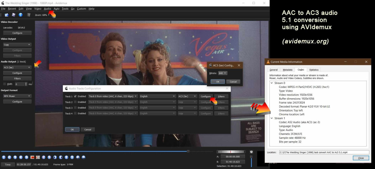

visproduction 335 Posted February 11, 2025 Posted February 11, 2025 I think full ffmpeg command line could probably do it. I like to use AVIDemux. It converts AAC 5.1 to AC3 5.1. That might work on your system.
