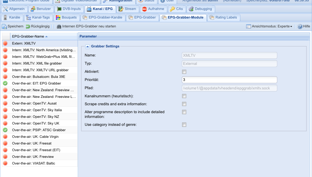

Horhäuser 7 Posted February 9, 2025 Posted February 9, 2025 (edited) Hallo, ich benutze Emby mit Tvheadend. Wenn ich eine Serie programmiere dann bekomme ich nicht die Möglichkeit eine Serie zu programmieren. Edited February 9, 2025 by Horhäuser
Carlo 4561 Posted February 11, 2025 Posted February 11, 2025 Hi, What is the source of your content in Tvheadend? Are you able to record a series in Tvheadend for this same show? Carlo
Carlo 4561 Posted February 13, 2025 Posted February 13, 2025 On 2/10/2025 at 10:11 PM, Carlo said: Hi, What is the source of your content in Tvheadend? Are you able to record a series in Tvheadend for this same show? Carlo
Horhäuser 7 Posted February 14, 2025 Author Posted February 14, 2025 (edited) Hallo, in TVH funktioniert die Auto Aufnahme, bei Emby nicht. Edited February 14, 2025 by Horhäuser
Carlo 4561 Posted February 16, 2025 Posted February 16, 2025 Hi, I'm confused by the TVH pic posted above showing both EIT and a PSIP ATSC grabber both enabled. Based on language I'd guess you're in Germany and would be using DVB. Being in the USA, I've not used this setup but it's my understanding, EIT typically is used to retrieve basic now/next information. In the UK typically Freesat/view would be preferred to use as it includes an extended version of EIT used by the Free-to-air DVB providers which includes additional information such as series links and episode identifiers. Without the additional episode and series information being present in the EPG I don't think it's possible to do series recordings.
Luke 42241 Posted February 20, 2025 Posted February 20, 2025 You could do keyword recordings though. 1
Horhäuser 7 Posted February 21, 2025 Author Posted February 21, 2025 Ich kann über Emby eine einmalige Aufnahme machen. Filme oder Serien kann ich über EPG suchen.
