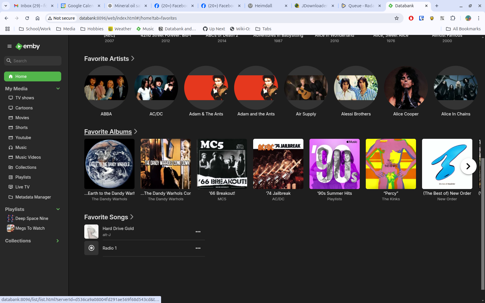

fcimeson 11 Posted February 9, 2025 Posted February 9, 2025 (edited) I can play music but when I go to favourite albums and try, the server seems to crash (around 21:08 in the logs). The server stopped showing content, and each new page I went to was blank. Restarted the container shortly after the crash (linuxserver/emby). embyserver-63874645751.txt Edited February 9, 2025 by fcimeson

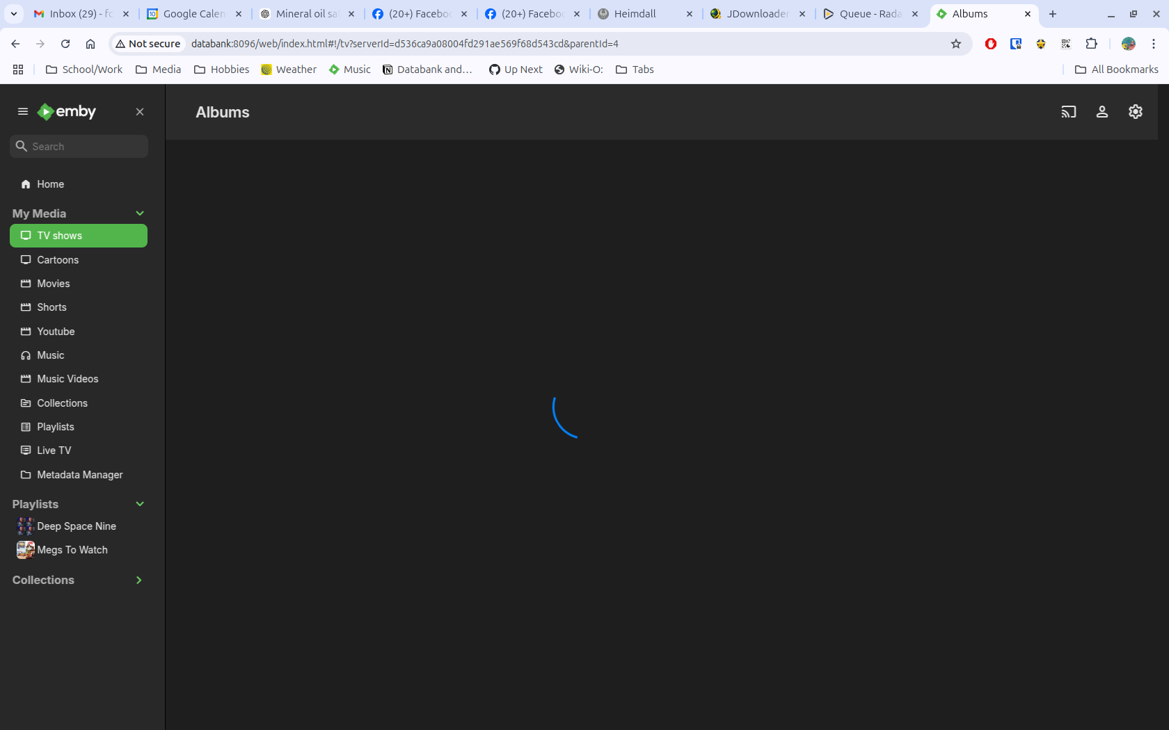

fcimeson 11 Posted February 11, 2025 Author Posted February 11, 2025 Thanks, I'm pretty sure it's the right log. Regardless, I removed the plugins, enabled debugging, and reproduced the issue with better notes. 22:42: removed plugins 22:44: enabled debugging 22:44: navigated to favorite albums 22:45: hit the shuffle button - nothing happened 22:47: tried to play a specific album (it started spinning but no music) 22:48: navigated to TV shows (blank screen) 22:49: downloaded logs 22:50: can't play any content (I had to restart the container) embyserver.txt

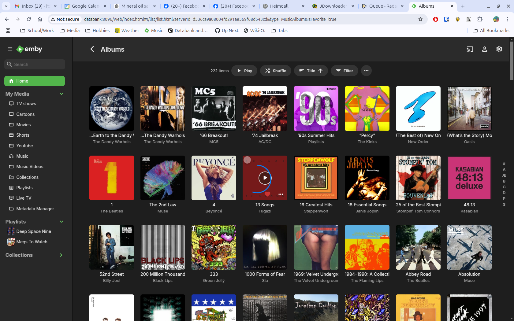

fcimeson 11 Posted February 23, 2025 Author Posted February 23, 2025 Nope, it happens when I press the shuffle button. After that the system is unresponsive.
Luke 42178 Posted February 24, 2025 Posted February 24, 2025 OK this is likely performance related. If you need immediate relief this should be resolved on the 4.9 beta channel.
