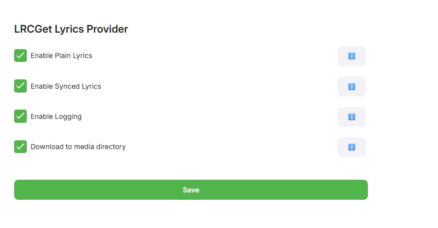

Unzip the archive and copy the dll to the plugins directory, restart the server.  You will find the config at the plugin and enable it, in your library.
The config screen allows you to choose what to download,
It operates seemlessly with a metadata refresh on the song track or Album, or if a newly added item being scanned in.

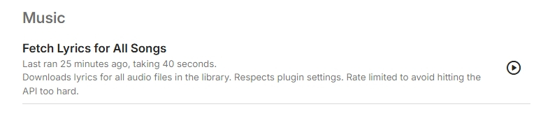

This is a totally new build, it runs during library scans, metadata refresh or as a Task, it has also got enabled for downloading like subtitles, but that's not working in the UI.
This version is in testing, it still needs a few more tweaks. So its only attached for the DEVS to look into the subtitle (Lyric) download
I have implemented the subtitle interface, it doesn't show in the UI,
It enums the audio as video content, there is no other options for audio.

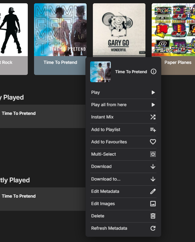

Screenshot_15-9-2025_14759_localhost.jpeg.864b1d0976d490e2ac1262980ffa9619.jpegScreenshot_15-9-2025_14745_localhost.jpeg.2f1a4f02d323e14617fd39d53cd1bed4.jpeg
what do i need to do for it to show, or is that on the devs?
@Luke I can pm my code if your need me to, but here is the subtitle interface
