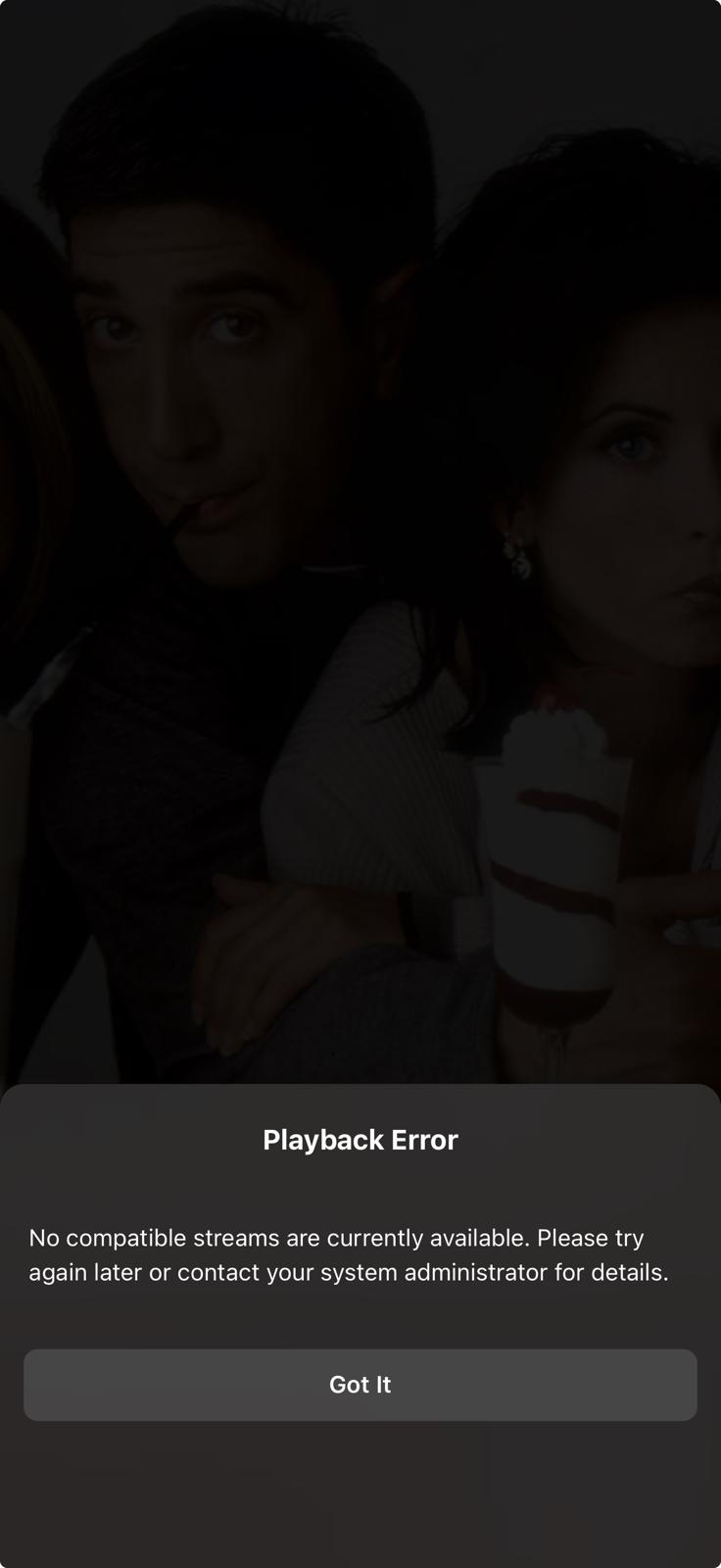

geraldomagella 1 Posted February 5, 2025 Author Posted February 5, 2025 (edited) Hey Luke, none, I couldn't find any. I did try to download a few friends episode before my trip though... Weirly enough, I just can't play any friends episodes on my Iphone anymore (re-installed Emby on my iPhone, just now). Edit: BTW: I can see the videos from the WebUI on my PC and on my phone, but not on the app itself. Error: No compatible streams are currently available, please try again later or contact your sysadmin for details. Edited February 5, 2025 by geraldomagella
geraldomagella 1 Posted February 5, 2025 Author Posted February 5, 2025 Here are the log entries that I got when I try to run the episode from the iOS app: 2025-02-05 19:30:29.911 Info Server: http/1.1 POST http://192.168.1.2:8096/emby/Items/23878/PlaybackInfo?UserId=0a56096011e347d6928e36baf52254fc&StartTimeTicks=0&IsPlayback=true&AutoOpenLiveStream=true&MaxStreamingBitrate=200000000&X-Emby-Client=Emby for iOS&X-Emby-Device-Name=iPhone&X-Emby-Device-Id=13E9BDE2-5086-4D84-85D6-F6BFCF2A8FEE&X-Emby-Client-Version=2.2.34&X-Emby-Token=3c067dbf0b50491c84c6b228e8d3b11d&X-Emby-Language=en-ca&reqformat=json. Source Ip: 192.168.1.196, UserAgent: Mozilla/5.0 (iPhone; CPU iPhone OS 18_2_1 like Mac OS X) AppleWebKit/605.1.15 (KHTML, like Gecko) Mobile/15E148 2025-02-05 19:30:29.914 Info App: User policy for Geraldo. EnablePlaybackRemuxing: True EnableVideoPlaybackTranscoding: True EnableAudioPlaybackTranscoding: True 2025-02-05 19:30:29.914 Info SessionManager: Adding playSession bc15546fe2334658ae290f67befc086d to session 57a0b5ecc89c0695af0dcf8c280f7fd3 2025-02-05 19:30:29.915 Info Server: http/1.1 Response 200 to 192.168.1.196. Time: 4ms. POST http://192.168.1.2:8096/emby/Items/23878/PlaybackInfo?UserId=0a56096011e347d6928e36baf52254fc&StartTimeTicks=0&IsPlayback=true&AutoOpenLiveStream=true&MaxStreamingBitrate=200000000&X-Emby-Client=Emby for iOS&X-Emby-Device-Name=iPhone&X-Emby-Device-Id=13E9BDE2-5086-4D84-85D6-F6BFCF2A8FEE&X-Emby-Client-Version=2.2.34&X-Emby-Token=3c067dbf0b50491c84c6b228e8d3b11d&X-Emby-Language=en-ca&reqformat=json 2025-02-05 19:30:29.973 Info Server: http/1.1 POST http://192.168.1.2:8096/emby/Sessions/Playing?X-Emby-Client=Emby for iOS&X-Emby-Device-Name=iPhone&X-Emby-Device-Id=13E9BDE2-5086-4D84-85D6-F6BFCF2A8FEE&X-Emby-Client-Version=2.2.34&X-Emby-Token=3c067dbf0b50491c84c6b228e8d3b11d&X-Emby-Language=en-ca&reqformat=json. Source Ip: 192.168.1.196, UserAgent: Mozilla/5.0 (iPhone; CPU iPhone OS 18_2_1 like Mac OS X) AppleWebKit/605.1.15 (KHTML, like Gecko) Mobile/15E148 2025-02-05 19:30:29.975 Info SessionManager: Playback start reported by app Emby for iOS 2.2.34 on iPhone playing Friends - S1, Ep1 - The One Where Monica Gets a Roommate. Started at 0 ms. PlaySessionId: bc15546fe2334658ae290f67befc086d 2025-02-05 19:30:29.976 Info Server: http/1.1 Response 204 to 192.168.1.196. Time: 3ms. POST http://192.168.1.2:8096/emby/Sessions/Playing?X-Emby-Client=Emby for iOS&X-Emby-Device-Name=iPhone&X-Emby-Device-Id=13E9BDE2-5086-4D84-85D6-F6BFCF2A8FEE&X-Emby-Client-Version=2.2.34&X-Emby-Token=3c067dbf0b50491c84c6b228e8d3b11d&X-Emby-Language=en-ca&reqformat=json 2025-02-05 19:30:29.981 Info Server: http/1.1 POST http://192.168.1.2:8096/emby/Items/23878/PlaybackInfo?UserId=0a56096011e347d6928e36baf52254fc&StartTimeTicks=0&IsPlayback=true&AutoOpenLiveStream=true&AudioStreamIndex=1&SubtitleStreamIndex=2&EnableDirectPlay=false&EnableDirectStream=false&MediaSourceId=4667f24556b2e937d2d85bad8c3c3182&MaxStreamingBitrate=200000000&CurrentPlaySessionId=bc15546fe2334658ae290f67befc086d&X-Emby-Client=Emby for iOS&X-Emby-Device-Name=iPhone&X-Emby-Device-Id=13E9BDE2-5086-4D84-85D6-F6BFCF2A8FEE&X-Emby-Client-Version=2.2.34&X-Emby-Token=3c067dbf0b50491c84c6b228e8d3b11d&X-Emby-Language=en-ca&reqformat=json. Source Ip: 192.168.1.196, UserAgent: Mozilla/5.0 (iPhone; CPU iPhone OS 18_2_1 like Mac OS X) AppleWebKit/605.1.15 (KHTML, like Gecko) Mobile/15E148 2025-02-05 19:30:29.984 Info App: User policy for Geraldo. EnablePlaybackRemuxing: True EnableVideoPlaybackTranscoding: True EnableAudioPlaybackTranscoding: True 2025-02-05 19:30:29.984 Info SessionManager: Removing playSession bc15546fe2334658ae290f67befc086d from session 57a0b5ecc89c0695af0dcf8c280f7fd3 2025-02-05 19:30:29.984 Info SessionManager: Adding playSession d91d2eccd0cc44e0940046f7e411cc50 to session 57a0b5ecc89c0695af0dcf8c280f7fd3 2025-02-05 19:30:29.985 Info Server: http/1.1 Response 200 to 192.168.1.196. Time: 4ms. POST http://192.168.1.2:8096/emby/Items/23878/PlaybackInfo?UserId=0a56096011e347d6928e36baf52254fc&StartTimeTicks=0&IsPlayback=true&AutoOpenLiveStream=true&AudioStreamIndex=1&SubtitleStreamIndex=2&EnableDirectPlay=false&EnableDirectStream=false&MediaSourceId=4667f24556b2e937d2d85bad8c3c3182&MaxStreamingBitrate=200000000&CurrentPlaySessionId=bc15546fe2334658ae290f67befc086d&X-Emby-Client=Emby for iOS&X-Emby-Device-Name=iPhone&X-Emby-Device-Id=13E9BDE2-5086-4D84-85D6-F6BFCF2A8FEE&X-Emby-Client-Version=2.2.34&X-Emby-Token=3c067dbf0b50491c84c6b228e8d3b11d&X-Emby-Language=en-ca&reqformat=json 2025-02-05 19:30:29.992 Info Server: http/1.1 POST http://192.168.1.2:8096/emby/Videos/ActiveEncodings/Delete?deviceId=13E9BDE2-5086-4D84-85D6-F6BFCF2A8FEE&PlaySessionId=bc15546fe2334658ae290f67befc086d&X-Emby-Client=Emby for iOS&X-Emby-Device-Name=iPhone&X-Emby-Device-Id=13E9BDE2-5086-4D84-85D6-F6BFCF2A8FEE&X-Emby-Client-Version=2.2.34&X-Emby-Token=3c067dbf0b50491c84c6b228e8d3b11d&X-Emby-Language=en-ca. Source Ip: 192.168.1.196, Accept=*/*, Connection=keep-alive, Host=192.168.1.2:8096, User-Agent=Mozilla/5.0 (iPhone; CPU iPhone OS 18_2_1 like Mac OS X) AppleWebKit/605.1.15 (KHTML, like Gecko) Mobile/15E148, Accept-Encoding=gzip, deflate, Accept-Language=en-CA,en-US;q=0.9,en;q=0.8, Origin=http://localhost:12344, Referer=http://localhost:12344/, Content-Length=0 2025-02-05 19:30:29.993 Info Server: http/1.1 Response 204 to 192.168.1.196. Time: 1ms. POST http://192.168.1.2:8096/emby/Videos/ActiveEncodings/Delete?deviceId=13E9BDE2-5086-4D84-85D6-F6BFCF2A8FEE&PlaySessionId=bc15546fe2334658ae290f67befc086d&X-Emby-Client=Emby for iOS&X-Emby-Device-Name=iPhone&X-Emby-Device-Id=13E9BDE2-5086-4D84-85D6-F6BFCF2A8FEE&X-Emby-Client-Version=2.2.34&X-Emby-Token=3c067dbf0b50491c84c6b228e8d3b11d&X-Emby-Language=en-ca 2025-02-05 19:30:30.011 Info Server: http/1.1 POST http://192.168.1.2:8096/emby/Videos/ActiveEncodings/Delete?deviceId=13E9BDE2-5086-4D84-85D6-F6BFCF2A8FEE&PlaySessionId=bc15546fe2334658ae290f67befc086d&X-Emby-Client=Emby for iOS&X-Emby-Device-Name=iPhone&X-Emby-Device-Id=13E9BDE2-5086-4D84-85D6-F6BFCF2A8FEE&X-Emby-Client-Version=2.2.34&X-Emby-Token=3c067dbf0b50491c84c6b228e8d3b11d&X-Emby-Language=en-ca. Source Ip: 192.168.1.196, Accept=*/*, Connection=keep-alive, Host=192.168.1.2:8096, User-Agent=Mozilla/5.0 (iPhone; CPU iPhone OS 18_2_1 like Mac OS X) AppleWebKit/605.1.15 (KHTML, like Gecko) Mobile/15E148, Accept-Encoding=gzip, deflate, Accept-Language=en-CA,en-US;q=0.9,en;q=0.8, Origin=http://localhost:12344, Referer=http://localhost:12344/, Content-Length=0 2025-02-05 19:30:30.012 Info Server: http/1.1 Response 204 to 192.168.1.196. Time: 1ms. POST http://192.168.1.2:8096/emby/Videos/ActiveEncodings/Delete?deviceId=13E9BDE2-5086-4D84-85D6-F6BFCF2A8FEE&PlaySessionId=bc15546fe2334658ae290f67befc086d&X-Emby-Client=Emby for iOS&X-Emby-Device-Name=iPhone&X-Emby-Device-Id=13E9BDE2-5086-4D84-85D6-F6BFCF2A8FEE&X-Emby-Client-Version=2.2.34&X-Emby-Token=3c067dbf0b50491c84c6b228e8d3b11d&X-Emby-Language=en-ca 2025-02-05 19:30:30.012 Info Server: http/1.1 POST http://192.168.1.2:8096/emby/Items/23878/PlaybackInfo?UserId=0a56096011e347d6928e36baf52254fc&StartTimeTicks=0&IsPlayback=true&AutoOpenLiveStream=true&AudioStreamIndex=1&SubtitleStreamIndex=2&EnableDirectPlay=false&EnableDirectStream=false&AllowVideoStreamCopy=false&MediaSourceId=4667f24556b2e937d2d85bad8c3c3182&MaxStreamingBitrate=200000000&CurrentPlaySessionId=d91d2eccd0cc44e0940046f7e411cc50&X-Emby-Client=Emby for iOS&X-Emby-Device-Name=iPhone&X-Emby-Device-Id=13E9BDE2-5086-4D84-85D6-F6BFCF2A8FEE&X-Emby-Client-Version=2.2.34&X-Emby-Token=3c067dbf0b50491c84c6b228e8d3b11d&X-Emby-Language=en-ca&reqformat=json. Source Ip: 192.168.1.196, UserAgent: Mozilla/5.0 (iPhone; CPU iPhone OS 18_2_1 like Mac OS X) AppleWebKit/605.1.15 (KHTML, like Gecko) Mobile/15E148 2025-02-05 19:30:30.014 Info App: User policy for Geraldo. EnablePlaybackRemuxing: True EnableVideoPlaybackTranscoding: True EnableAudioPlaybackTranscoding: True 2025-02-05 19:30:30.014 Info SessionManager: Removing playSession d91d2eccd0cc44e0940046f7e411cc50 from session 57a0b5ecc89c0695af0dcf8c280f7fd3 2025-02-05 19:30:30.014 Info SessionManager: Adding playSession cd979953e70b427c8a5c80a4f58c32ea to session 57a0b5ecc89c0695af0dcf8c280f7fd3 2025-02-05 19:30:30.015 Info Server: http/1.1 Response 200 to 192.168.1.196. Time: 3ms. POST http://192.168.1.2:8096/emby/Items/23878/PlaybackInfo?UserId=0a56096011e347d6928e36baf52254fc&StartTimeTicks=0&IsPlayback=true&AutoOpenLiveStream=true&AudioStreamIndex=1&SubtitleStreamIndex=2&EnableDirectPlay=false&EnableDirectStream=false&AllowVideoStreamCopy=false&MediaSourceId=4667f24556b2e937d2d85bad8c3c3182&MaxStreamingBitrate=200000000&CurrentPlaySessionId=d91d2eccd0cc44e0940046f7e411cc50&X-Emby-Client=Emby for iOS&X-Emby-Device-Name=iPhone&X-Emby-Device-Id=13E9BDE2-5086-4D84-85D6-F6BFCF2A8FEE&X-Emby-Client-Version=2.2.34&X-Emby-Token=3c067dbf0b50491c84c6b228e8d3b11d&X-Emby-Language=en-ca&reqformat=json 2025-02-05 19:30:30.020 Info Server: http/1.1 POST http://192.168.1.2:8096/emby/Videos/ActiveEncodings/Delete?deviceId=13E9BDE2-5086-4D84-85D6-F6BFCF2A8FEE&PlaySessionId=d91d2eccd0cc44e0940046f7e411cc50&X-Emby-Client=Emby for iOS&X-Emby-Device-Name=iPhone&X-Emby-Device-Id=13E9BDE2-5086-4D84-85D6-F6BFCF2A8FEE&X-Emby-Client-Version=2.2.34&X-Emby-Token=3c067dbf0b50491c84c6b228e8d3b11d&X-Emby-Language=en-ca. Source Ip: 192.168.1.196, Accept=*/*, Connection=keep-alive, Host=192.168.1.2:8096, User-Agent=Mozilla/5.0 (iPhone; CPU iPhone OS 18_2_1 like Mac OS X) AppleWebKit/605.1.15 (KHTML, like Gecko) Mobile/15E148, Accept-Encoding=gzip, deflate, Accept-Language=en-CA,en-US;q=0.9,en;q=0.8, Origin=http://localhost:12344, Referer=http://localhost:12344/, Content-Length=0 2025-02-05 19:30:30.020 Info Server: http/1.1 Response 204 to 192.168.1.196. Time: 1ms. POST http://192.168.1.2:8096/emby/Videos/ActiveEncodings/Delete?deviceId=13E9BDE2-5086-4D84-85D6-F6BFCF2A8FEE&PlaySessionId=d91d2eccd0cc44e0940046f7e411cc50&X-Emby-Client=Emby for iOS&X-Emby-Device-Name=iPhone&X-Emby-Device-Id=13E9BDE2-5086-4D84-85D6-F6BFCF2A8FEE&X-Emby-Client-Version=2.2.34&X-Emby-Token=3c067dbf0b50491c84c6b228e8d3b11d&X-Emby-Language=en-ca 2025-02-05 19:30:30.036 Info Server: http/1.1 POST http://192.168.1.2:8096/emby/Items/23878/PlaybackInfo?UserId=0a56096011e347d6928e36baf52254fc&StartTimeTicks=0&IsPlayback=true&AutoOpenLiveStream=true&AudioStreamIndex=1&SubtitleStreamIndex=2&EnableDirectPlay=false&EnableDirectStream=false&AllowVideoStreamCopy=false&AllowAudioStreamCopy=false&MediaSourceId=4667f24556b2e937d2d85bad8c3c3182&MaxStreamingBitrate=200000000&CurrentPlaySessionId=cd979953e70b427c8a5c80a4f58c32ea&X-Emby-Client=Emby for iOS&X-Emby-Device-Name=iPhone&X-Emby-Device-Id=13E9BDE2-5086-4D84-85D6-F6BFCF2A8FEE&X-Emby-Client-Version=2.2.34&X-Emby-Token=3c067dbf0b50491c84c6b228e8d3b11d&X-Emby-Language=en-ca&reqformat=json. Source Ip: 192.168.1.196, UserAgent: Mozilla/5.0 (iPhone; CPU iPhone OS 18_2_1 like Mac OS X) AppleWebKit/605.1.15 (KHTML, like Gecko) Mobile/15E148 2025-02-05 19:30:30.036 Info Server: http/1.1 POST http://192.168.1.2:8096/emby/Videos/ActiveEncodings/Delete?deviceId=13E9BDE2-5086-4D84-85D6-F6BFCF2A8FEE&PlaySessionId=d91d2eccd0cc44e0940046f7e411cc50&X-Emby-Client=Emby for iOS&X-Emby-Device-Name=iPhone&X-Emby-Device-Id=13E9BDE2-5086-4D84-85D6-F6BFCF2A8FEE&X-Emby-Client-Version=2.2.34&X-Emby-Token=3c067dbf0b50491c84c6b228e8d3b11d&X-Emby-Language=en-ca. Source Ip: 192.168.1.196, Accept=*/*, Connection=keep-alive, Host=192.168.1.2:8096, User-Agent=Mozilla/5.0 (iPhone; CPU iPhone OS 18_2_1 like Mac OS X) AppleWebKit/605.1.15 (KHTML, like Gecko) Mobile/15E148, Accept-Encoding=gzip, deflate, Accept-Language=en-CA,en-US;q=0.9,en;q=0.8, Origin=http://localhost:12344, Referer=http://localhost:12344/, Content-Length=0 2025-02-05 19:30:30.037 Info Server: http/1.1 Response 204 to 192.168.1.196. Time: 1ms. POST http://192.168.1.2:8096/emby/Videos/ActiveEncodings/Delete?deviceId=13E9BDE2-5086-4D84-85D6-F6BFCF2A8FEE&PlaySessionId=d91d2eccd0cc44e0940046f7e411cc50&X-Emby-Client=Emby for iOS&X-Emby-Device-Name=iPhone&X-Emby-Device-Id=13E9BDE2-5086-4D84-85D6-F6BFCF2A8FEE&X-Emby-Client-Version=2.2.34&X-Emby-Token=3c067dbf0b50491c84c6b228e8d3b11d&X-Emby-Language=en-ca 2025-02-05 19:30:30.039 Info App: User policy for Geraldo. EnablePlaybackRemuxing: True EnableVideoPlaybackTranscoding: True EnableAudioPlaybackTranscoding: True 2025-02-05 19:30:30.040 Info SessionManager: Removing playSession cd979953e70b427c8a5c80a4f58c32ea from session 57a0b5ecc89c0695af0dcf8c280f7fd3 2025-02-05 19:30:30.040 Info SessionManager: Adding playSession dc4b062c718746ccb2c8d281fea80280 to session 57a0b5ecc89c0695af0dcf8c280f7fd3 2025-02-05 19:30:30.040 Info Server: http/1.1 Response 200 to 192.168.1.196. Time: 4ms. POST http://192.168.1.2:8096/emby/Items/23878/PlaybackInfo?UserId=0a56096011e347d6928e36baf52254fc&StartTimeTicks=0&IsPlayback=true&AutoOpenLiveStream=true&AudioStreamIndex=1&SubtitleStreamIndex=2&EnableDirectPlay=false&EnableDirectStream=false&AllowVideoStreamCopy=false&AllowAudioStreamCopy=false&MediaSourceId=4667f24556b2e937d2d85bad8c3c3182&MaxStreamingBitrate=200000000&CurrentPlaySessionId=cd979953e70b427c8a5c80a4f58c32ea&X-Emby-Client=Emby for iOS&X-Emby-Device-Name=iPhone&X-Emby-Device-Id=13E9BDE2-5086-4D84-85D6-F6BFCF2A8FEE&X-Emby-Client-Version=2.2.34&X-Emby-Token=3c067dbf0b50491c84c6b228e8d3b11d&X-Emby-Language=en-ca&reqformat=json 2025-02-05 19:30:30.045 Info Server: http/1.1 POST http://192.168.1.2:8096/emby/Videos/ActiveEncodings/Delete?deviceId=13E9BDE2-5086-4D84-85D6-F6BFCF2A8FEE&PlaySessionId=cd979953e70b427c8a5c80a4f58c32ea&X-Emby-Client=Emby for iOS&X-Emby-Device-Name=iPhone&X-Emby-Device-Id=13E9BDE2-5086-4D84-85D6-F6BFCF2A8FEE&X-Emby-Client-Version=2.2.34&X-Emby-Token=3c067dbf0b50491c84c6b228e8d3b11d&X-Emby-Language=en-ca. Source Ip: 192.168.1.196, Accept=*/*, Connection=keep-alive, Host=192.168.1.2:8096, User-Agent=Mozilla/5.0 (iPhone; CPU iPhone OS 18_2_1 like Mac OS X) AppleWebKit/605.1.15 (KHTML, like Gecko) Mobile/15E148, Accept-Encoding=gzip, deflate, Accept-Language=en-CA,en-US;q=0.9,en;q=0.8, Origin=http://localhost:12344, Referer=http://localhost:12344/, Content-Length=0 2025-02-05 19:30:30.046 Info Server: http/1.1 Response 204 to 192.168.1.196. Time: 1ms. POST http://192.168.1.2:8096/emby/Videos/ActiveEncodings/Delete?deviceId=13E9BDE2-5086-4D84-85D6-F6BFCF2A8FEE&PlaySessionId=cd979953e70b427c8a5c80a4f58c32ea&X-Emby-Client=Emby for iOS&X-Emby-Device-Name=iPhone&X-Emby-Device-Id=13E9BDE2-5086-4D84-85D6-F6BFCF2A8FEE&X-Emby-Client-Version=2.2.34&X-Emby-Token=3c067dbf0b50491c84c6b228e8d3b11d&X-Emby-Language=en-ca 2025-02-05 19:30:30.061 Info Server: http/1.1 POST http://192.168.1.2:8096/emby/Videos/ActiveEncodings/Delete?deviceId=13E9BDE2-5086-4D84-85D6-F6BFCF2A8FEE&PlaySessionId=cd979953e70b427c8a5c80a4f58c32ea&X-Emby-Client=Emby for iOS&X-Emby-Device-Name=iPhone&X-Emby-Device-Id=13E9BDE2-5086-4D84-85D6-F6BFCF2A8FEE&X-Emby-Client-Version=2.2.34&X-Emby-Token=3c067dbf0b50491c84c6b228e8d3b11d&X-Emby-Language=en-ca. Source Ip: 192.168.1.196, Accept=*/*, Connection=keep-alive, Host=192.168.1.2:8096, User-Agent=Mozilla/5.0 (iPhone; CPU iPhone OS 18_2_1 like Mac OS X) AppleWebKit/605.1.15 (KHTML, like Gecko) Mobile/15E148, Accept-Encoding=gzip, deflate, Accept-Language=en-CA,en-US;q=0.9,en;q=0.8, Origin=http://localhost:12344, Referer=http://localhost:12344/, Content-Length=0 2025-02-05 19:30:30.062 Info Server: http/1.1 POST http://192.168.1.2:8096/emby/Sessions/Playing/Stopped?X-Emby-Client=Emby for iOS&X-Emby-Device-Name=iPhone&X-Emby-Device-Id=13E9BDE2-5086-4D84-85D6-F6BFCF2A8FEE&X-Emby-Client-Version=2.2.34&X-Emby-Token=3c067dbf0b50491c84c6b228e8d3b11d&X-Emby-Language=en-ca&reqformat=json. Source Ip: 192.168.1.196, UserAgent: Mozilla/5.0 (iPhone; CPU iPhone OS 18_2_1 like Mac OS X) AppleWebKit/605.1.15 (KHTML, like Gecko) Mobile/15E148 2025-02-05 19:30:30.062 Info Server: http/1.1 Response 204 to 192.168.1.196. Time: 1ms. POST http://192.168.1.2:8096/emby/Videos/ActiveEncodings/Delete?deviceId=13E9BDE2-5086-4D84-85D6-F6BFCF2A8FEE&PlaySessionId=cd979953e70b427c8a5c80a4f58c32ea&X-Emby-Client=Emby for iOS&X-Emby-Device-Name=iPhone&X-Emby-Device-Id=13E9BDE2-5086-4D84-85D6-F6BFCF2A8FEE&X-Emby-Client-Version=2.2.34&X-Emby-Token=3c067dbf0b50491c84c6b228e8d3b11d&X-Emby-Language=en-ca 2025-02-05 19:30:30.063 Info SessionManager: Playback stopped reported by app Emby for iOS 2.2.34 on iPhone playing Friends - S1, Ep1 - The One Where Monica Gets a Roommate. Stopped at 0 ms. PlaySessionId: dc4b062c718746ccb2c8d281fea80280 2025-02-05 19:30:30.064 Info SessionManager: Removing playSession dc4b062c718746ccb2c8d281fea80280 from session 57a0b5ecc89c0695af0dcf8c280f7fd3 2025-02-05 19:30:30.064 Info Server: http/1.1 Response 204 to 192.168.1.196. Time: 2ms. POST http://192.168.1.2:8096/emby/Sessions/Playing/Stopped?X-Emby-Client=Emby for iOS&X-Emby-Device-Name=iPhone&X-Emby-Device-Id=13E9BDE2-5086-4D84-85D6-F6BFCF2A8FEE&X-Emby-Client-Version=2.2.34&X-Emby-Token=3c067dbf0b50491c84c6b228e8d3b11d&X-Emby-Language=en-ca&reqformat=json /bin/ffmpeg -loglevel +timing -y -print_graphs_file "/config/logs/ffmpeg-transcode-ffe83836-4d49-4426-81b3-a11b9d811e08_1graph.txt" -copyts -start_at_zero -f matroska,webm -c:v:0 h264 -noautorotate -i "/mnt/mybook/tv/Friends/S03/Friends.S03E13.BluRay.720p.x264.Dual.Audio-WLH..mkv" -map 0:2 -map 0:3 -map 0:0 -map 0:1 -c:v:0 libx264 -g:v:0 144 -maxrate:v:0 3168000 -bufsize:v:0 6336000 -sc_threshold:v:0 0 -keyint_min:v:0 144 -r:v:0 23.976024627685547 -pix_fmt:v:0 yuv420p -preset:v:0 veryfast -profile:v:0 main -x264opts:v:0 "subme=0:me_range=4:rc_lookahead=10:partitions=none" -crf:v:0 23 -c:a:0 copy -metadata:s:a:0 language=eng -disposition:a:0 default -c:a:1 copy -metadata:s:a:1 language=por -disposition:a:1 0 -c:s:0 copy -metadata:s:s:0 language=por -disposition:s:0 default -avoid_negative_ts disabled -map_metadata -1 -map_chapters -1 "/config/sync/27/235/ffe83836-4d49-4426-81b3-a11b9d811e08.mkv" This must have something to do with it... as it's has /config/sync/27 thingy on it...
Luke 42243 Posted February 5, 2025 Posted February 5, 2025 21 minutes ago, geraldomagella said: Hey Luke, none, I couldn't find any. I did try to download a few friends episode before my trip though... Weirly enough, I just can't play any friends episodes on my Iphone anymore (re-installed Emby on my iPhone, just now). Edit: BTW: I can see the videos from the WebUI on my PC and on my phone, but not on the app itself. Error: No compatible streams are currently available, please try again later or contact your sysadmin for details. HI, can you please show screenshots? thanks.

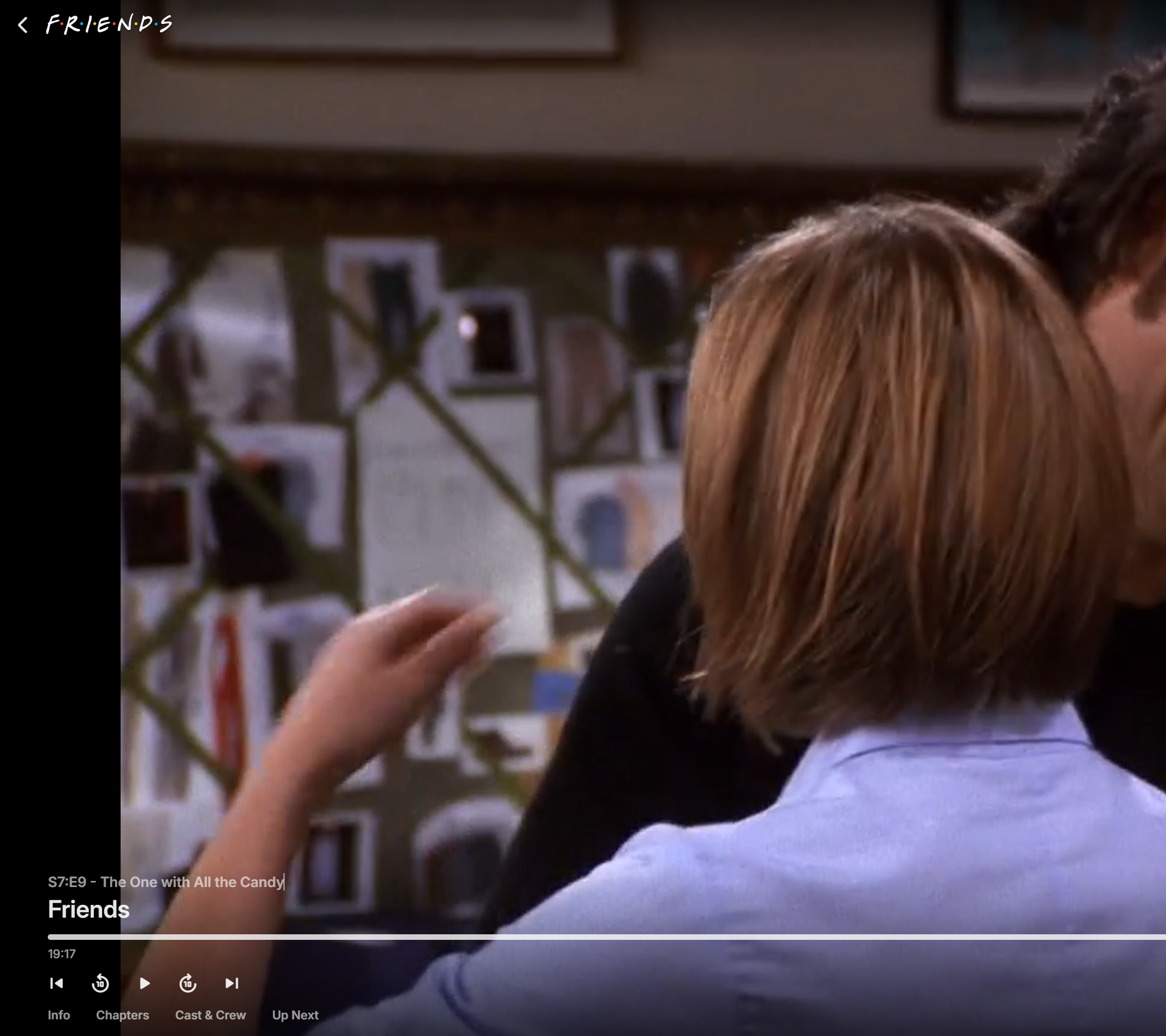

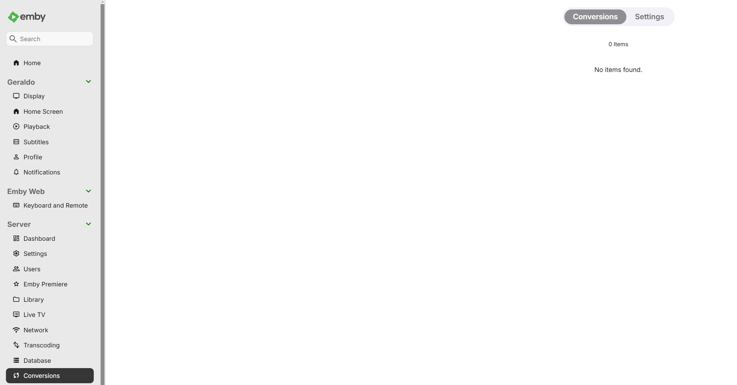

geraldomagella 1 Posted February 5, 2025 Author Posted February 5, 2025 (edited) This is happening with other videos too (not only the friends show). Here are the screenshots you've asked. Doesn't play on EMBY APP - IOS: PLAYS on SAFARY: Plays on PC (WebUI): No conversion jobs: Edited February 5, 2025 by geraldomagella
Lessaj 484 Posted February 5, 2025 Posted February 5, 2025 Your download jobs could have triggered conversions, depending on the settings you used, which won't show up in the conversions tab. What download jobs are on the Downloads tab a few links down under conversions? And if there is more than one, when looking at the job does it mention a quality at the top or does it say original?
geraldomagella 1 Posted February 5, 2025 Author Posted February 5, 2025 There's no download jobs. (BTW: I might have deleted jobs while troubleshooting, but now the problem is that almost no videos are playing).

Solution Luke 42243 Posted February 5, 2025 Solution Posted February 5, 2025 What could be happening is the server is being denied access to delete the files after it is done with them. Since you have no open jobs, you can safely delete all of the current files. Then just see if it happens again in the future.
