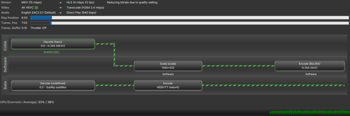

js28194 42 Posted February 5, 2025 Posted February 5, 2025 (edited) Trying to understand what is going on. I stayed on 4.7.xx for a long time due to a transcoding issue and it seems everything was working fine. Now that I have upgraded to 4.18.10 CPU usage has spiked. It used be less than 1%. I just noticed this on a remote user. Feedback an input is welcomed. ffmpeg-transcode-2f3db4d5-961a-45e5-bfe8-84762a1c5056_1.txt Edited February 5, 2025 by js28194
Happy2Play 9814 Posted February 5, 2025 Posted February 5, 2025 First I would question by you have no Hardware encoder for h264 as everything is being done in software? 10:15:17.276 Stream mapping: 10:15:17.276 Stream #0:0 (hevc) -> scale:default (graph 0) 10:15:17.276 scale:default (graph 0) -> Stream #0:0 (libx264) 10:15:17.276 Stream #0:1 -> #0:1 (copy) 10:15:17.276 Stream #0:2 -> #1:0 (subrip (srt) -> webvtt (native)) 10:15:17.276 Stream #0:0 -> #1:1 (copy)
js28194 42 Posted February 5, 2025 Author Posted February 5, 2025 6 minutes ago, Happy2Play said: First I would question by you have no Hardware encoder for h264 as everything is being done in software? 10:15:17.276 Stream mapping: 10:15:17.276 Stream #0:0 (hevc) -> scale:default (graph 0) 10:15:17.276 scale:default (graph 0) -> Stream #0:0 (libx264) 10:15:17.276 Stream #0:1 -> #0:1 (copy) 10:15:17.276 Stream #0:2 -> #1:0 (subrip (srt) -> webvtt (native)) 10:15:17.276 Stream #0:0 -> #1:1 (copy) Hardware hasn't changed, only Emby Upgrade.

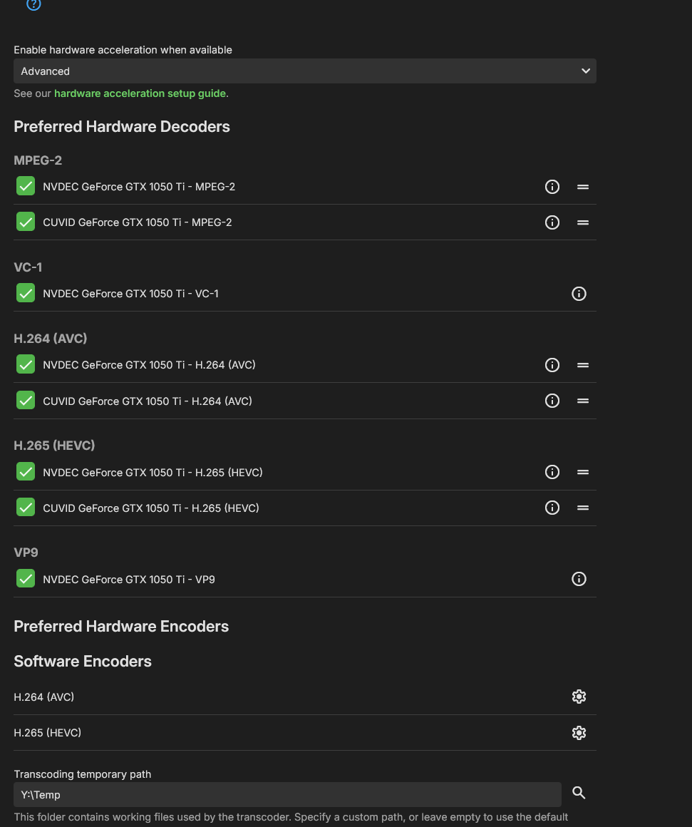

Happy2Play 9814 Posted February 5, 2025 Posted February 5, 2025 Probably need to see a server startup log and hardwaredetection log but your image shows no encoder either so all encoding is done in software/cpu.
Happy2Play 9814 Posted February 5, 2025 Posted February 5, 2025 (edited) Where something is not quite right as you should have at minimum h264 but should have h265 encoders also. Edited February 5, 2025 by Happy2Play

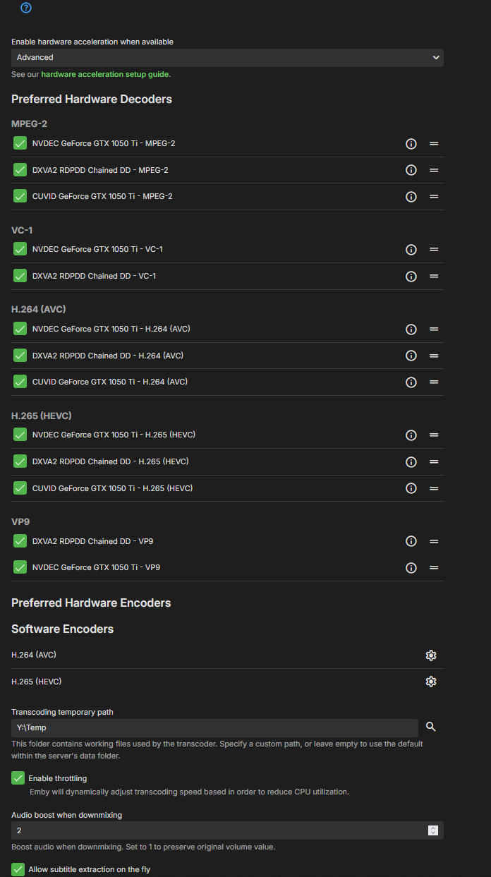

js28194 42 Posted February 5, 2025 Author Posted February 5, 2025 (edited) Also, suddenly some new options showed up out of the blue. Also, enabling throttling doesn't seem to do anything? Edited February 5, 2025 by js28194
Happy2Play 9814 Posted February 5, 2025 Posted February 5, 2025 Yes but you are still not seeing Encoders. Not sure if related as devs would have to elaborate here. 2025-02-05 10:45:53.884 Info Dx11VaCodecProvider: Start GetCodecList() 2025-02-05 10:45:53.884 Error Dx11VaCodecProvider: Error in GetCodecList *** Error Report *** Version: 4.8.10.0 Command line: C:\Users\admin\AppData\Roaming\Emby-Server\system\EmbyServer.dll -noautorunwebapp Operating system: Microsoft Windows 6.1.7601 Service Pack 1 Framework: .NET 6.0.33 OS/Process: x64/x64 Runtime: C:/Users/admin/AppData/Roaming/Emby-Server/system/System.Private.CoreLib.dll Processor count: 8 Data path: C:\Users\admin\AppData\Roaming\Emby-Server\programdata Application path: C:\Users\admin\AppData\Roaming\Emby-Server\system System.EntryPointNotFoundException: System.EntryPointNotFoundException: Unable to find an entry point named 'CreateDXGIFactory2' in DLL 'dxgi.dll'. at SharpDX.DXGI.DXGI.CreateDXGIFactory2(Int32 flags, Guid riid, IntPtr& factoryOut) at SharpDX.DXGI.Factory2..ctor(Boolean debug) at Emby.Codecs.Dxva.Detection.MainDetectorDX11..ctor(ILogger logger, List`1 codecList) at Emby.Codecs.Dxva.Dx11VaCodecProvider.GetCodecListInternal() Source: SharpDX.DXGI TargetSite: Void CreateDXGIFactory2(Int32, System.Guid, IntPtr ByRef) 2025-02-05 10:45:53.884 Info Dx11VaCodecProvider: End GetCodecList() 2025-02-05 10:45:53.884 Info DxvaCodecProvider: Start GetCodecList() 2025-02-05 10:45:54.289 Info DxvaCodecProvider: End GetCodecList() "DetectionOutputs": { "Dx11VaCodecProvider": { "CodecProviderName": "Dx11VaCodecProvider", "StandardError": "System.EntryPointNotFoundException: Unable to find an entry point named 'CreateDXGIFactory2' in DLL 'dxgi.dll'.\r\n at SharpDX.DXGI.DXGI.CreateDXGIFactory2(Int32 flags, Guid riid, IntPtr& factoryOut)\r\n at SharpDX.DXGI.Factory2..ctor(Boolean debug)\r\n at Emby.Codecs.Dxva.Detection.MainDetectorDX11..ctor(ILogger logger, List`1 codecList)\r\n at Emby.Codecs.Dxva.Dx11VaCodecProvider.GetCodecListInternal()", "Result": [ "Detection Log", "Debug: Create DXGI Factory", "Error: Error in GetCodecList\nSystem.EntryPointNotFoundException: Unable to find an entry point named 'CreateDXGIFactory2' in DLL 'dxgi.dll'.\r\n at SharpDX.DXGI.DXGI.CreateDXGIFactory2(Int32 flags, Guid riid, IntPtr& factoryOut)\r\n at SharpDX.DXGI.Factory2..ctor(Boolean debug)\r\n at Emby.Codecs.Dxva.Detection.MainDetectorDX11..ctor(ILogger logger, List`1 codecList)\r\n at Emby.Codecs.Dxva.Dx11VaCodecProvider.GetCodecListInternal()" ]
