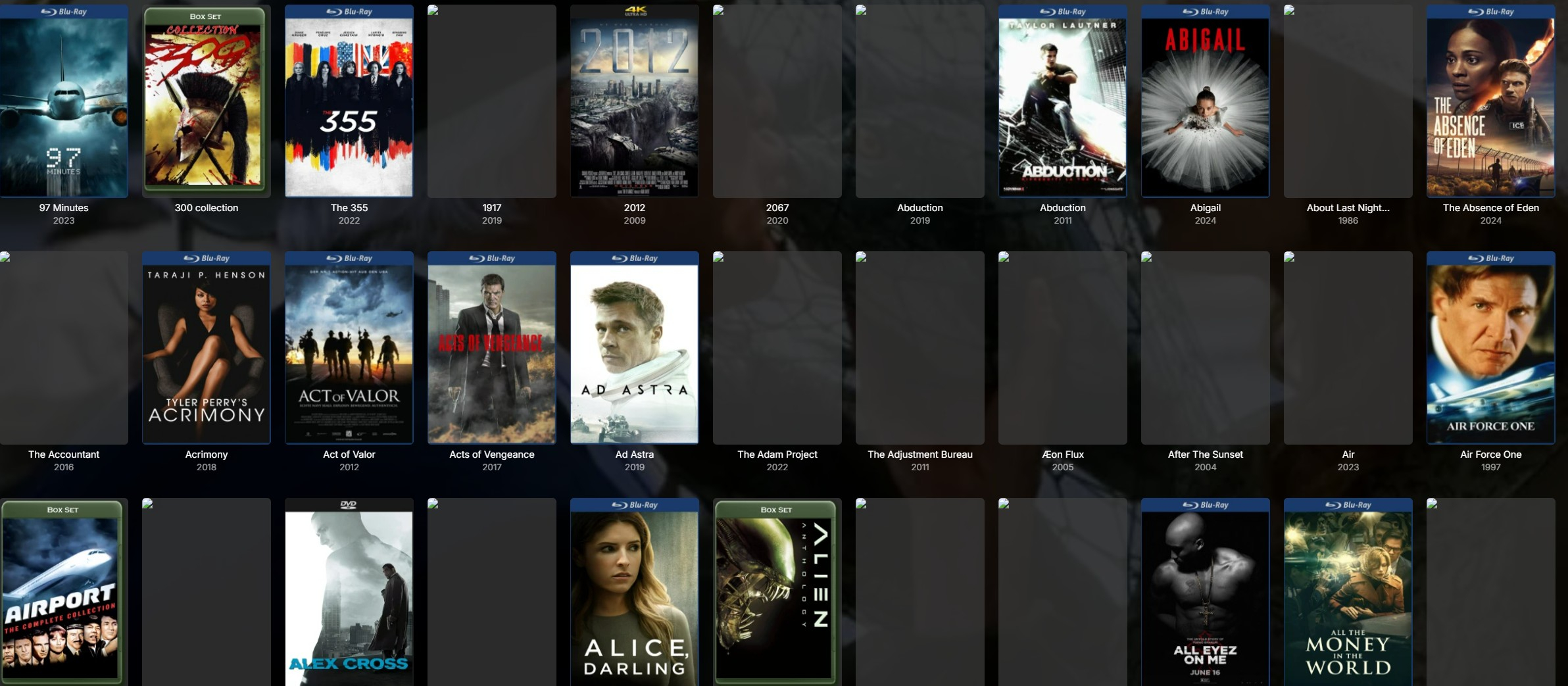

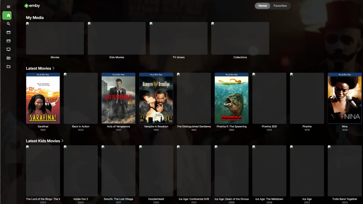

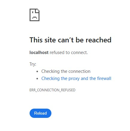

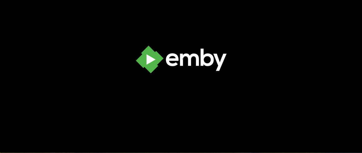

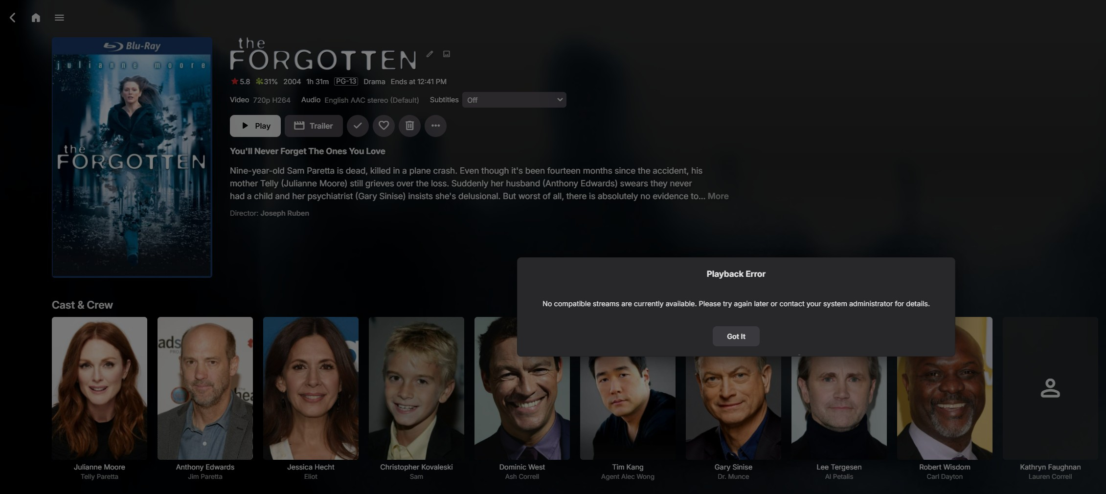

RoyH 12 Posted February 5, 2025 Posted February 5, 2025 I have been using Emby for a very long time but recently I have been getting more and more problems with it, My server is a windows 11 PC that acts as a server nothing else, after I update Google Chrome my Emby server would not load properly and takes more than an hour before it start to work properly, Tonight I noticed I could not log on from my TV and on checking on the server I got this message "This site can't be reached" see attached (1) I restarted the PC and Emby load but only the logo see attached (2), then after refreshing the screen multiple times it shows some of the covers (3) then if I try to play a movie it shows an error (4) and if I keep refreshing the page one by one the features start to work.

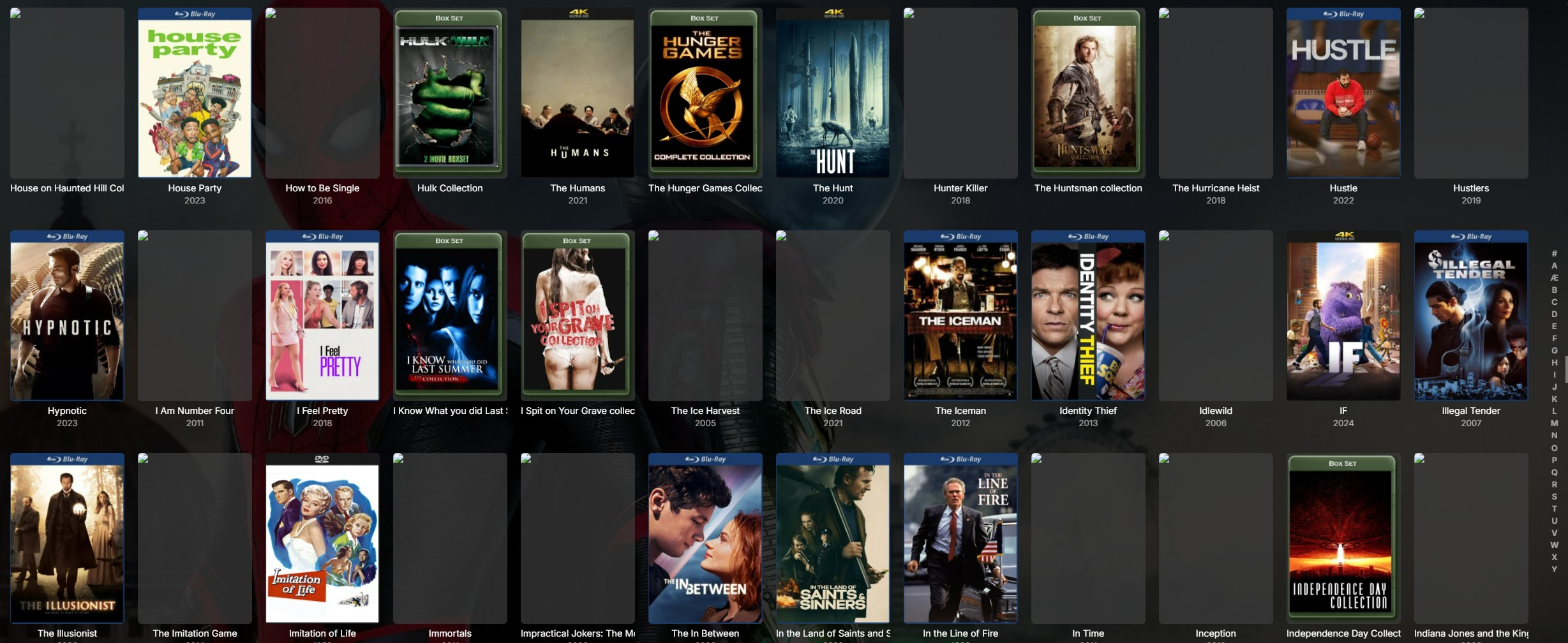

RoyH 12 Posted February 13, 2025 Author Posted February 13, 2025 @LukeHi, it happened again I tried to access Emby from my phone today and couldn't, when I came home and looked at the server it looked like screenshot attached, I refreshed the page and it went to the Emby logo and could access nothing, after like 8 or 9 refresh it finally start to load the metadata. I could not access the logs as nothing loaded at first now I can access it attached are the last two Logs one from 12 and the other when I came home a little while ago. embyserver-63874915200.txt embyserver-63874915200 (from 12).txt

Solution Luke 42178 Posted February 15, 2025 Solution Posted February 15, 2025 OK there's still nothing obvious here, so I would suggest simplifying. Please remove these plugins: CoverArt 4.1.28.0 Xml Metadata 3.5.1.0 Then restart the server and let's see how things compare. Thanks.
RoyH 12 Posted February 15, 2025 Author Posted February 15, 2025 10 hours ago, Luke said: OK there's still nothing obvious here, so I would suggest simplifying. Please remove these plugins: CoverArt 4.1.28.0 Xml Metadata 3.5.1.0 Then restart the server and let's see how things compare. Thanks. Uninstalled the two and restarted Emby initially it started up with some of the images missing like before but they came on about 10 seconds later and everything seems good, restarted it a second time and everything was good right away, Restarted the PC and everything loaded perfectly. Will monitor it for the next few days and see. 1
RoyH 12 Posted March 14, 2025 Author Posted March 14, 2025 On 2/15/2025 at 12:21 AM, Luke said: OK there's still nothing obvious here, so I would suggest simplifying. Please remove these plugins: CoverArt 4.1.28.0 Xml Metadata 3.5.1.0 Then restart the server and let's see how things compare. Thanks. Thanks @Luke I think that did the trick almost a month and everything working fine since I remove the 2 plugins 1
