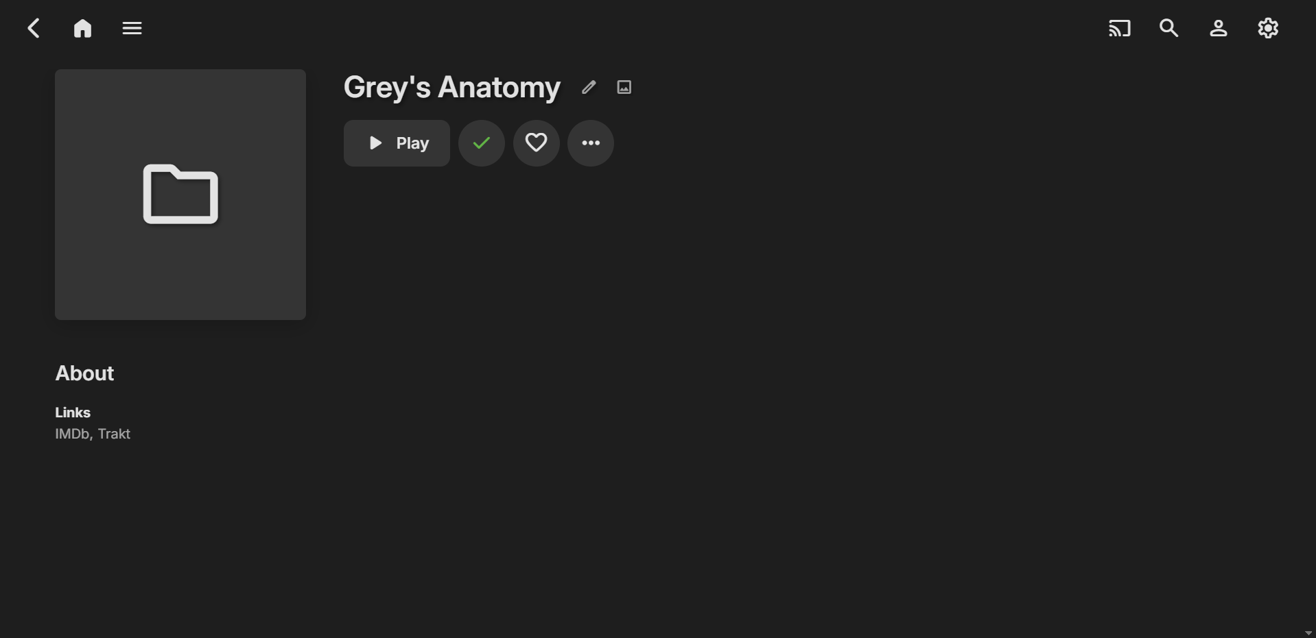

nopenope12345 5 Posted February 3, 2025 Posted February 3, 2025 (edited) Hi, This issue happened about a month ago and I though I had it resolved but today it came back! I am running Emby in docker on UnRAID 7. My version is 4.8.10.0. OK, the issue: Media goes missing from the server. It's not actually missing but seems to not be indexed anymore. It seems to affect items in the next up list more than other items but that might just be coincidence. When this happens you cannot find the tv show or movie except for an empty entry (screenshot attached), which will indicate that the series has been watched even if it has not. I am storing the show details in .nfo files along side the media. The first time it happened I noticed I could use the identify option to properly identify the movie/series and then that would fix the issue but I am not going to do that for 4,000+ movies and around 1800 series. My old folder structure was /Media/movies/Movie Name (Year)/Movie Name.mp4 for movies and /Media/tv/Series Name/Season */Episode.mp4 for tv series and I thought maybe the server was getting confused so I changed it to /Media/movies/Movie Name (Year) [imdbid=123456]/Movie Name.mp4 for movies and /Media/tv/Series Name [imdbid=123456]/Season */Episode.mp4 for tv series. After the first time it happened and I changed the folders to include the imdbid, I rescanned everything and it all worked again! Unfortunately, today the issue is back. I'm at a loss. Nothing has changed with my workflow or apps etc. Please let me know if you need more info and thank you! embyserver.txt embyserver-63874137600.txt embyserver-63874155603.txt Edited February 3, 2025 by nopenope12345 additional info
Lessaj 484 Posted February 3, 2025 Posted February 3, 2025 It looks like you're running into a permission denied error and then it deletes all the entries related to it. There's a bunch of errors for some library items not being found, then it mentions refreshing all the folders, then there's permission denied errors, then it mentions removing things from the library.
Luke 42243 Posted February 3, 2025 Posted February 3, 2025 HI, yes it looks like the server is being denied access to read the contents of your folders. I would start by resolving that and then everything should fall into place.
nopenope12345 5 Posted February 3, 2025 Author Posted February 3, 2025 OK, you guys are correct about there being some permission issues. That is a newer issue that I can easily resolve and it looks like it was affecting movies. It still does not explain why some of the tv shows have "disappeared". Right now one show that is missing (The Americans) is all 777 permissions and it still got de-indexed.
Lessaj 484 Posted February 3, 2025 Posted February 3, 2025 It looks like that one also had a permission denied error. Only looked at one log. 2025-02-03 05:15:53.037 Error App: Error in GetFileSystemEntries for /data/tvshows/The Americans (2013) [imdbid=tt2149175] System.UnauthorizedAccessException: System.UnauthorizedAccessException: Access to the path '/data/tvshows/The Americans (2013) [imdbid=tt2149175]/Season 1' is denied. 2025-02-03 05:15:53.689 Error App: Error resolving path /data/tvshows/The Americans (2013) [imdbid=tt2149175] System.UnauthorizedAccessException: System.UnauthorizedAccessException: Access to the path '/data/tvshows/The Americans (2013) [imdbid=tt2149175]/Season 1' is denied. 2025-02-03 05:20:35.741 Info LibraryMonitor: The Americans (2013) (/data/tvshows/The Americans (2013) [imdbid=tt2149175]) will be refreshed. 2025-02-03 05:20:35.741 Info LibraryMonitor: Season 1 (/data/tvshows/The Americans (2013) [imdbid=tt2149175]/Season 1) will be refreshed. 2025-02-03 05:20:35.741 Info LibraryMonitor: Season 5 (/data/tvshows/The Americans (2013) [imdbid=tt2149175]/Season 5) will be refreshed. 2025-02-03 05:20:35.741 Info LibraryMonitor: Season 2 (/data/tvshows/The Americans (2013) [imdbid=tt2149175]/Season 2) will be refreshed. 2025-02-03 05:20:35.741 Info LibraryMonitor: Season 3 (/data/tvshows/The Americans (2013) [imdbid=tt2149175]/Season 3) will be refreshed. 2025-02-03 05:20:35.741 Info LibraryMonitor: Season 4 (/data/tvshows/The Americans (2013) [imdbid=tt2149175]/Season 4) will be refreshed. 2025-02-03 05:20:35.741 Info LibraryMonitor: Season 6 (/data/tvshows/The Americans (2013) [imdbid=tt2149175]/Season 6) will be refreshed. 2025-02-03 05:30:36.564 Info App: Removing item from database, Type: Series, Name: The Americans (2013), Path: /data/tvshows/The Americans (2013) [imdbid=tt2149175], Id: 4574258 The fact that it's even trying to refresh all the folders at the same time, do you have some other software that is crawling the FS?
