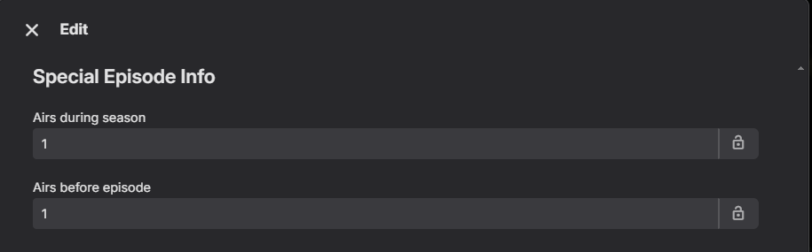

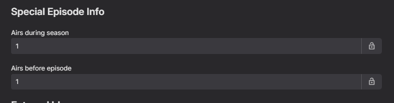

GrimReaper
That behavior is driven by special episode metadata - if you don't want it played before/during/after any season, on special episode: Edit Metadata>clear "Airs during season" and/or "Airs before episode"

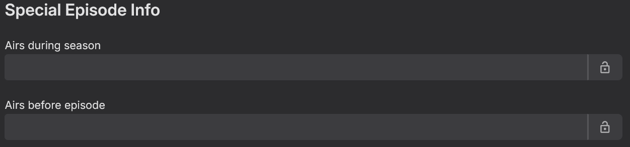

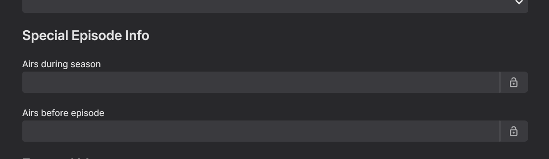

rcsnoopdog
10 minutes ago, RanmaCanada said:
You first need to make sure the specials are named properly, and then if they are you need to check when they are told to play in regards to season position. It's possible you have them merged together, which if you do, you will want to split them apart, and then rename them properly.
the special in question is named \The All-New Popeye Hour\Specials\The All-New Popeye Hour - S00E02 - Popeye Rhapsody by Ilan Rechtman..mkv
and the airs during season and airs before episode are blank just like above

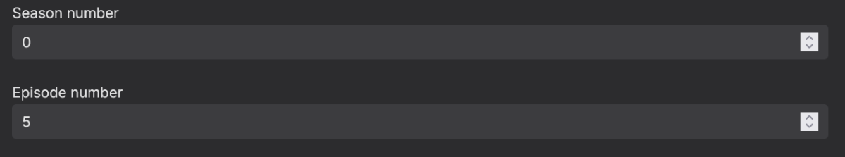

I should make a guide.... It's kind of easy.  You can set your specials to play in season as they were released, before, or after the season.
1.  Log in as administrator.
2. Go to the episode in question.
3. Go to the pen icon beside the episode name.  Click to open meta data.
4.  Edit Season Number and episode number.  Season 0 is the Specials season.  You can assign an episode if it wasn't named with one.
5.  Set if you want it to play during a season (Christmas Special etc.)  or not, like this one.  If you are changing these fields, make sure you click the lock icon to lock the field so it doesn't change if you rescan or update.  If it plays before the season its because you want to navigate to season 1 episode 1 to start playing the regular seasons.
Being Season 0 it comes before season 1 so it plays first.

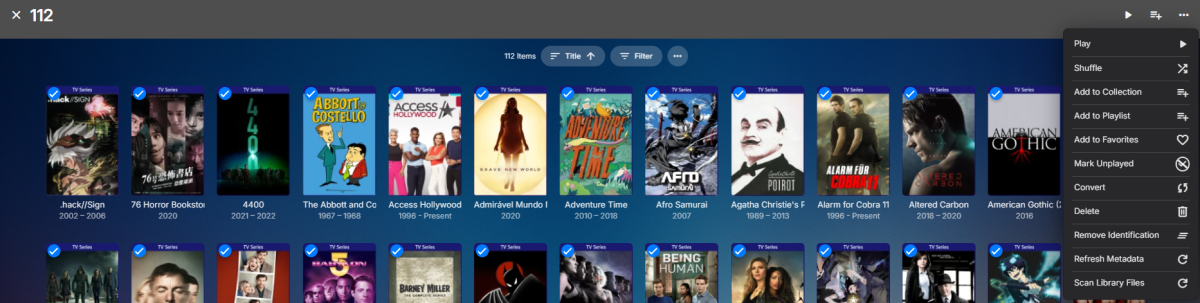

Does anyone know how to mark all tv shows played and then unplayed together all at once ?
Happy2Play
It is a pain now as you can use multi-select on the library to mark all as played but have to multi-select every item in a library to mark as unplayed.
But the recommended way would be learn to use the api and reset them that way from library id.  Will post the api call in a few minutes.

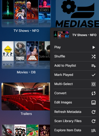

If you are at your main screen in the web interface you can click on the three dot menu of a library and select either "mark played" or "mark unplayed." Be careful using that and allow some time for it to complete as, if you have a fairly large library, it can take a fairly long time to complete. The last time i marked and entire TV library unwatched it took almost half an hour to finish. I usually do it on shows or a group of shows using multi-select. My libraries are rather large, I have a bit less than 1000 shows or 44,000 episodes so I do not really do much management at the library level.
  • Solution

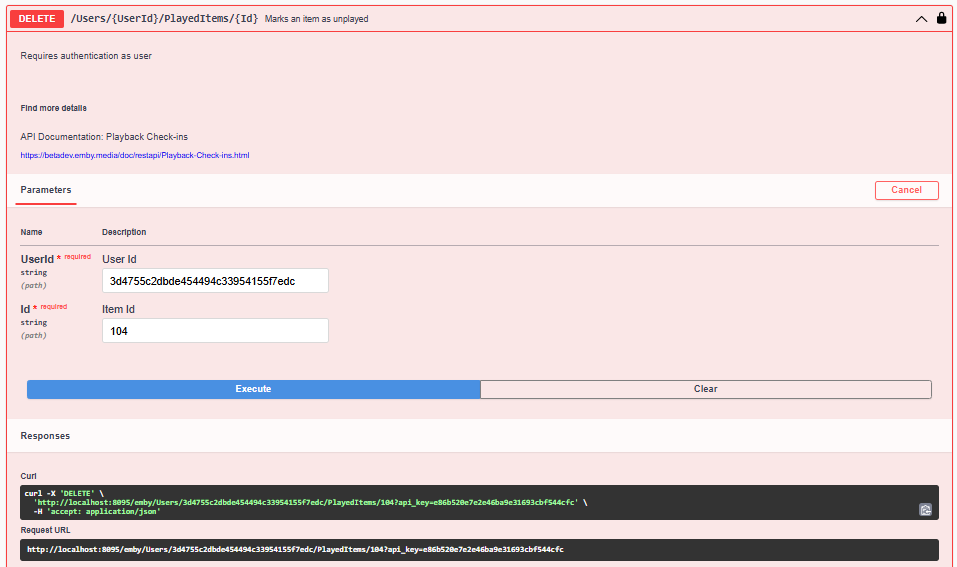

Happy2Play
Just need the library/parentid.
This marked the library as played
and this mark the library as unplayed.
Happy2Play
From the UI you have context or multi-select to mark as played but not unplayed.
for Unplayed everything has to be marked as played then enter library and multi-select to get unplayed option as it only appears if everything is played.  As it will not show the option at library level anymore.
