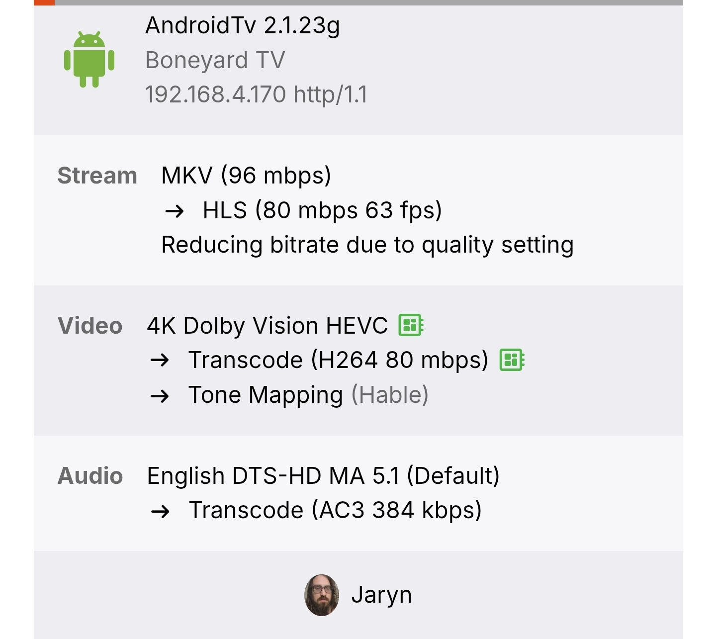

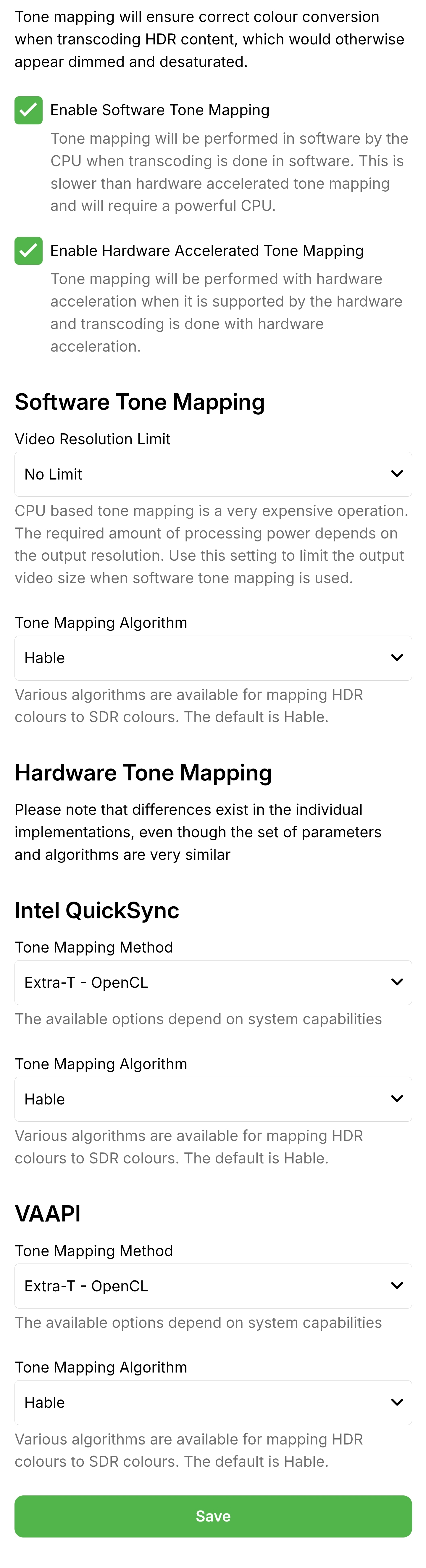

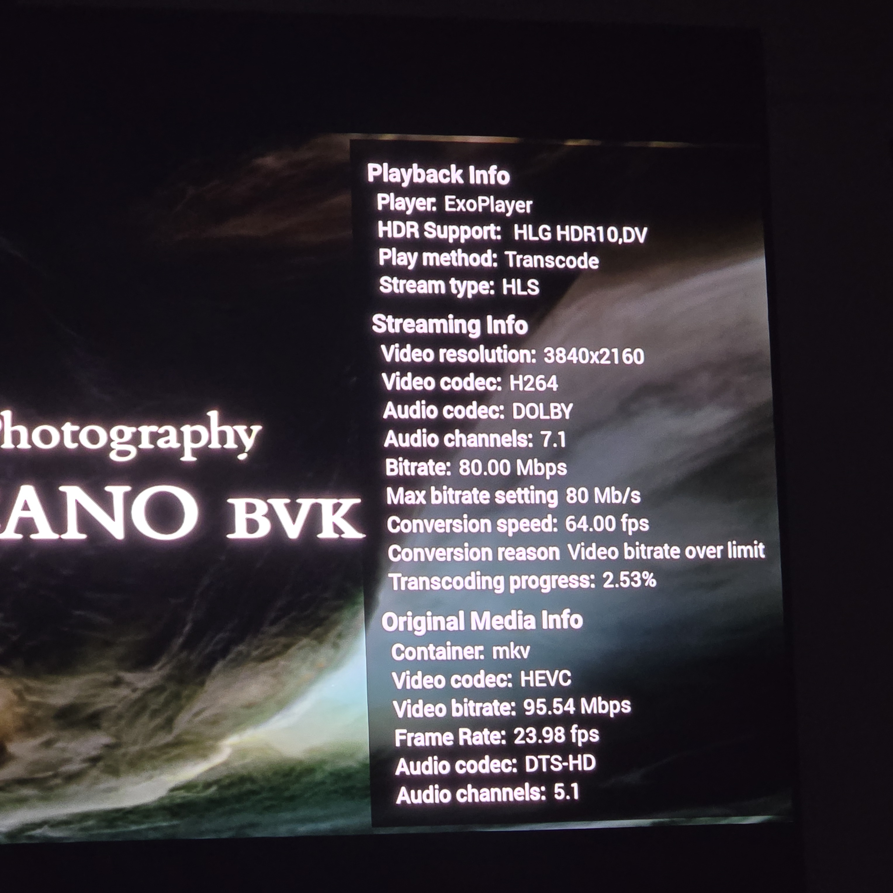

jahagafut 5 Posted February 3, 2025 Posted February 3, 2025 So after a week of troubleshooting stuttering caused by a poor WiFi 7 router, I can try to troubleshoot my next biggest problem/confusion? With both directplay and transcoding, none of my TVs recognise HDR or DV, normally my Bravia will tell you what mode you're in if you go to picture settings so that you can fine tune, but neither it nor my Samsung s90c try to play in HDR or DV mode. I've attached what I hope is helpful logs and screenshots ffmpeg-transcode-5b1ce5e5-8aa9-4b3d-a94e-2c27a574359d_1.txt
Lessaj 484 Posted February 3, 2025 Posted February 3, 2025 Looks like your max bitrate is set to 80 but that source content is 96, so first try setting your bitrate to the max possible and see if it will direct play.

jahagafut 5 Posted February 3, 2025 Author Posted February 3, 2025 23 minutes ago, Lessaj said: Looks like your max bitrate is set to 80 but that source content is 96, so first try setting your bitrate to the max possible and see if it will direct play. It seems to insist on defaulting to 80, I'll try this out when I get a chance, I think last time I tried it eventually stopped due to too many errors
