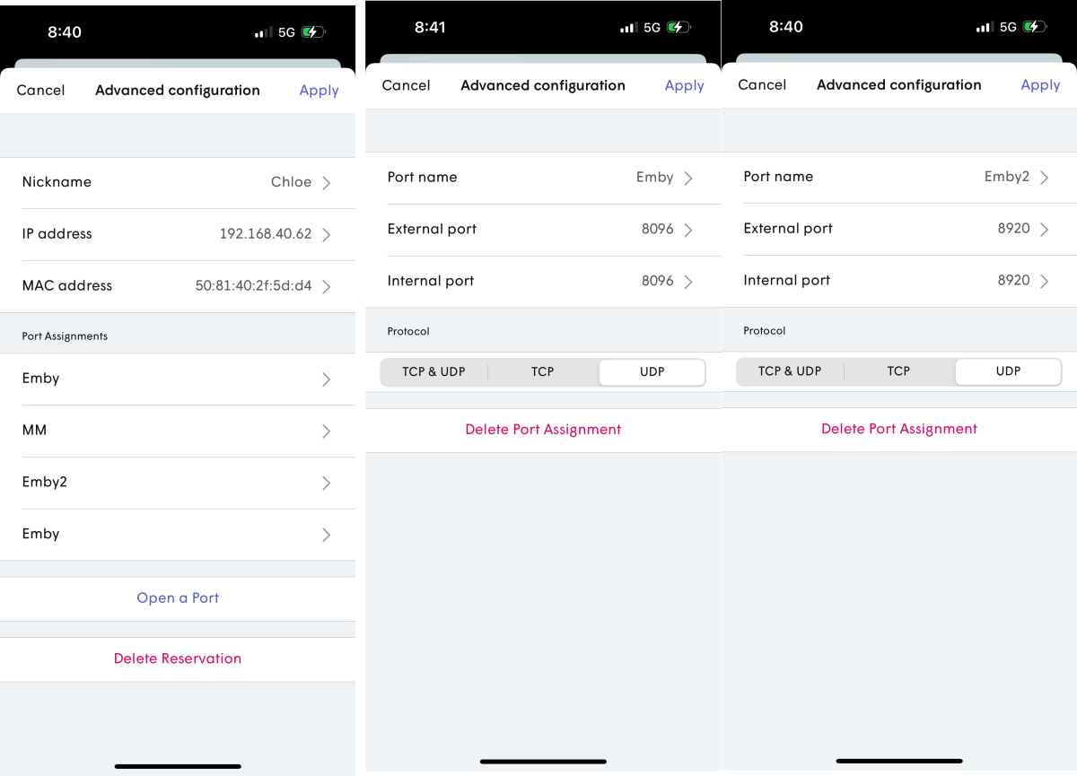

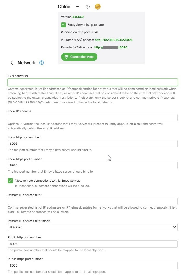

hemsimmons 0 Posted February 3, 2025 Posted February 3, 2025 (edited) Several days ago, evidently, my family lost access to my server using the external access. I have checked absolute everything I know to check and it all seems (still) setup correction. Allow remote access is still checked on the server and for the users My router still has pass-through enabled for the IP address & port shown in the server settings. What else is there to check? I've tested it myself from my phone and Emby Connect and neither will work. I can only get to the server on my internal network. I am clueless where to go from here --- if it doesn't work according to the standard instructions -- or just all of a sudden quits --- I have no idea what to do. My family will be devastated if I can't get this resolved Attached are print screens of the server setup and the router settings. Thank you for any help. Edited February 3, 2025 by GrimReaper WAN IP masked

Neminem 1591 Posted February 3, 2025 Posted February 3, 2025 From you router screenshots it looks like port are set to UDP. I think is must be TCP.
hemsimmons 0 Posted February 3, 2025 Author Posted February 3, 2025 It times out and states that "we're unable to connect to the selected server right now"... It was originally TCP. I was trying everything to get it to work. It won't connect whether it's TCP, UDP, or TCP & UDP.
