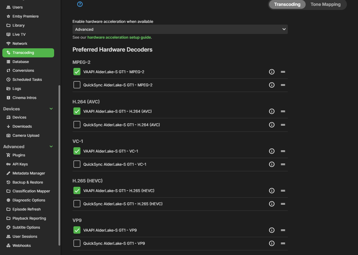

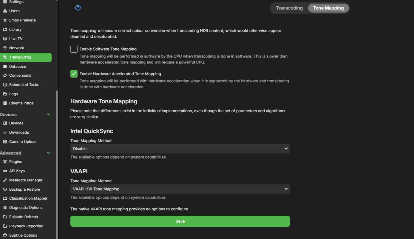

Neminem 1623 Posted February 2, 2025 Posted February 2, 2025 Try using vaapi for everything regarding transcoding, that's how I tamed that beast. By the way, have you upgraded to unRaid 7 ?
