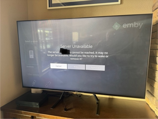

ChuckGB 0 Posted February 2, 2025 Author Posted February 2, 2025 Edit to previous - It's now finally able to see the server, through Emby connect, but now it says that The server is unavailable and cannot be reached (gives options of Cancel/Wake/Remove). Similar to previous, no issues connecting on other devices.

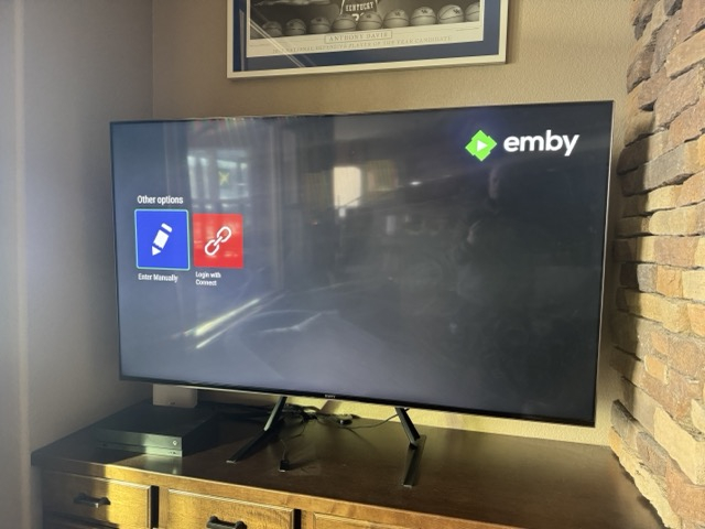

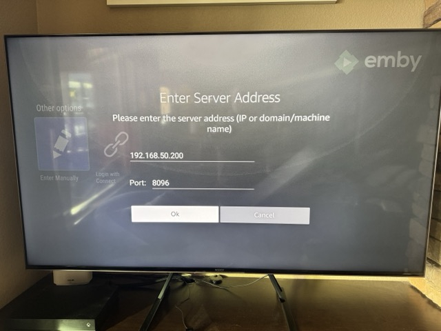

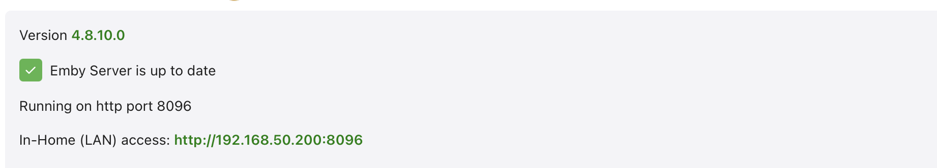

ChuckGB 0 Posted February 2, 2025 Author Posted February 2, 2025 1 hour ago, ebr said: Hi. Why are you using Connect on your internal network? The fact that the server isn't presented automatically as a login option in the app indicates a network discovery issue. Something is blocking access on the device. Any VPN or proxy? Mornin! I only used Connect because I kinda had to. When I entered in the server address manually, it gives me an error message. or did nothing at all. No VPN running on my router, no proxy. So here's my dashboard info: Which Leads to this on my TV: And after hitting OK, it just sends me back to this screen and 15-20 minutes later, it says Error connecting. Not sure if it's a configuration issue on the server (which is confusing to me, as every other device is seeing it without problem) or an issue with the app itself. Ive also tried deleting and reinstalling the app for good measure.

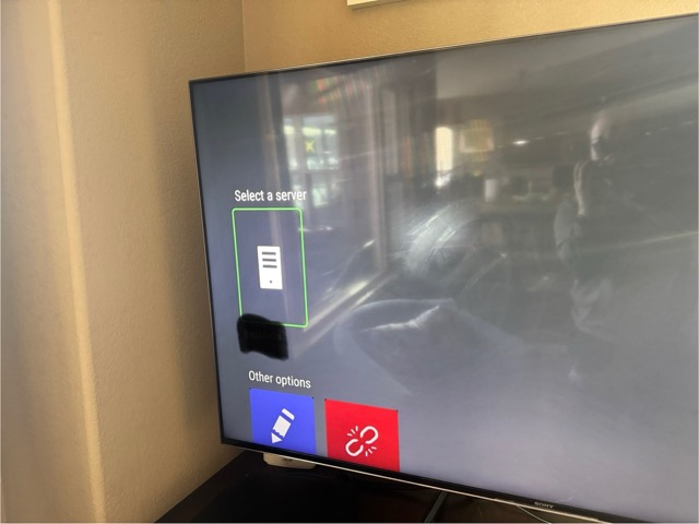

ChuckGB 0 Posted February 2, 2025 Author Posted February 2, 2025 As for using connect, When I do the PIN thing, it at least gets me to here, where the server is at least showing up: Try to select that server and I get this: Wake doesn't do anything and removing to start the process over again similarly isn't working. Th only way I can get to these screens is using Emby Connect (which I've never had to do on any of my other devices)
