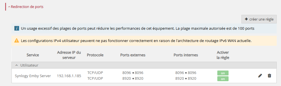

MatthieuBUARD 0 Posted February 9, 2025 Author Posted February 9, 2025 @LukeYes I setted up port forwarding on my "SFR Box" router configuration on my DHCP parameters, to be honest "i hope so" because I'm not a techno guy at all. I identified "internal IP" with the 8096 / 8290 port. I also checked that "my user" is allowed to connect from outside home... I'm blocked on my "techno skills" and I fear to scratch something on my router configuration that will "break" my network access... Any easy idea to try in order to finalize the outside Emby access? Other element on my configuration : - Server : Synology: DS220+ - Firmware version : DSM 7.2.2-72806 Update 3 Thanks for your support... Matthieu

Luke 42240 Posted February 14, 2025 Posted February 14, 2025 On 2/9/2025 at 11:18 AM, MatthieuBUARD said: @LukeYes I setted up port forwarding on my "SFR Box" router configuration on my DHCP parameters, to be honest "i hope so" because I'm not a techno guy at all. I identified "internal IP" with the 8096 / 8290 port. I also checked that "my user" is allowed to connect from outside home... I'm blocked on my "techno skills" and I fear to scratch something on my router configuration that will "break" my network access... Any easy idea to try in order to finalize the outside Emby access? Other element on my configuration : - Server : Synology: DS220+ - Firmware version : DSM 7.2.2-72806 Update 3 Thanks for your support... Matthieu @MatthieuBUARDcan you show screenshots of your port forwarding setup? And can you answer the questions from Carlo and Jator? Thanks !
MatthieuBUARD 0 Posted February 14, 2025 Author Posted February 14, 2025 Hello all, 1st thanks for your investment in the resolution of my Emby access issue. To answer to @Carlo : - yes : canyouseeme.org portal shows me the external IP that I can find on my Emby dashboard parameter on External access "WAN" IP but when I test 8096 port indicated on the Emby dashboard, canyouseeme.org reverse me that message : "ERROR i could not see the 37.65.XXX.90 on 8096 port" - But I don't find the External IP in my router parameter portal / the only external IP I find is completely different from the one I find on Emby Dashboard parameter and on the one automaticaly found by "canyouseeme.org". My router portal gives me the external IP address : 10.XXX.XX.90 Adding on that, the router portal precises that the IPv4 config could not work due to actual IPv6 WAN config... to be honest I don't understand anything Ending, I don't know how to tracert the IP address and to identified if it take a long time. I really not on developer guy... If you have a step by step process that I could follow easily It would help me. To answer to @Jator : i have a very simple installation. The DS220+ is directly connected to SFR Fiber modem. And I don't think that into the box/modem there is the a secondary router behind the main internet access. @Luke Don't know if it could help.
Carlo 4561 Posted February 15, 2025 Posted February 15, 2025 Assuming you have a windows machine on the same network as your NAS, click on start and type CMD and then hit enter. You can also do WIN-R then type cmd and hit enter. This will open a box and you'll have a command prompt. type: tracert 8.8.8.8 then do the same thing after it finishes changing the 8.8.8.8 to the IP external IP shown on the Emby Dashboard. Open a browser to https://www.checkmynat.com/. Click the Check NAT button and a couple seconds later you'll see a couple lines above the button get updated. Copy these two line as well as the results from the two trace routes commands you ran and post then in a reply here. Or PM me the results of these tests if you don't want to post this info in the public forum. I'm not liking the "10.XXX.XX.90" address you see as it's not a publicly routable IP address, but a reserved private IP. The information from these tests will help determine if you are behind a CG-NAT.

Tandhruil 27 Posted February 18, 2025 Posted February 18, 2025 (edited) Hi, I see you try to forward IPV4 LAN on an IPV6 WAN I think you can find help here : Edited February 18, 2025 by Tandhruil
