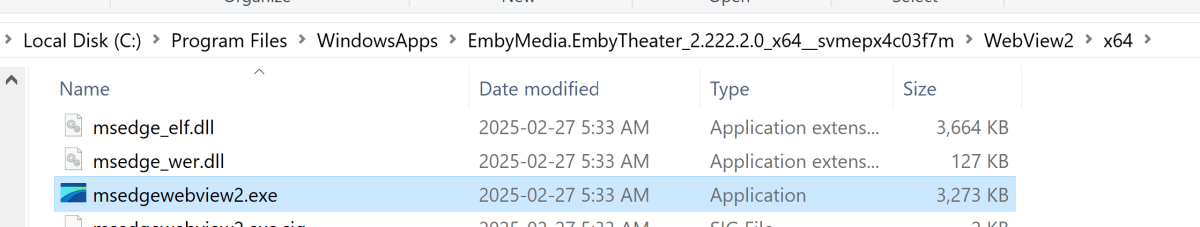

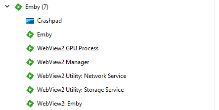

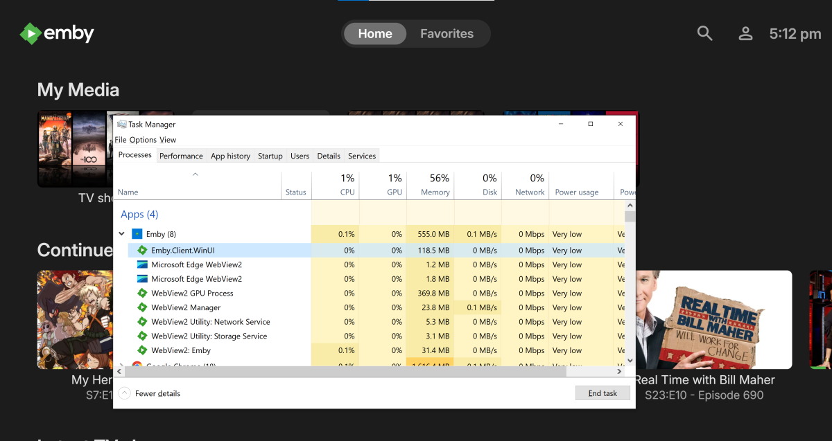

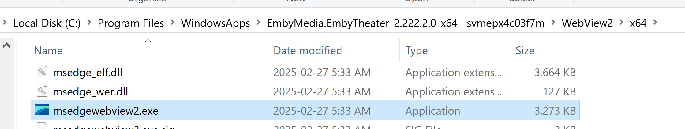

softworkz 5133 Posted April 27, 2025 Posted April 27, 2025 That's interesting. The process tree looks quite different here: It could be due to Windows 10 (your on 10, right?) How does it look like when it doesn't hang? And when it hang, can you please right-click "Microsoft Edge WebView2" (the one without the green icon), then Properties and check the file location. Thanks!
frankmb 41 Posted April 27, 2025 Posted April 27, 2025 I am on Windows 10 yeah. When it does not hang it looks like this. There is a 2nd Edge When it does not hang the location is I will report what is the location is when it hangs the next time it hangs. 1
frankmb 41 Posted April 28, 2025 Posted April 28, 2025 I tested a bit more. Normally there is only one "Microsoft Edge WebView2" when Emby launches successfully. However if Emby hangs on launch then is shut down, the next time Emby is launched there are 2 "Microsoft Edge WebView2" in the task manager.
softworkz 5133 Posted April 28, 2025 Posted April 28, 2025 Thanks a lot for testing. The number of processes is not that important, it's the same like chrome.exe or msedge.exe, there are often multiple processes due to sandboxign and separation of rendering and management code. It was only the non-Emby icon which caught my attentiion and I thought this might be the system-webview2 instead of the webview2 runtime included with Emby. Yet it seems that the difference is only the icon, which might be due to platform differences (10 vs. 11). So, unfortunately, we're back to start. Can you enable debug logging and post/send the log file when it hangs again? Thanks!
