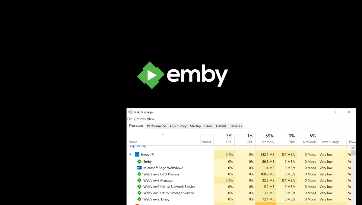

davidb7170 26 Posted February 1, 2025 Posted February 1, 2025 I am on Windows 11 23H2, using the Windows App, current version 2.211.2.0. I've had a sporadic failure on start where instead of initializing to the home page, it opens up to the Emby Logo, an "emby" on an otherwise black page (see attached Emby Startup Fail.jpg). The opening animated sequence happens, then, the static window is displayed and no way to move on. If i close the window, it plays the closing animation and exits. Once it does this, it will open that same way. A system reboot does not clear the behavior. The only thing that will restore it to normal operation is to uninstall the app, re-download from the Microsoft Store and re-install. Then it works until it doesn't - sometimes weeks or days. Tonight I uninstalled, re-installed and it worked. I then reopened a few minutes later it and it again failed as described. I see from the change log, there have been multiple revisions since the first 2.xxx.x.x was released, so do I don't specifically know how many revisions I've been through since this has become an issue. I don't recall the prior version having any issues with failing to open properly or crashing. I have on seen this behavior since the new 2.xxx.x.x version. I thought it might need to be run as administrator, but that didn't work (see attached Emby Admin Fail.jpg), so don't have a good path forward at this point. I have not seen this issue in the forum here, unless my search terms were incorrect... Please advise. Thanks, Dave

Solution davidb7170 26 Posted February 2, 2025 Author Solution Posted February 2, 2025 10 hours ago, pwhodges said: I removed the A380 from my desktop and reverted to the onboard (Intel) video. The new Emby client now works perfectly. Later I'll try reverting to an older driver, but I have things to do before that. Paul Paul - your comments struck a note with me. You also noted Hand Brake acting oddly. I had the same issue after the most recent Intel GPU update. HB failed to render, and I had to deal with that, I was able to fix that by running HB as an Admin. As I mentioned, I have an Intel A770 16GB GPU in my Emby server PC, and an A380 6GB GPU in my secondary PC, and an integrated graphics with the NUC. The NUC hasn't had a graphics update for a long while, and the Emby App is working fine on that unit. The update ran on my Intel A series GPU's was: Intel® Graphics Driver 32.0.101.6557/32.0.101.6262 for Intel® Arc™ B-Series Graphics, Intel® Arc™ A-Series Graphics, Intel® Iris® Xe Graphics, and Intel® Core™ Ultra Processors with Intel® Arc™ Graphics. Version: 32.0.101.6557, Release date: January 29, 2025, Size: 1443.86 MB Prior to the last 2 updates, the were always WHQL Certified, the last 2 were not. So as an experiment, I grabbed the most recent WHQL update: Intel® Graphics Driver 32.0.101.6458/32.0.101.6257 (WHQL Certified) for Intel® Arc™ B-Series Graphics, Intel® Arc™ A-Series Graphics, Intel® Iris® Xe Graphics, and Intel® Core™ Ultra Processors with Intel® Arc™ Graphics. Version: 32.0.101.6458, Release date: January 16, 2025, Size: 1455.15 MB After the install of the WHQL version, the Emby App operates properly, I've checked multiple openings of the app. Also, I no longer need to run Hand Brake as Admin. Going forward, I'm going to look closer at the update notifications, and only update when they are WHQL Certified... Dave 1 1
davidb7170 26 Posted March 9, 2025 Author Posted March 9, 2025 Just closing the loop on this for the problem I had with my system: I had reported issues with the new Windows Emby Theatre App not starting up properly, and also Handbrake having to be operated as Admin for it to work - was a result of Intel Arc GPU driver updates interacting with the Window Emby App and Handbrake. I had found the WHQL driver worked properly when later non-WHQL drivers did not. Thought it was a WHQL versus non-WHQL driver issue. It was not. A later WHQL rated driver also had the same issues, so I rolled back to the one that worked for me. I just tried the latest version 32.0.101.6647 (WHQL Certified) Release date: March 7, 2025 and both issues were cleared properly for my system. Now, I know there's a lot of moving parts in these kind of issues on the App side versus driver sides and such, but at least for now, things are operating as they should. I'm hoping pwhodges found a solution for his issue... Dave 1
pwhodges 2033 Posted March 9, 2025 Posted March 9, 2025 I had been running with the mobo video disabled, and my monitor connected to the Arc 380. In this configuration the new Emby client gave this problem. What I have done now is re-enable the mobo video (Intel UHD 770) and connect the monitor to that. The Emby client works with this just fine. I tried first with the Arc 380 removed, but when I put it back in, with no monitor attached, Emby still worked with the UHD 770, and Handbrake was able to use the Arc 380 to encode AV1. For some reason this combination caused some programs (Handbrake and MPC) to open very slowly - 60 seconds wait for Handbrake - but this was much improved with the latest driver from the end of Feb; I worked around that by getting into the habit of leaving Handbrake minimised instead of shutting it down. I see there is another driver from 2 days ago, so I'll give that a whirl shortly. Paul

Greg1977 0 Posted April 17, 2025 Posted April 17, 2025 (edited) Im having the same problem with the new windows Emby theater app. Every 3rd or 4th time the computer comes out of sleep and I try to start Emby I get the black screen with the Emby logo. I have to go to task manager and end process to get it to open, sometimes I have to do it twice. I do notice task managers show Emby running 8 processes before I end them. I never had an issue with the old non windows app. Please fix this its sounding like a known issue. Edited April 17, 2025 by Greg1977

softworkz 5133 Posted April 26, 2025 Posted April 26, 2025 Let's try to get this sorted a bit. First of all: @kjsanders86you do not have the same issue! This is about the Windows app and even when you see the same symptoms with the Android app, it's still not the "same issue". Please post in the Android forum @nicko84 - @frankmb - you are saying it happens randomly? When it happens, does a running process (Emby.Client.xxxx.exe) already exist? (even when invisible) Are you using the Download/Sync feature? @Greg1977You say it happens when resuming from sleep and you see existing Emby.Client processes. Were those processes already running when entering sleep mode? And was the Emby app visibly running when entering sleep? Are you using the Download/Sync feature? Thanks

frankmb 41 Posted April 27, 2025 Posted April 27, 2025 Emby Windows app is stuck during loading just now: Alt-tab then right-click the Emby icon on the task bar -> Close window shuts down Emby. I saw the shut down animation with horizontal lines meeting in the center
