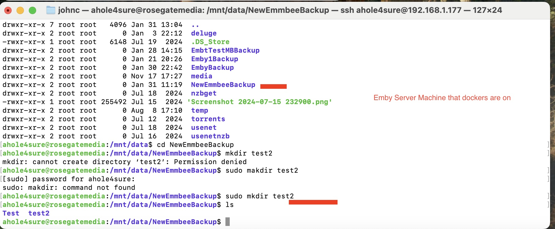

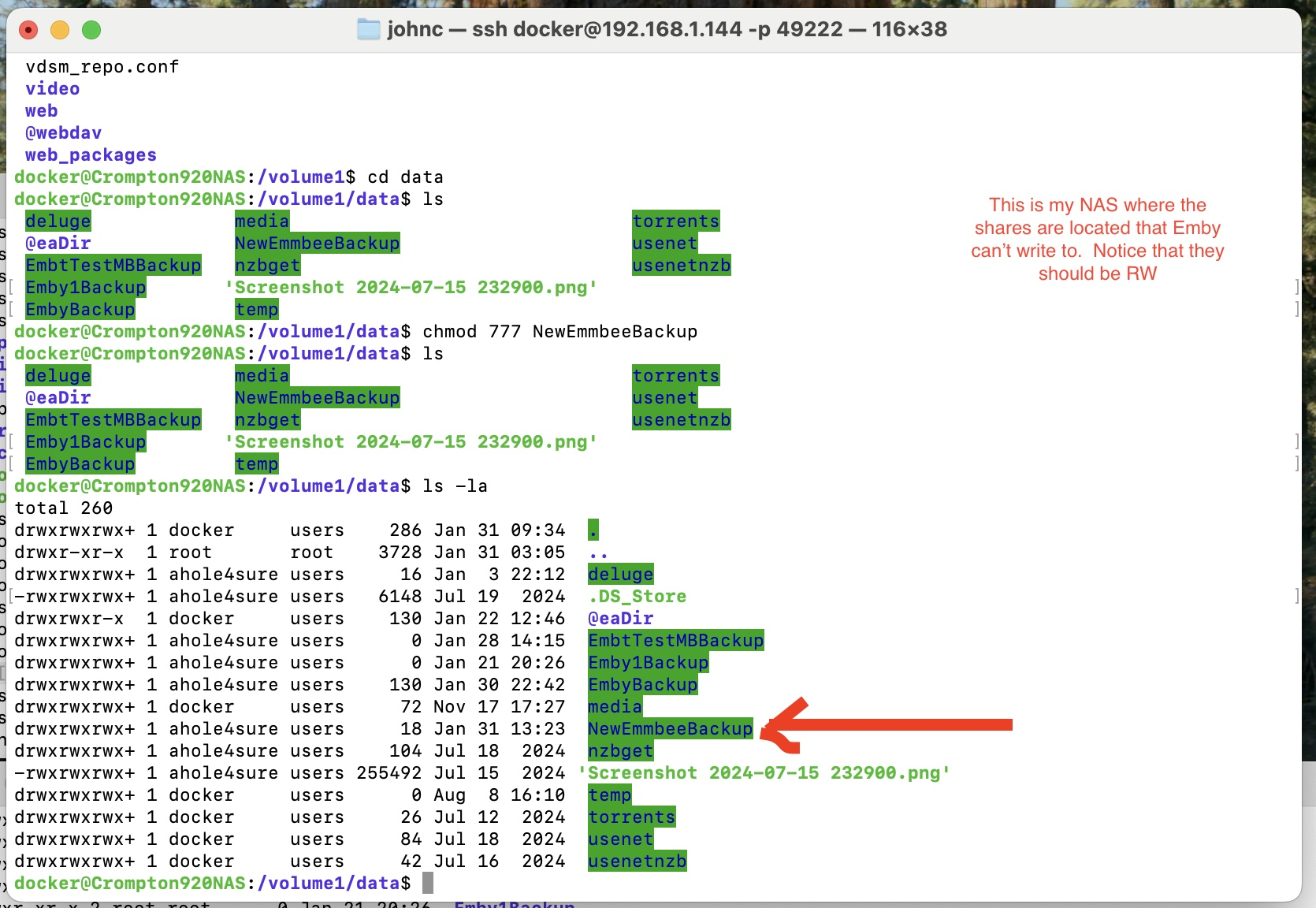

Ahole 17 Posted January 31, 2025 Posted January 31, 2025 I have Emby server running as a Docker on Ubuntu server (using Portainer stacks to create): It is created with the following compose: --- services: emby: image: emby/embyserver:beta container_name: emby environment: - PUID=1000 - PGID=1000 - TZ=America/New_York network_mode: bridge volumes: - /DATA/AppData/EmbyConfig:/config - /mnt/192.168.1.144/CromBackup:/crombackup - /mnt/data:/data - /mnt/data/media/movies:/movies - /mnt/data/media/tv:/tvshows - /mnt/channels-dvr:/channels-dvr - /mnt/data/NewEmmBeeBackup:/backup ports: - 8096:8096 - 8922:8920 #optional devices: - /dev/dri:/dev/dri #optional restart: unless-stopped I can access media in Emby. I have rw access when logged into my server machine and accessing the /mnt share that the Emby Backup would be writtent to (NewEmmBeeBackup folder) I was able to write or create a Test2 folder from that log But for some resason Emby cannot complete or write a backup to that shared folder on my NAS --- and it seems to be riddled with some other permission errors as well. Can a Linus saavy person please help embyserver (2).txt

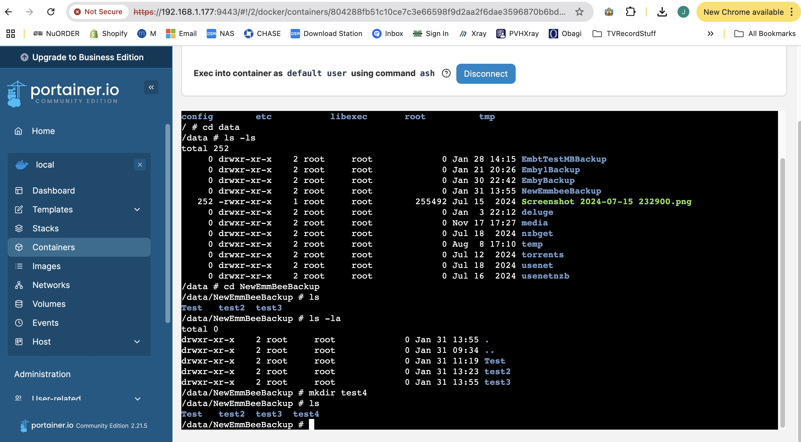

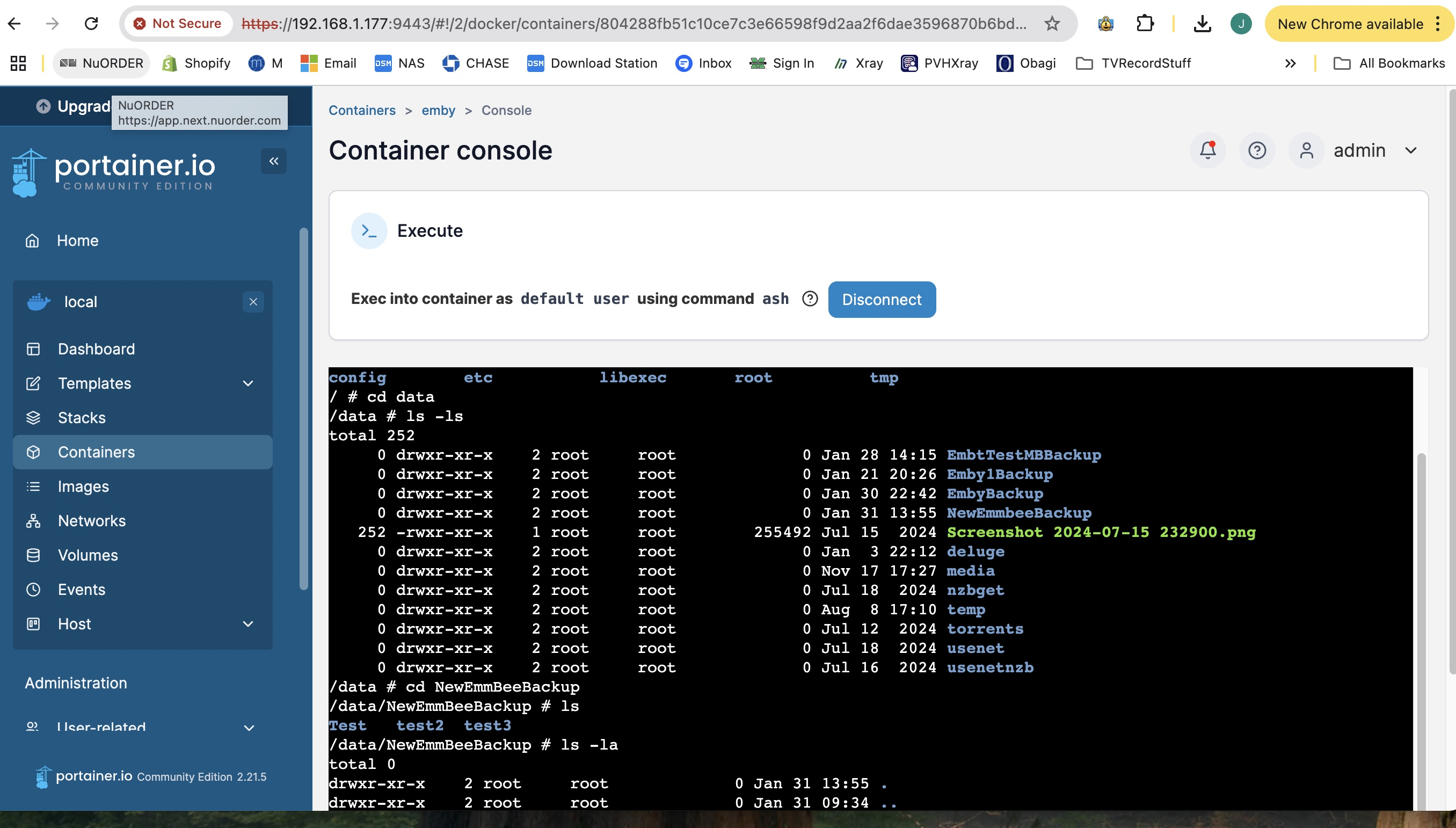

Ahole 17 Posted January 31, 2025 Author Posted January 31, 2025 @Luke Now I am reaslly confused -- I can write to the folder from the Emby Container console in Portainer !! So why would Emby being giving a permission denied for backing up to that folder ????

Ahole 17 Posted February 1, 2025 Author Posted February 1, 2025 27 minutes ago, Q-Droid said: Did you even bother to read the thread I posted above? I did read it - thank you I have been in continued contact with people who know far more than I do about Linux - nobody can seem to make since of not being able to write the backup file (regardless of the type of file) to a folder that otherwise has access for RW I just went into my docker container console (for emby) and was able to wriite files from the Emby docker to the mounted folder chosen for backups I am just trying to get a developer to look at the problem as it seems to be "Emby" related (according to the guys that know Linux) - or at least respond to the thread

Ahole 17 Posted February 1, 2025 Author Posted February 1, 2025 28 minutes ago, Q-Droid said: How are you mounting the shares on the Emby server host? sudo mount -t cifs //192.168.1.144/data /mnt/data -o username=myuseradmin,password=xxxxxxx The folders that are being written to are 777 and fully writable from the docker console in portainer
