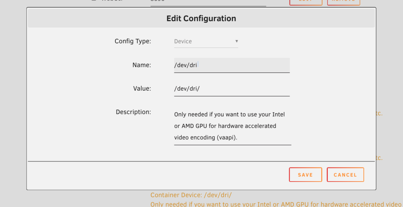

sross44 434 Posted January 27, 2025 Posted January 27, 2025 19 minutes ago, Underwood said: Yep, I have premier. Settings look fine. I’ve tried checking only Quicksync, then VAAPI but neither worked. Also assuming you have /dev/dri set up properly in the container settings for GPU passthrough?
Underwood 0 Posted January 27, 2025 Author Posted January 27, 2025 3 minutes ago, sross44 said: Also assuming you have /dev/dri set up properly in the container settings for GPU passthrough? Yes. when I click on the Info button next to the quicksync checkbox in the transcoding section it seems to show the correct igpu too „Adapter #0: 'JasperLake UHD Graphics' Id:20065 (Driver:, Vendor: 32902, SDK Version: 1.35)“

Neminem 1623 Posted January 28, 2025 Posted January 28, 2025 (edited) @Underwood We would need hardware detection logs, ffmpeg logs from the time of transcoding and server logs. From those logs we can get a better view of you issues. AND more important what docker image are you using ? also a screenshot of your Device config in unRaid. Edited January 28, 2025 by Neminem

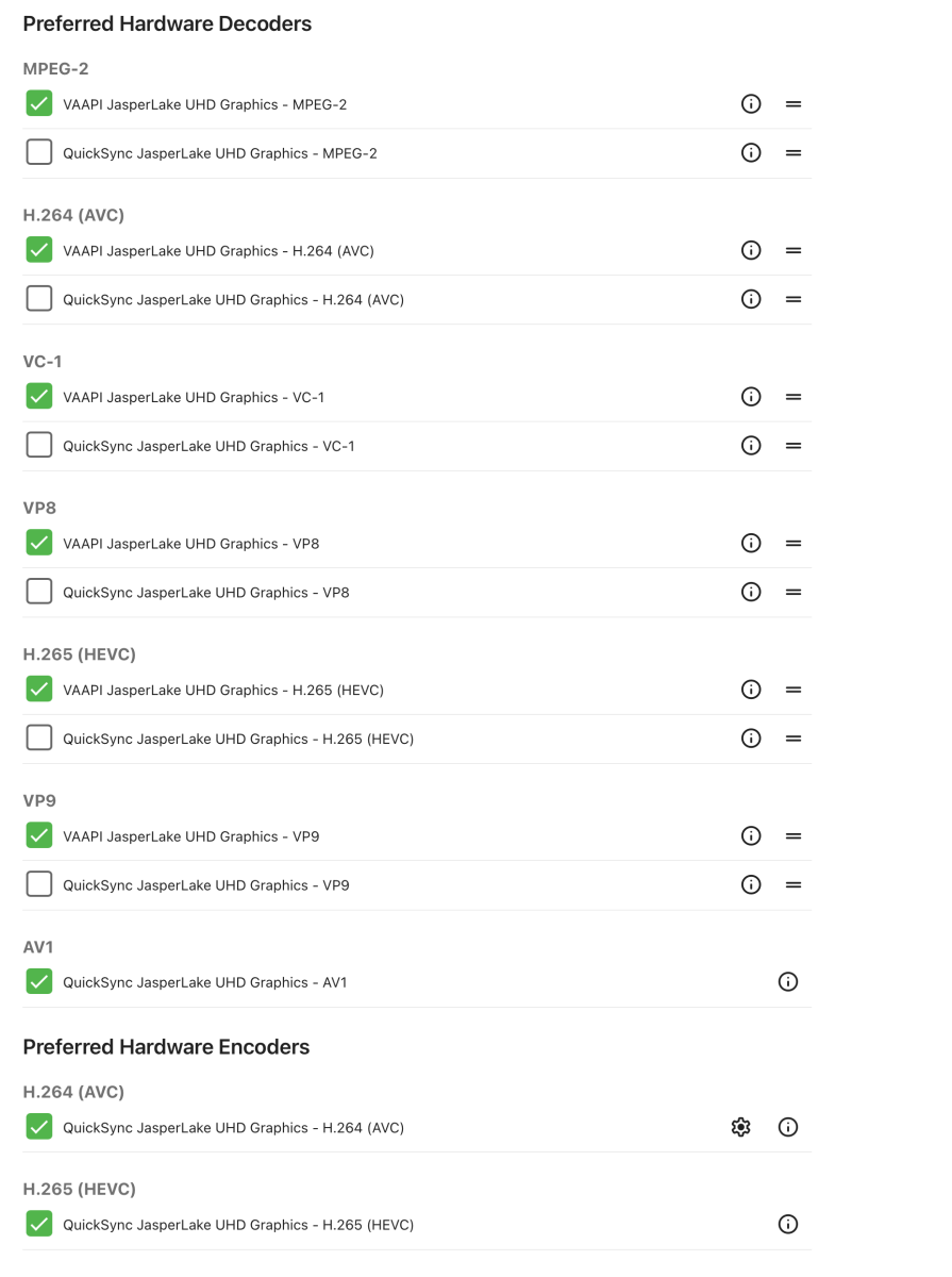

Neminem 1623 Posted January 29, 2025 Posted January 29, 2025 Try switching everything to vaapi. Decoders, Endoders and tone mapping.
Underwood 0 Posted January 29, 2025 Author Posted January 29, 2025 39 minutes ago, Neminem said: Try switching everything to vaapi. Decoders, Endoders and tone mapping. I've set decoders to VAAPI but for encoders the only option available is quicksync
Neminem 1623 Posted January 29, 2025 Posted January 29, 2025 Guess I'm out of ideas, sorry. Since you are using beta this issue should be transfered to emby beta section of this forum.
Underwood 0 Posted January 29, 2025 Author Posted January 29, 2025 1 minute ago, Neminem said: Guess I'm out of ideas, sorry. Since you are using beta this issue should be transfered to emby beta section of this forum. Just to clarify: This screenshot is from the stable release since you asked me to try the official container. But yeah, looks the same in the beta for me.
