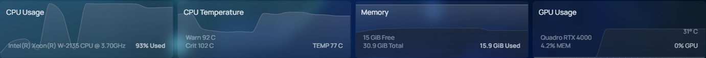

ryderjj89 33 Posted January 30, 2025 Posted January 30, 2025 Hello! I just recently installed a new Quadro RTX 4000 to my server and Emby can see it. However, I have someone playing something right now and transcoding is pegging my CPU at almost 100% during the entire process while the GPU sits at 0% usage. The below widgets are from my Homepage dashboard. This is from 2 items that are being played right now. Both transcoding. I would REALLY like to not have to throttle transcoding on this Xeon W-2135 and have the GPU do some of the work for which it was purchased. Is there a way or can there be a way that we can force the GPU to take some or all of this load?

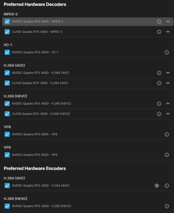

ryderjj89 33 Posted January 30, 2025 Author Posted January 30, 2025 Just now, GrimReaper said: Hm: Do you maybe have Diagnostics plugin installed? I do have the Diagnostics plugin installed. This is what's checked. I also noticed in one of the logs, this little tidbit which caused it to fallback to software: CUDA_ERROR_NO_DEVICE: no CUDA-capable device is detected I'm using Ubuntu 24.04 LTS with Emby running in Docker if that helps at all.
GrimReaper 4897 Posted January 30, 2025 Posted January 30, 2025 (edited) The second session was as said: 12 minutes ago, GrimReaper said: maybe it was and it errored out with fallback to software transcode Quote >>>>>> FindVideoEncoder - MediaType: h264, UseHardwareCodecs: True, HWA-Mode: Advanced Info Checking: 'NVENC Quadro RTX 4000 - H.264 (AVC)' Info Check successful - selecting 'NVENC Quadro RTX 4000 - H.264 (AVC)' >>>>>> FindVideoDecoder - MediaType: hevc, UseHardwareCodecs: True, HWA-Mode: Advanced Info Checking: 'NVDEC Quadro RTX 4000 - H.265 (HEVC)' Info Check successful - selecting 'NVDEC Quadro RTX 4000 - H.265 (HEVC)' Warning: Hardware-accelerated subtitle-overlay is disabled due to diagnostic option >>>>>> Subtitle Processing Steps for [0:2]: HDMV PGS subtitles Step Format Target Size HDMV_PGS_SUBTITLE >> Subs: Bitmap 1920x1080 scale >> Video: UNKNOWN 1920x-2 >>>>>> Processing Plan Name CanDoInHW WillDoInHW Reason NVDEC Quadro RTX 4000 - H.265 (HEVC) >> True True Hardware Codec VideoInput >> True True Matching hardware context Scaling >> True True ColorConversion >> True True SubtitleOverlay >> False False VideoOutput >> True True Hardware encoder NVENC Quadro RTX 4000 - H.264 (AVC) >> True True Hardware Codec >>>>>> Video Processing Steps for [0:0]: H.265 (HEVC) Step HW-Context Format SW-Format Size Next HEVC >> CUDA cuda yuv420p10 3840x2160 >> scale_cuda scale_cuda >> CUDA cuda yuv420p 1920x1080 >> setsar setsar >> CUDA cuda yuv420p 1920x1080 >> hwdownload hwdownload >> - yuv420p yuv420p 1920x1080 >> format format >> - yuv420p yuv420p 1920x1080 >> format format >> - yuv420p yuv420p 1920x1080 >> overlay overlay >> - yuv420p yuv420p 1920x1080 >> Quote 12:54:13.363 ffmpeg version 5.1-emby_2023_06_25 Copyright (c) 2000-2022 the FFmpeg developers and softworkz for Emby LLC 12:54:13.363 built with gcc 10.3.0 (crosstool-NG 1.25.0) 12:54:13.363 Execution Date: 2025-01-30 12:54:13 12:54:13.367 [AVHWDeviceContext @ 0x234e6a40] cu->cuInit(0) failed -> CUDA_ERROR_NO_DEVICE: no CUDA-capable device is detected 12:54:13.367 Device creation failed: -542398533. 12:54:13.367 Failed to set value 'cuda=cuda:0' for option 'init_hw_device': Generic error in an external library 12:54:13.367 Error parsing global options: Generic error in an external library 12:54:13.368 EXIT Quote >>>>>> Selected Codecs Decoder Automatic software decoder Encoder x264 Max Bitrate: 781 Mbit/s Color Formats: YUV420P, YUVJ420P, YUV422P, YUVJ422P, YUV444P, YUVJ444P, NV12, NV16, NV21, YUV420P10, YUV422P10, YUV444P10, NV20, GRAY8, GRAY10 - Bit Depths: 8, 10, 12, 14 Profiles: Baseline Profile (Level 6.2), Main Profile (Level 6.2), High Profile (Level 6.2), High 10 Profile (Level 6.2), High 4:2:2 Profile (Level 6.2), High 4:4:4 Predictive Profile (Level 6.2) Info Previous transcoding attempt failed. Falling back to software transcoding. >>>>>> FindVideoEncoder - MediaType: h264, UseHardwareCodecs: False, HWA-Mode: Advanced Info Checking: 'x264' Info Check successful - selecting 'x264' >>>>>> FindVideoDecoder - MediaType: hevc, UseHardwareCodecs: False, HWA-Mode: Advanced Info Checking: 'Automatic software decoder' Info Check successful - selecting 'Automatic software decoder' >>>>>> Processing Plan Name CanDoInHW WillDoInHW Reason Automatic software decoder >> False False Software Codec VideoInput >> False False Not a hardware decoder Scaling >> False False ColorConversion >> False False SubtitleOverlay >> False False VideoOutput >> False False Not a hardware encoder x264 >> False False Software Codec >>>>>> Video Processing Steps for [0:0]: H.265 (HEVC) Step HW-Context Format SW-Format Size Next HEVC >> - yuv420p10 yuv420p10 3840x2160 >> scale scale >> - yuv420p10 yuv420p10 1920x1080 >> format format >> - yuv420p yuv420p 1920x1080 >> overlay overlay >> - yuv420p yuv420p 1920x1080 >> Some fellow Linux user will have to step in and hopefully give some insight. @Q-Droid @Neminem @Lessaj Edited January 30, 2025 by GrimReaper
ryderjj89 33 Posted January 30, 2025 Author Posted January 30, 2025 (edited) Thanks Grim! In the meantime, I'm going to research that. I apparently did not have the nvidia-cuda-toolkit installed so I'm gonna get that added and take a look at some things. But definitely would appreciate anyone who can jump in to assist. Edit: I unchecked that option to disable hardware subtitle overlay and installed the nvidia-cuda-toolkit to Ubuntu itself. After restarting the container, I'm seeing usage out of it now. Edited January 30, 2025 by ryderjj89

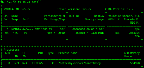

Lessaj 484 Posted January 30, 2025 Posted January 30, 2025 (edited) Unfortunately I'm not particularly familiar with the correct way to pass the GPU to docker, I just run Emby natively on CentOS Stream 9, but what I would check from the host level at least is to ensure that you're using the Nvidia driver, I know they have a new open source driver but I still install the one from their website, and make sure nvidia-smi is working and reporting output. You should not need the nvidia-cuda-toolkit, cuda is included with the Nvidia driver. Edited January 30, 2025 by Lessaj 1 1

Lessaj 484 Posted January 30, 2025 Posted January 30, 2025 The disable hardware accelerated subtitle overlay option is enabled by default, but should not be preventing it since the error indicates unable to init cuda, no capable device. What does nvidia-smi report on the host? Since you were using a 1650 before if that was working with the nvidia driver then unless it was really old that it didn't support the RTX 4000 that driver should still be working. I'm not sure if you can run nvidia-smi in the docker shell or not, I just haven't had a need to play around with docker containers. I'm thinking it's some kind of permission related issue when presenting the GPU to the docker container, but it's really just a wild guess.
ryderjj89 33 Posted January 30, 2025 Author Posted January 30, 2025 1 minute ago, Lessaj said: The disable hardware accelerated subtitle overlay option is enabled by default, but should not be preventing it since the error indicates unable to init cuda, no capable device. What does nvidia-smi report on the host? Since you were using a 1650 before if that was working with the nvidia driver then unless it was really old that it didn't support the RTX 4000 that driver should still be working. I'm not sure if you can run nvidia-smi in the docker shell or not, I just haven't had a need to play around with docker containers. I'm thinking it's some kind of permission related issue when presenting the GPU to the docker container, but it's really just a wild guess. This is what shows with nvidia-smi currently. Nothing is being transcoded right now as it looks to have finished. Also, I see you are using the 565.77 drivers. Would you say those are stable enough to update to?
Q-Droid 1011 Posted January 30, 2025 Posted January 30, 2025 Did you read thru the HW accel guide for Nvidia? It's step by step and states to not use the drivers from distro repos but to get them directly from Nvidia. 1
Lessaj 484 Posted January 30, 2025 Posted January 30, 2025 550.120 doesn't seem that old, it should support the card just fine. 565.77 seems fine to me but the VM does not run a DE so it's purely being used for transcoding purposes. I doubt having a DE running would affect docker using the GPU as well. I mostly picked it because it was the latest supported by nvidia-patch and I was updating my VM anyway so I had to rebuild the kernel modules regardless.
