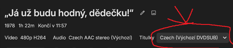

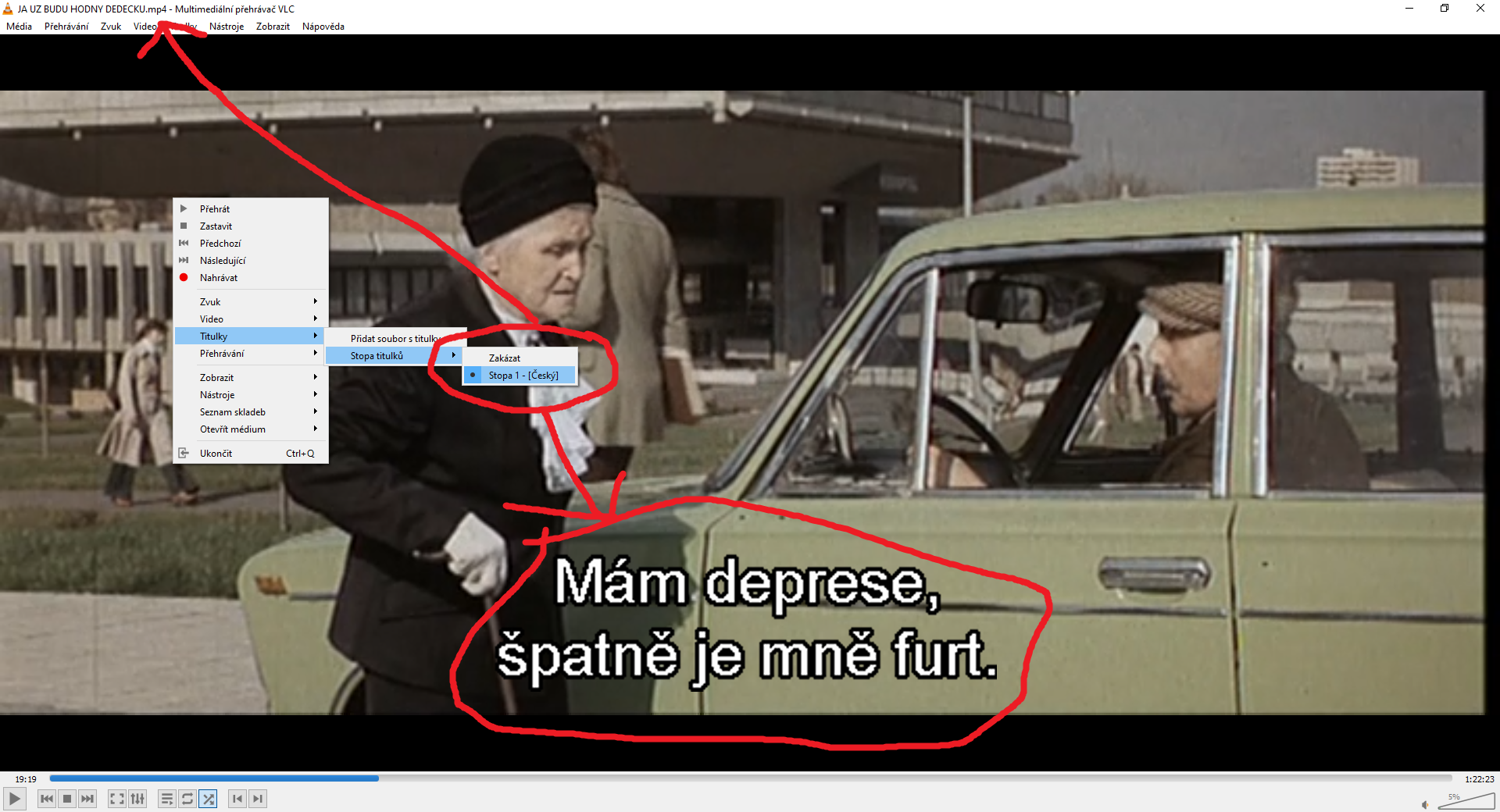

Houfino 41 Posted January 28, 2025 Posted January 28, 2025 (edited) Hi...I have a problem...I have almost 500 DVDs at home..I converted them from DVD to MP4 (also contains Czech subtitles)...I put them in Emby and the video plays fine, but I can't see the subtitles.....I have subtitles turned on, but why can't I see the subtitles..Strange...Emby doesn't support dvdsub??? I can't use MKV because my server is old and underpowered I use VLC for Windows and I can see OK...But Emby doesn't see subtitles at all when subtitles are turned on Better MKV than MP4 or?? If you want a video, I can send one...Thank you embyserver.txt ffmpeg-transcode-73aec1ec-c079-4f07-b922-20fbbaff4a4e_1.txt ffmpeg-transcode-59a238ad-1991-44cf-815c-c6c45df4eb86_1.txt Edited January 28, 2025 by Houfino
Luke 42240 Posted January 28, 2025 Posted January 28, 2025 hi, is dvdsub normal in an mp4? can you try mkv instead?
Carlo 4561 Posted January 29, 2025 Posted January 29, 2025 23 hours ago, Luke said: hi, is dvdsub normal in an mp4? can you try mkv instead? It's technically supported in MP4 but has compatibility issues with many media players. Some display the images wrong, some might not display them at all, while others might have issues with rendering or timing. Because of those issues its recommended to use MKV containers instead for dvdsub. On 1/28/2025 at 4:49 AM, Houfino said: I can't use MKV because my server is old and underpowered Better MKV than MP4 or?? MP4 & MKV are both containers. MKV is much more flexible in what codecs and track types it supports than MP4. You can change the container from mp4 to mkv about as fast as you can read/write the file using ffmpeg. ffmpeg -i input.mp4 -c copy output.mkv (Replace input.mp4 with the actual name of your MP4 file and output.mkv with the desired name for the MKV file.) ffmpeg -i "Top Gun (1986).mp4" -c copy "Top Gun (1986).mkv"
