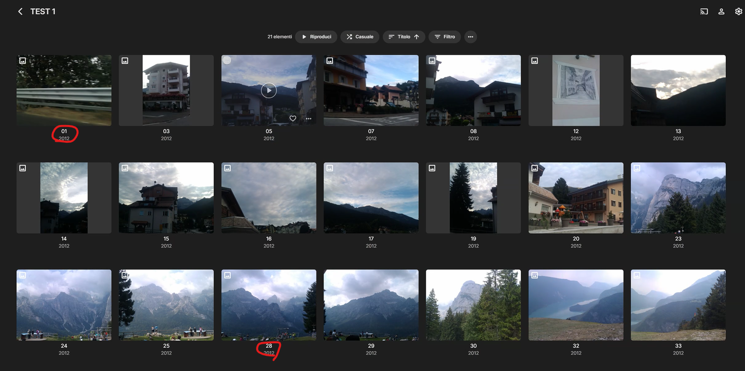

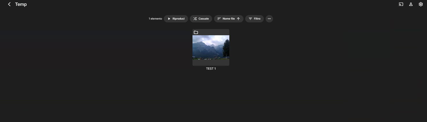

mikekoke 3 Posted January 27, 2025 Author Posted January 27, 2025 Inside the photo library there is the test 1 folder, the cover of the test 1 folder is not the first image in the folder, image 01 but it is image 28
Luke 42238 Posted January 28, 2025 Posted January 28, 2025 Hi there, can you please show screenshot examples to demonstrate that? Thanks !
mikekoke 3 Posted January 28, 2025 Author Posted January 28, 2025 In image 1 you can see the cover, while in image 2 you can see the photos contained in the folder test 1. Image 01 of test 1 folder is not used as the cover, but image 28 is used as the cover instead. I've done several tests recreating the library, but I always have the problem.

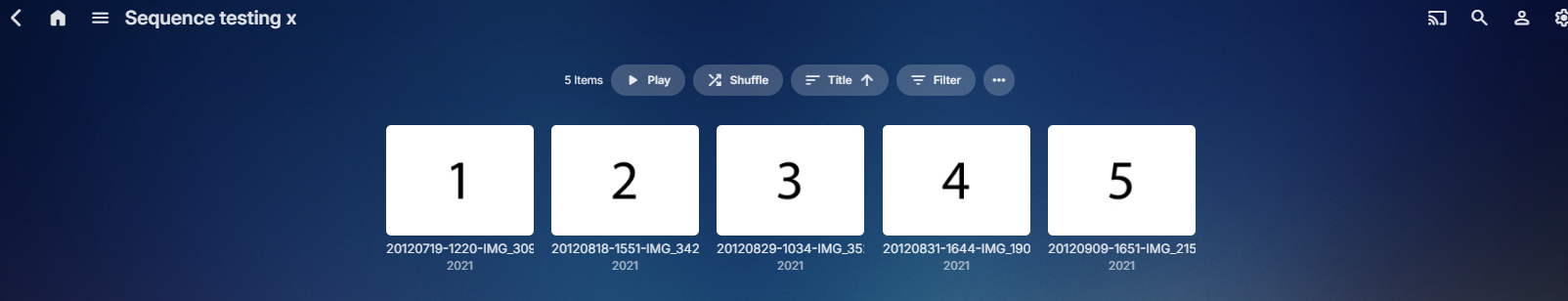

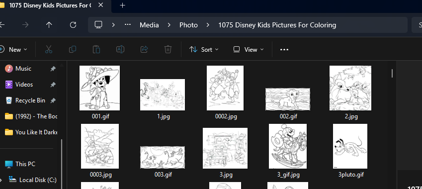

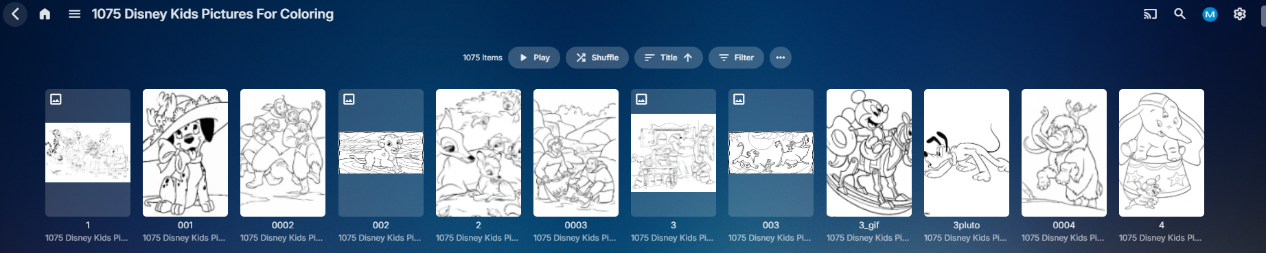

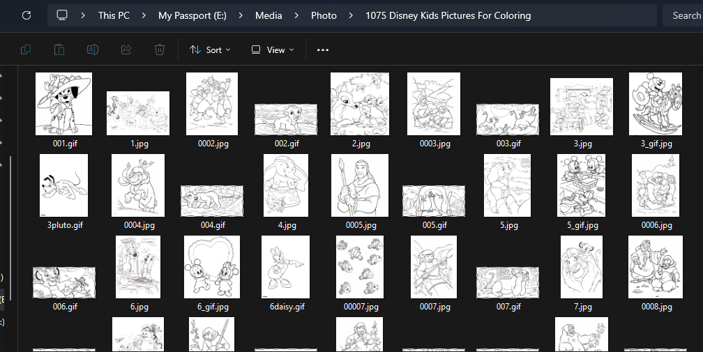

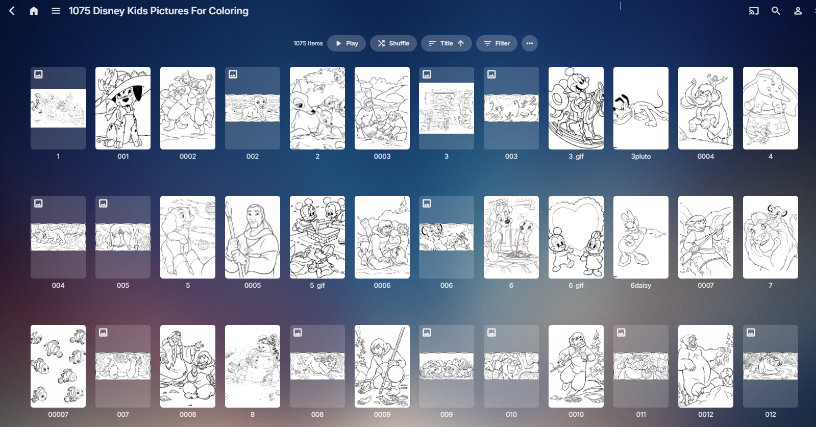

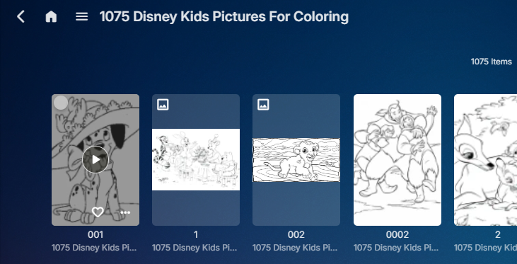

Happy2Play 9811 Posted January 28, 2025 Posted January 28, 2025 2 hours ago, Luke said: @Happy2Playare you able to reproduce? Majority of the time no but just did adding a bunch of files as it used 00007. Looks like 4.8 and 4.9 did the same thing on this test add. All other tests appeared correctly so I don't know if there is a number variable.

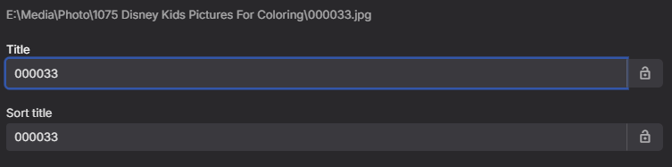

Happy2Play 9811 Posted January 28, 2025 Posted January 28, 2025 Testing a theory I am/will guess number padding can be an issue as I add a couple leading zeros and removed and readded folder and 000033 is now chosen. But from a universal naming scheme I have not been able to no use first image yet. 1

Happy2Play 9811 Posted March 1, 2025 Posted March 1, 2025 12 hours ago, Luke said: @Happy2Playare you able to reproduce on the 4.9 beta channel? From my example above it is showing image named "1" now instead of the padded number image.
Luke 42238 Posted March 1, 2025 Posted March 1, 2025 50 minutes ago, Happy2Play said: From my example above it is showing image named "1" now instead of the padded number image. What is 001? is that an image or subfolder?
Happy2Play 9811 Posted March 1, 2025 Posted March 1, 2025 1 minute ago, Luke said: What is 001? is that an image or subfolder? Actually it is a gif
Luke 42238 Posted March 1, 2025 Posted March 1, 2025 27 minutes ago, Happy2Play said: Actually it is a gif Have you looked at the sort titles for those first few?
Happy2Play 9811 Posted March 1, 2025 Posted March 1, 2025 (edited) 1 hour ago, Luke said: Have you looked at the sort titles for those first few? Sorry, I guess I should have shown the full picture as the previous one was default "filename". I was just looking at it was showing the correct first image for folders in this release. Edited March 1, 2025 by Happy2Play
Luke 42238 Posted March 1, 2025 Posted March 1, 2025 OK so it looks good in 4.9? And you’re right. The thumbnail chosen is not tied to your selected sort order in the ui.
Happy2Play 9811 Posted March 2, 2025 Posted March 2, 2025 18 hours ago, Luke said: OK so it looks good in 4.9? In my tests yes. Unless @mikekokecan provide different test scenario? 1
