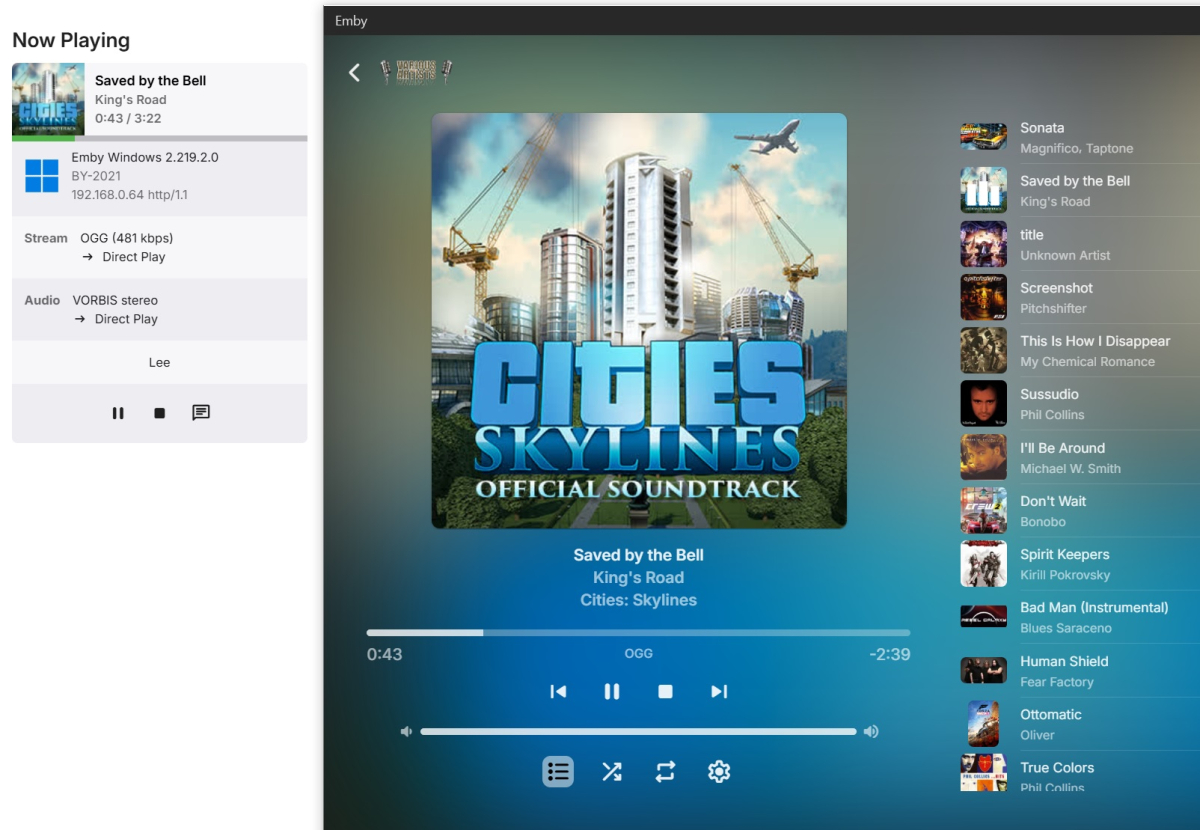

FordGT90Concept 103 Posted March 7, 2025 Author Posted March 7, 2025 (edited) It's apparently fixed but not in the way you're probably expecting. It says it is direct playing: I've checked many titles from many albums and they're all working. Edited March 7, 2025 by FordGT90Concept
