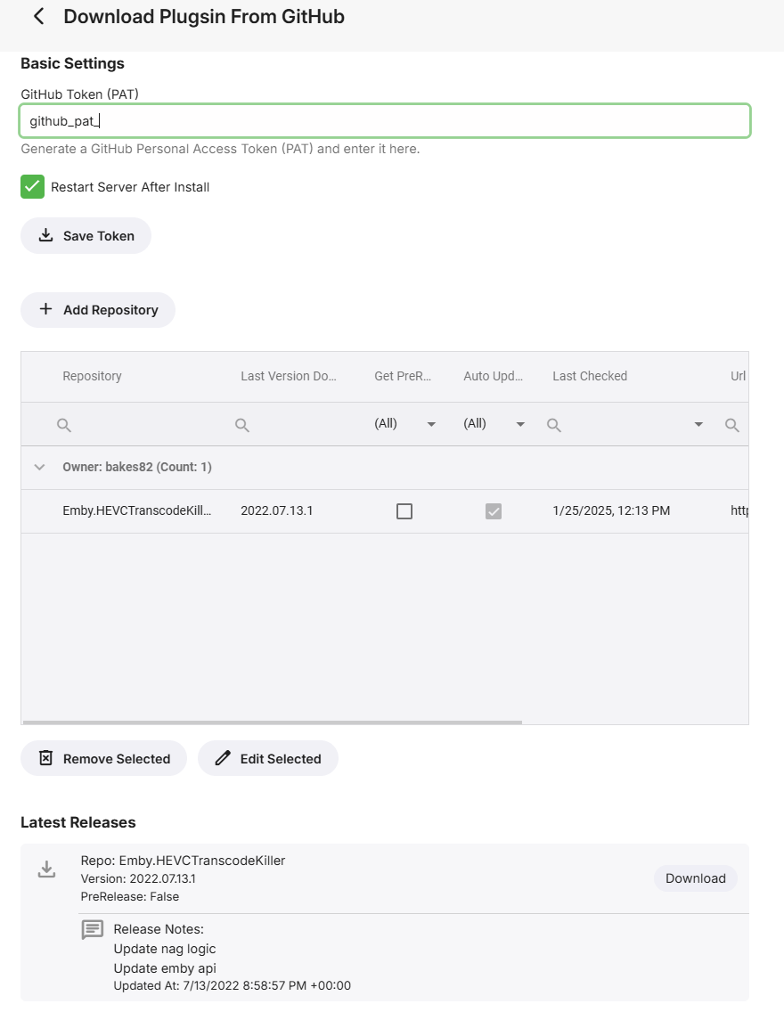

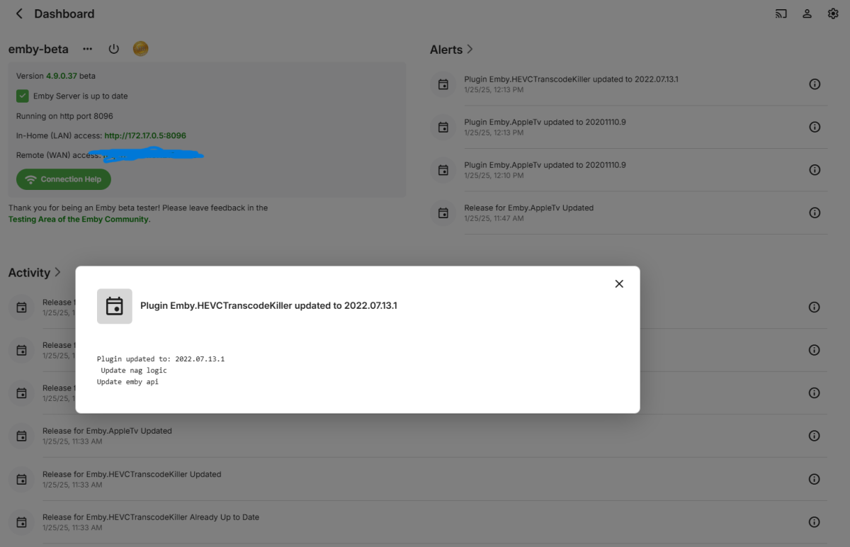

bakes82 167 Posted January 25, 2025 Posted January 25, 2025 I got tired of having to manually load/update my plugins to servers so I wrote a plugin that if you give it a github repo url and it has a published release that has a .dll file it will install it. It also has a schedule task that will check nightly and install and optionally restart the server on new releases. The code base is targeting the 4.9 SDK no idea if that works on 4.8 systems. bakes82/Emby.GitHubRepoPluginInstall 4 2

shocker 135 Posted February 28, 2025 Posted February 28, 2025 @bakes82quick question, in case a repo contains releases for Emby and Jellyfin, is this picket automatically for Emby by name search? For example: https://github.com/ThePornDatabase/Jellyfin.Plugin.ThePornDB
bakes82 167 Posted February 28, 2025 Author Posted February 28, 2025 7 hours ago, shocker said: @bakes82quick question, in case a repo contains releases for Emby and Jellyfin, is this picket automatically for Emby by name search? For example: https://github.com/ThePornDatabase/Jellyfin.Plugin.ThePornDB It doesn’t currently, also that one wouldnt show any releases anyways because it’s publishing a .zip and this plugin looks for explicit.dll. This plugin was designed for my private GitHub repos that I push out for other people as an easy way to manage the updates. I just know it’s a pita to manually search the forums/discord/email for the file to add and well if other dev could just publish it in the same format it would work. Also possible someone takes it and makes it better and makes like a manifest type format like jellyfin does, though honestly that’s something Emby should just do and have it be part of the base platform. 1
