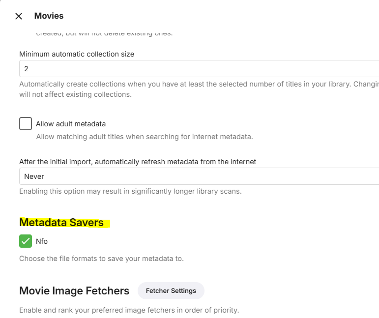

ebr 16306 Posted January 26, 2025 Posted January 26, 2025 4 hours ago, warrencalvert said: Is the 'favourite' designation stored in the metadata? No it is in the database so it would come with your restore of the backup I suggested. 4 hours ago, warrencalvert said: I dont see an option to save metadata with media, please confirm where this option is. And, if you have selected any specific images:
Happy2Play 9798 Posted January 26, 2025 Posted January 26, 2025 5 hours ago, warrencalvert said: The documentation does mention setting 'Save metadata as NFO' but this setting isnt in the Library settings (even with advanced enabled) What do you see? What is the content type of the library? Did you uninstall the nfo metadata plugin? On 1/25/2025 at 6:13 AM, warrencalvert said: I have a bigger concern though that I have lots of favourites (particularly for a video library of home videos). I dont want to lose these favourites, what can I do to make sure the favourites are migrated across and are updated to the new library path? @Lukeor @ebrmay have to comment further as this will be lost as the new path will clear them from the db and readd them as new items (they have no providerids) so I really have no idea beside manually editing the database to maintain this info if possible. 1
