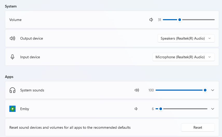

Laovn 3 Posted March 15, 2025 Posted March 15, 2025 19 hours ago, softworkz said: It was a deliberate decision and I explained the reasoning. That's all. We can agree that it's complicated and individual situations are multifold, so I can of course imagine that it makes sense in some cases to have being persisted. We'll surely be able to provide an option to retain the volume across runs of the app. Thanks What about the windows volume mixer bug? 19 hours ago, Laovn said: The audio set in volume mixer actually persists after restart while resetting the volume mixer slider back to 100 %. Meaning if you reduce EMBY app volume to 1% in volume mixer it will retain this 1% volume after app restart while resetting the volume slider back to 100% thus you cant hear anything but in-app sound is 100% and Volume mixer sound is also 100%. Moving the slider from 100% to 99% gives of an instant SPIKE in audio. Is this also a feature?

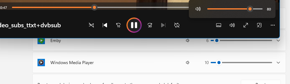

softworkz 5133 Posted March 18, 2025 Posted March 18, 2025 On 3/15/2025 at 10:54 PM, Laovn said: On 3/15/2025 at 3:24 AM, Laovn said: The audio set in volume mixer actually persists after restart while resetting the volume mixer slider back to 100 %. Meaning if you reduce EMBY app volume to 1% in volume mixer it will retain this 1% volume after app restart while resetting the volume slider back to 100% thus you cant hear anything but in-app sound is 100% and Volume mixer sound is also 100%. Moving the slider from 100% to 99% gives of an instant SPIKE in audio. Is this also a feature? You're the first one reporting this. Is this about video or audio playback? Do you mean the slider named "Emby"? When I restart the app, that sllidet is always back to 100%. Do you get different results?

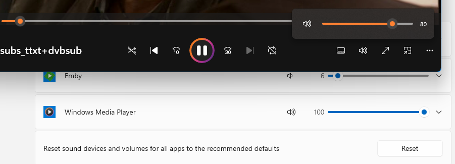

softworkz 5133 Posted March 18, 2025 Posted March 18, 2025 When I do a test with Windows Media Player, I get the same result: SETUP AFTER RESTART Same like in case of Emby, the volume slider in the mixer is independent of the volume setting inside the app, but the mixer slider gets back to 100%. (just that WMP remembers the in-app volume whiel Emby does not, as discussed above) Do you see a different behavior on your machine?
Laovn 3 Posted March 19, 2025 Posted March 19, 2025 22 hours ago, softworkz said: When I restart the app, that sllidet is always back to 100%. Do you get different results? Yes it is always back to 100. But real volume stays at the previous set value. If I set it to 1% it will sound like 1% after restart but show up as 100%.
Laovn 3 Posted March 19, 2025 Posted March 19, 2025 (edited) 23 hours ago, softworkz said: When I do a test with Windows Media Player, I get the same result: SETUP AFTER RESTART Same like in case of Emby, the volume slider in the mixer is independent of the volume setting inside the app, but the mixer slider gets back to 100%. (just that WMP remembers the in-app volume whiel Emby does not, as discussed above) Do you see a different behavior on your machine? I don't use windows media player. I use Media Player Classic (MPC). I see the same behavior it shows up as 100% after restart. However it also resets the volume back to 100% thus when you see 100% you get 100% there is no mismatch from what is displayed and the actual playback volume. Emby does not. It will play at the pre restart slider value while showing up as 100%. PS: All these players have built in persistent volume sliders. Thus I never even though about playing with their volume mixer slider. Edited March 19, 2025 by Laovn
softworkz 5133 Posted March 19, 2025 Posted March 19, 2025 1 minute ago, Laovn said: Thus I never even though about playing with their volume mixer slider. I don't quite understand - you were the one to bring this up... 2 minutes ago, Laovn said: I don't use windows media player. I mean to take it as a reference in terms of OS behavior. Can youi please try that for comparison? 18 minutes ago, Laovn said: Yes it is always back to 100. But real volume stays at the previous set value. If I set it to 1% it will sound like 1% after restart but show up as 100%. That's not what I'm seeing. When I have 100% inside the Emby app and set 5% in the volume mixer, after restarting the app, it plays at full volume again (=loud). Are talking about video or audio playback? Which OS, which audio device, if it's about video playback, please post MPV logs from playback before-closing and playback after-restart. Thanks
Laovn 3 Posted March 19, 2025 Posted March 19, 2025 58 minutes ago, softworkz said: I don't quite understand - you were the one to bring this up... I bought it up because Emby does not have a persistent slider. If it did this behavior would be irrelevant as you'd never go there. 59 minutes ago, softworkz said: That's not what I'm seeing. When I have 100% inside the Emby app and set 5% in the volume mixer, after restarting the app, it plays at full volume again (=loud). Are talking about video or audio playback? Which OS, which audio device, if it's about video playback, please post MPV logs from playback before-closing and playback after-restart. Video playback. Windows 11 How do I access MPV logs? 1 hour ago, softworkz said: I mean to take it as a reference in terms of OS behavior. Can youi please try that for comparison? Sorry but I don't have it installed.
