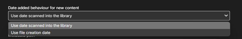

Gryzor 27 Posted January 23, 2025 Posted January 23, 2025 So I've set the "Date Added behavior for new content" to "use date scanned into library". This is not honored when sorting, and the "date added" is the original file creation date. Just to test I just downloaded Falling Down *after* changing the setting above, in case it only works for new content, but the movie still appears way down in my list. using the file creation date. Any ideas? Running the Unraid docker. PS the whole thing with this option is horribly named. "file creation date" is definitely NOT "date added" and should probably be a whole different sorting option imo...
GrimReaper 4897 Posted January 23, 2025 Posted January 23, 2025 45 minutes ago, Gryzor said: in case it only works for new content It does only work for new content. 46 minutes ago, Gryzor said: Any ideas? Have you pressed "Save" upon changing to "Date scanned" in Library>Advanced tab? It's frequent omission, just to be sure. Otherwise, exact example would be required. How to Report a Problem

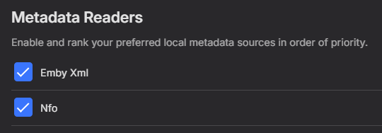

Happy2Play 9812 Posted January 23, 2025 Posted January 23, 2025 Well it is a grey area, but it comes back to Read options per library as if Emby did not read the already written nfo it would have honored "Date Added behavior for new content" setting as none would have existed. So you have to decide if the existing metadata is correct or if you only want Emby to obtain it so ignore something that is already there per your Reader setting.
Gryzor 27 Posted January 24, 2025 Author Posted January 24, 2025 Ah I think I see what you both mean, yes. It certainly is tricky. @Happy2Play, where is that option you have in your screenshot? Can't find it...
