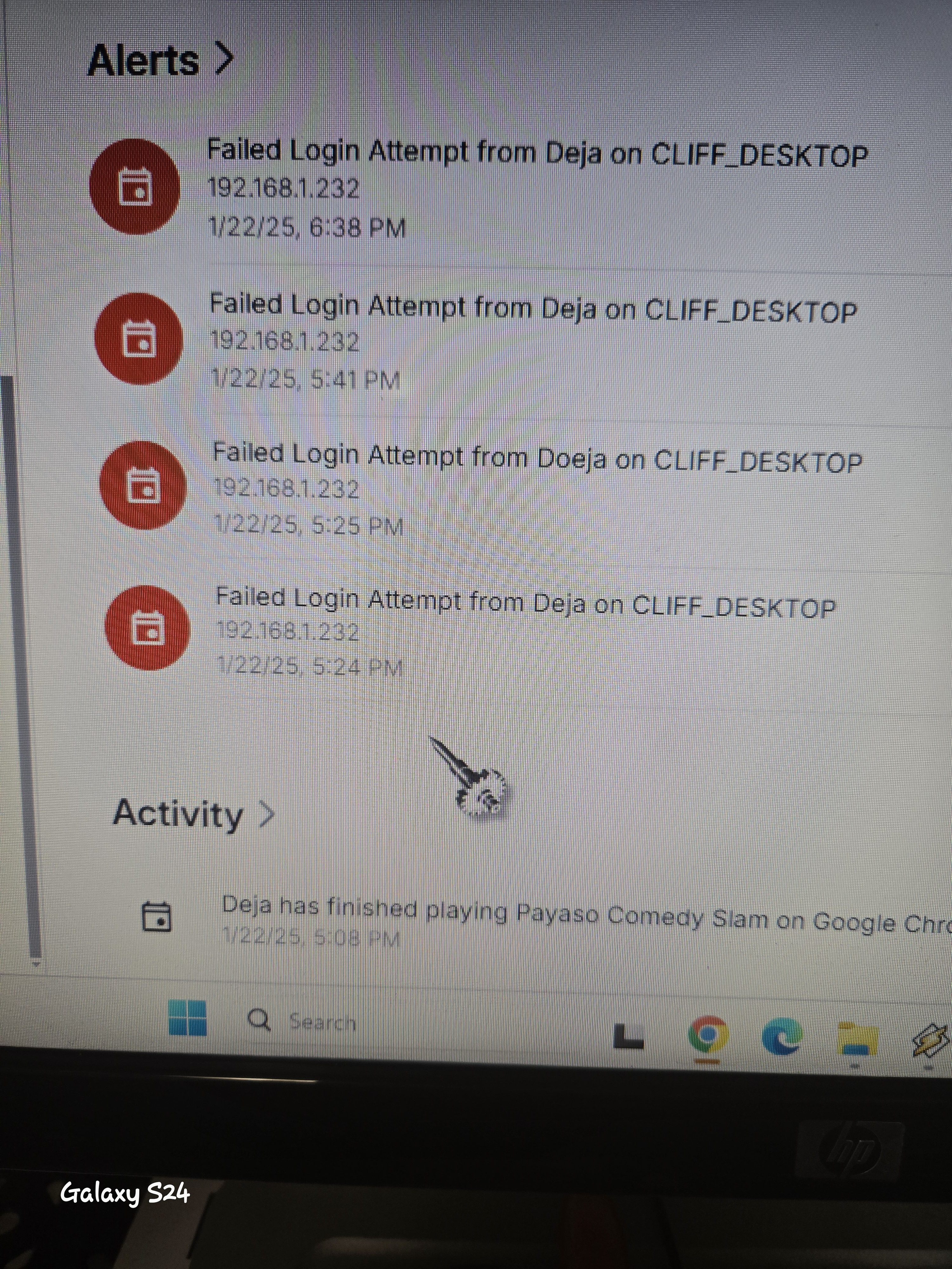

Ailurophile 1 Posted January 23, 2025 Author Posted January 23, 2025 I've been trying to login via what Emby calls my server: Cliff_Desktop. There are four choices: deja (my username); Manual Login; Forgot Password?; and Change Server. I've used both Deja and Manual Login, and get sneered at either way.

Ailurophile 1 Posted January 23, 2025 Author Posted January 23, 2025 I said several times that I am not a geek/nerd/egghead or whatever the term du jour is. I found the Advanced menu, but not Logs. But I did see what looks like a log of login attempts. All instances are from my teevee.

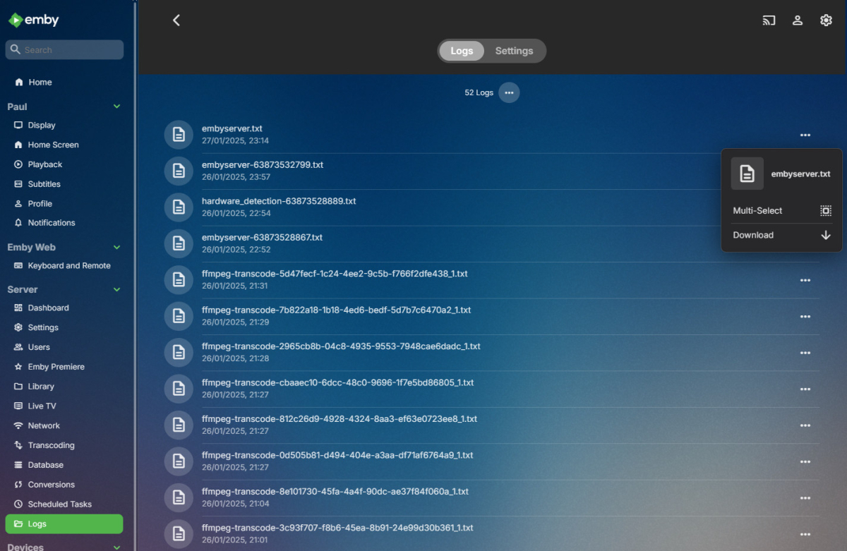

pwhodges 2039 Posted January 27, 2025 Posted January 27, 2025 On 23/01/2025 at 00:46, Ailurophile said: I said several times that I am not a geek/nerd/egghead or whatever the term du jour is. You don't need to be. (sorry for delayed reply - I've been away) First try the action which fails. Then click the cog at the top right of the home screen: Then look down the menu on the left until you get to the Logs entry; click it to see the logs; to the right of the top log (embyserver.txt) click the three dots, and select Download: When the log has downloaded, simply drag it onto you next post in this forum before submitting it, which will cause it to be attached. Then the devs (or some helpful user who sees it earlier) can check it to see the likely cause of your issue. Paul PS On 26/01/2025 at 21:20, Ailurophile said: PWhodges; one of the issues I have with Forums in general is what you tout as an advantage: that others, outside of the company, may contribute. If one of them leads me down a bad path, or provides bogus information, there's nothing I can do about it. If I know that actual employees (or a contractor) is handling the questions, I can be reasonably assured that the information is correct. (1) You can do something - ask again! - keep asking until you get the solution. Also, be a bit more trusting. But (2), it can be naïve to assume that employees give consistently accurate answers... Here, you either get the developers themselves, or users who are taking the trouble to try to help (and you can, for instance, see in their profile how often their posts are marked as being helpful, or solving a problem). 1
