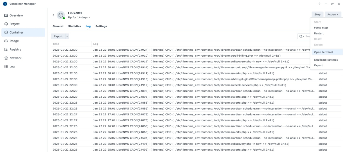

nascent 2 Posted January 22, 2025 Author Posted January 22, 2025 (edited) which terminal output? it's a synology, the forum wont let me update my post to state that I'm using docker in a synology. it's gui not terminal im not sure what a run/compose file is. i downloaded the emby/embyserver container Edited January 22, 2025 by nascent
Solution DonMacaroni 55 Posted January 22, 2025 Solution Posted January 22, 2025 1 hour ago, nascent said: which terminal output? it's a synology, the forum wont let me update my post to state that I'm using docker in a synology. it's gui not terminal im not sure what a run/compose file is. i downloaded the emby/embyserver container I run Emby natively, but Container Manager (Docker) on Synology does have terminal, it is accessible via "Action" menu.
DonMacaroni 55 Posted January 22, 2025 Posted January 22, 2025 (edited) I think, by terminal output, @Lukeis actually interested about container Log which you can export via "Export" button. Hope this helps. @nascentjust curious, why not use Emby Server package? Only things I personally use Docker for, is to run things, which don't have native package for Synology. Edited January 22, 2025 by DonMacaroni
nascent 2 Posted January 22, 2025 Author Posted January 22, 2025 1 hour ago, DonMacaroni said: I think, by terminal output, @Lukeis actually interested about container Log which you can export via "Export" button. Hope this helps. Many thanks, I was looking in the wrong place for error logs (the filesystem and within the container ui), I didn't spot the log tab on the main docker window. Oops. I was repeatedly seeing lines like: Start container emby failed: {"message":"driver failed programming external connectivity on endpoint emby (aea78e5aeeaaeeebc5cbc345aea78e5aeeaaeeebc5cbc345 Bind for 0.0.0.0:8920 failed: port is already allocated"}. I previously changed the port 8096 to avoid conflicts with jellyfin and the old native emby install. but it seems i neglected to remap 8920. i thought it as config corruption as the client was working fine on first launch, but that was a read herring. many thanks for the support.
