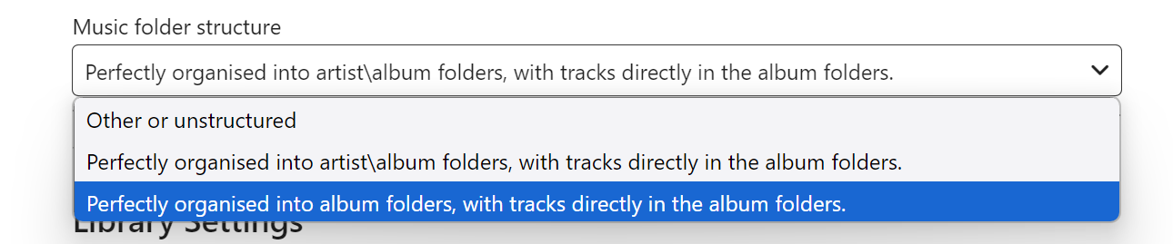

user24 349 Posted January 22, 2025 Posted January 22, 2025 (edited) Something else to possibly look at is your music folder/file structure and what you have selected in your Emby music library: If this doesn't help, you might need to give a specific example with more details and relevant screenshots for further assistance... You also said some albums are good - what is the difference between the good albums and the bad albums - there might be some clues there??? Edited January 22, 2025 by user24
vincen 72 Posted January 22, 2025 Author Posted January 22, 2025 7 hours ago, user24 said: Something else to possibly look at is your music folder/file structure and what you have selected in your Emby music library: Well for that it's good as I'm with the advised structure artist/albums/tracks and my files are organised that way 7 hours ago, user24 said: You also said some albums are good - what is the difference between the good albums and the bad albums - there might be some clues there??? well I found out one clue. All the recent albums that I have tagged with Easytag are not recognised properly in Emby Unhappy I can't find an option in Easytag that would change that ! Any suggestions of a good tag editor for Linux a? s Easytag looks not good for it. Only other one I could find is Picard Musicbrainz but it's unusable as the db it uses is a complete mess Here are options I have in Easytag right now that are following Emby indications in documentation so it looks to be good but it's not working....

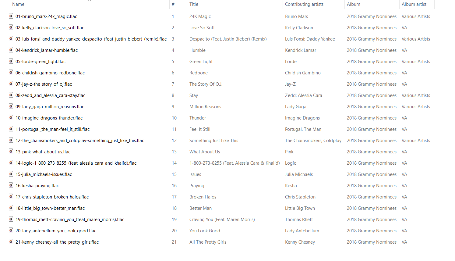

vincen 72 Posted February 7, 2025 Author Posted February 7, 2025 The music scanner is just terrible I import a compilation so Album Artist is tagged as "Various Artists", I scan the library and then it reports some tracks as being from VA artist and some properly as "Various Artists" tag..... I tag the whole compil as VA, it updates then properly whole album as from VA, I tag back as Various Artists and again same mess: half of album indexed as VA artist and half other as Various artists..... Emby is clearly as bad as Plex for Music, such a shame there is no media manager able to handle music properly

Luke 42238 Posted February 14, 2025 Posted February 14, 2025 Quote I scan the library and then it reports some tracks as being from VA artist and some properly as "Various Artists" tag Let's look at the contents of those audio files. I bet we will find some of them tagged with VA. Actually I can pretty much promise that. Please zip up the album and attach it here or PM it to me. Thanks.

vincen 72 Posted February 14, 2025 Author Posted February 14, 2025 2 hours ago, Luke said: Let's look at the contents of those audio files. I bet we will find some of them tagged with VA. Actually I can pretty much promise that. Please zip up the album and attach it here or PM it to me. Thanks. Well it's the way Emby handles Various Artists tag that is a damn issue ! Please see your pm I have checked all files individually of the album and they are all properly tagged as Various Artists for Artist album but Emby splits the album in 2 (one as VA, one as Various Artists...). To be sure it's not a problem with Easytag I checked each files individually in file browser to be sure tags were well written in files. Thanks
Luke 42238 Posted February 15, 2025 Posted February 15, 2025 I didn't even have to test your files inside Emby (although I did). I could see the problem right from windows explorer: Look at the last column.
vincen 72 Posted February 15, 2025 Author Posted February 15, 2025 (edited) 2 hours ago, Luke said: I didn't even have to test your files inside Emby (although I did). I could see the problem right from windows explorer: Thanks @Lukefor the check and the problem becomes more and more mysterious. If I check that exact same file (the second track) in Linux file manager it lists well "Various Artists" and not VA ! How is that possible ? Update: using an other tag editor (Ex Falso) I discovered that the problematic audio files have 2 Album artist tag in it (the standard one and a non standard one) and it looks like Windows Explorer and Emby are using that non standard tag when it's present Once I deleted the non standard tags in the files and putted them back in Emby it got indexed properly ! Edited February 15, 2025 by vincen
Luke 42238 Posted February 17, 2025 Posted February 17, 2025 Quote and it looks like Windows Explorer and Emby are using that non standard tag There isn't really a definitive standard or non-standard embedded tag. For the best results with as many applications as possible, you should use tagging software that can write to all of them. 1
