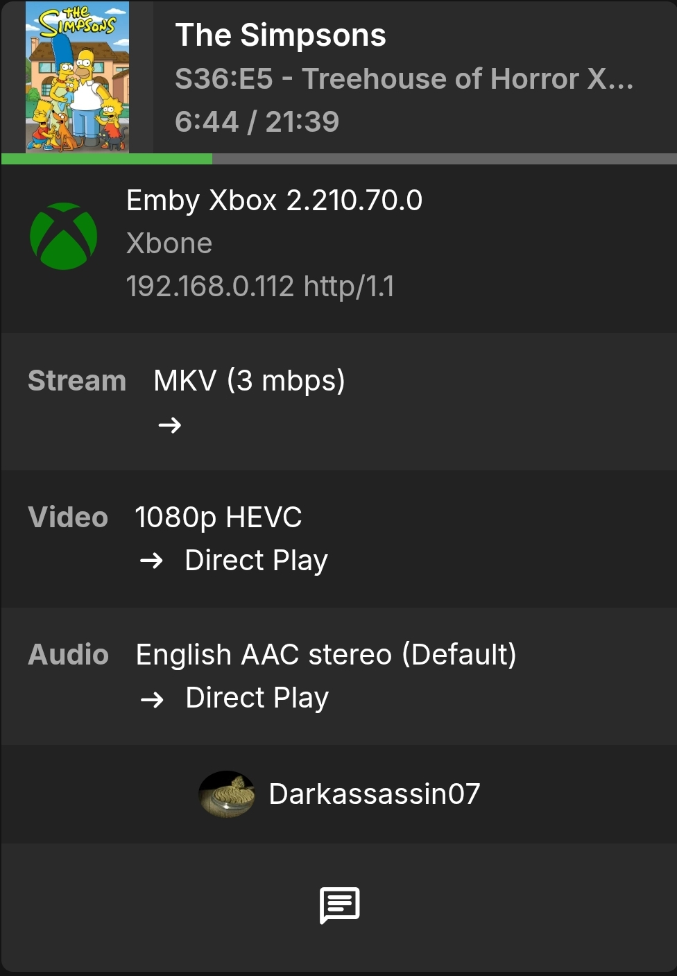

darkassassin07 690 Posted January 21, 2025 Posted January 21, 2025 (edited) I've noticed the new xbone app (v2.210.70.0) does not display remote controls in the server dashboard. It also does not display player controls to users that connect via the cast menu in other clients (tested with the web app + android) When connected with another client; you can use it to begin playing new media on the xbone you're connected to (hence, 'sort of'), but at no point are you presented with media controls for the currently playing media. My emby server is behind an nginx proxy that all clients are forced to use. (only the WAN address in the dash is routable regardless of where the client is) It contains the following config lines and no other client has websocket issues (android, IPhone, and the web app all work perfectly), so I do not believe it's proxy related. proxy_set_header Upgrade $http_upgrade; proxy_set_header Connection $http_connection; proxy_connect_timeout 10s; proxy_send_timeout 1h; proxy_read_timeout 1h; Edited January 21, 2025 by darkassassin07

darkassassin07 690 Posted January 21, 2025 Author Posted January 21, 2025 (edited) No, I've only used the standard app, and the 'holiday bonanza' version. To be thorough, I just removed it from my system and re-installed using the same user account that entered the draw. (twice) I got the same results: no player controls in the dashboard and remote clients. The version number is the same. It also says 'Emby Xbox' now, where it used to say 'EmbyPlus Xbox' last I'd looked (a few weeks ago); and I have the option to enter the Holiday Bonanza in the settings again despite already entering and 'winning'. For good measure, I entered again: 'already registered' HEVC content is direct playing. Side note: This time, I had significantly more problems getting past the 'the app has been setup' popup message on initial startup. Opening the side menu, trying all the inputs on both controller and ir remote, restarting the app/console; it just would not give focus to the popup window for you to select 'ok'. Spent a good 15min on that alone; eventually it worked when I spammed the A button between animations. Edited January 21, 2025 by darkassassin07

darkassassin07 690 Posted January 21, 2025 Author Posted January 21, 2025 (edited) Interesting; Deleted the device in the server, started the xbone up and launched the app (it acted like first install again). Once logged in again, remote controls are now showing in the dash and on remote clients. It does still say 'Emby Xbox 2.210.70.0' and not EmbyPlus Xbox, though HEVC direct plays so I'm not sure what's up with that. I was wrong; it is transcoding. I don't know why I don't have the plus app anymore... Maybe @softworkzhas an idea? Edited January 21, 2025 by darkassassin07
