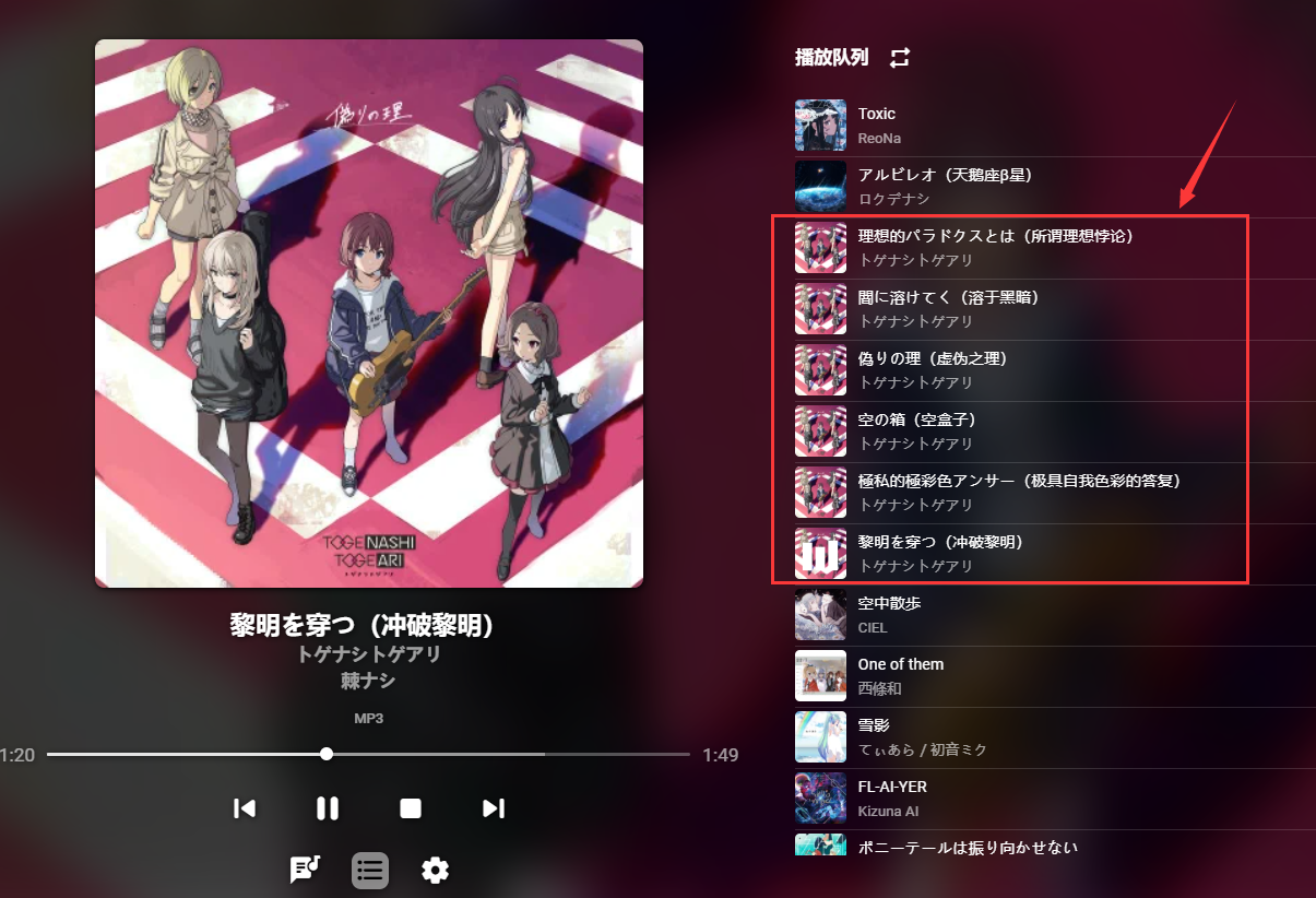

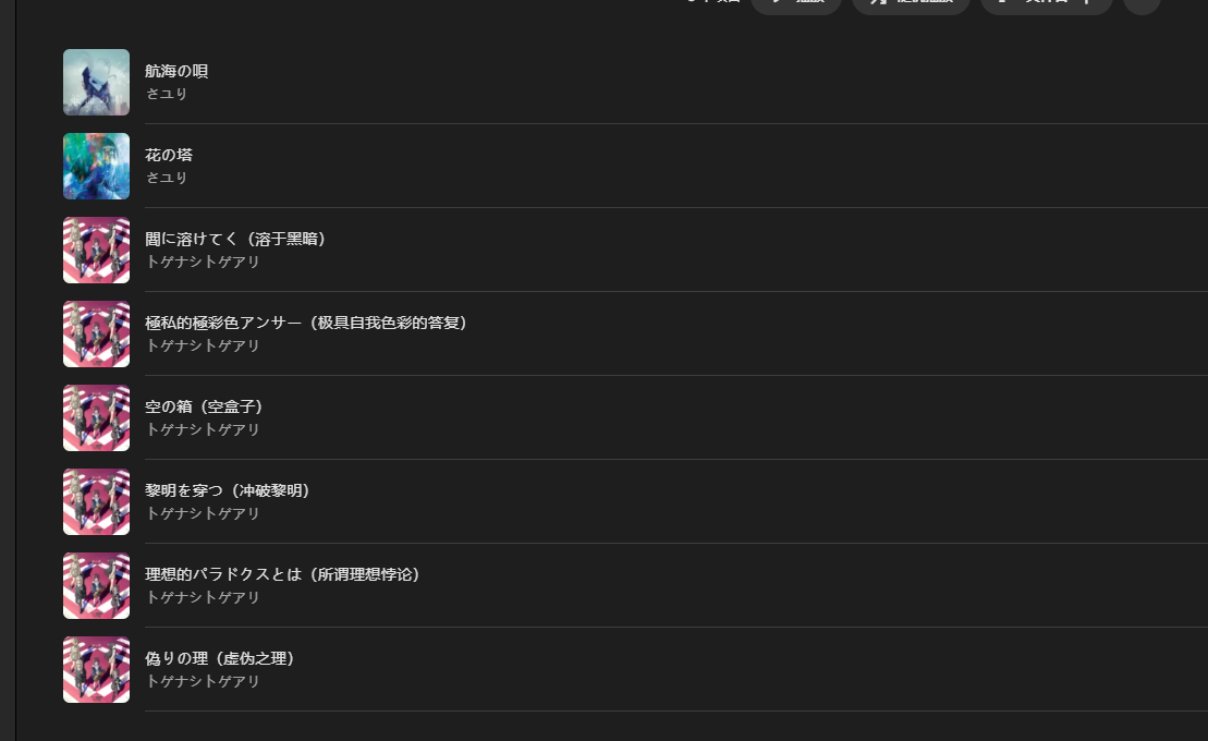

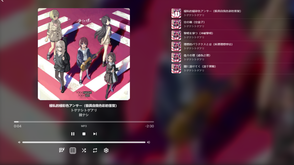

The embedded cover of my audio file is independent, why is there only one display?
HI there, can you please describe your issue in more detail? Thanks.
SmileFlower

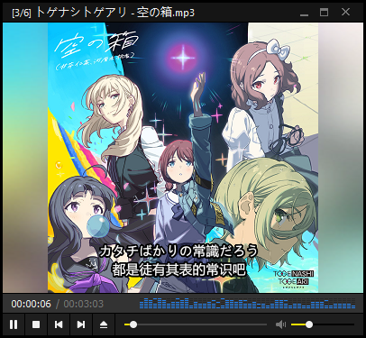

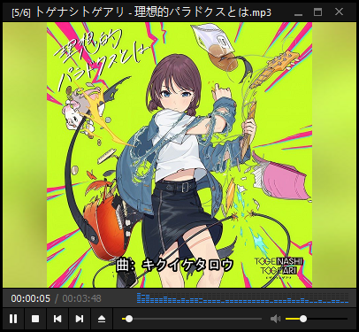

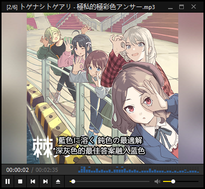

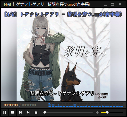

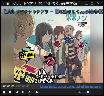

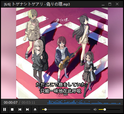

That is, multiple audios have separate covers, but only one cover is displayed.
Below are samples of the audio files I provided. When you open them with potplayer, you can see that each one has its own cover.

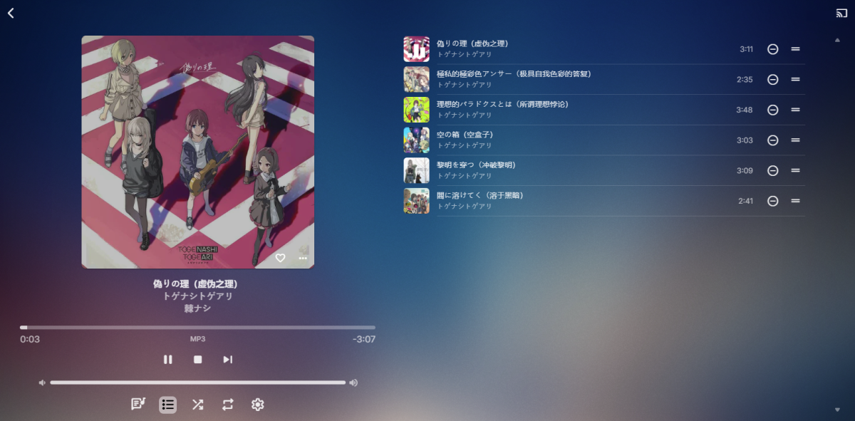

Happy2Play
You mean you don't see this?
If not I would say "ShareEmbeddedMusicAlbumImages": value, correct? @Luke
As mine is false in this test 4.9.0.36

Yes, that's the effect
Happy2Play
Since this option is not expose in the UI yet I believe the only option is changing it via the api for the specific library.  But will wait for dev to confirm.

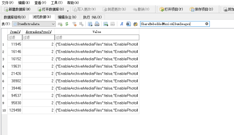

SmileFlower
At present, this problem has been solved by modifying the database, or I hope that the later version can have a setting option switch.

Happy2Play
Yes that is an option also if you wish to edit the database manually.  But yes this option really should be in the UI.
