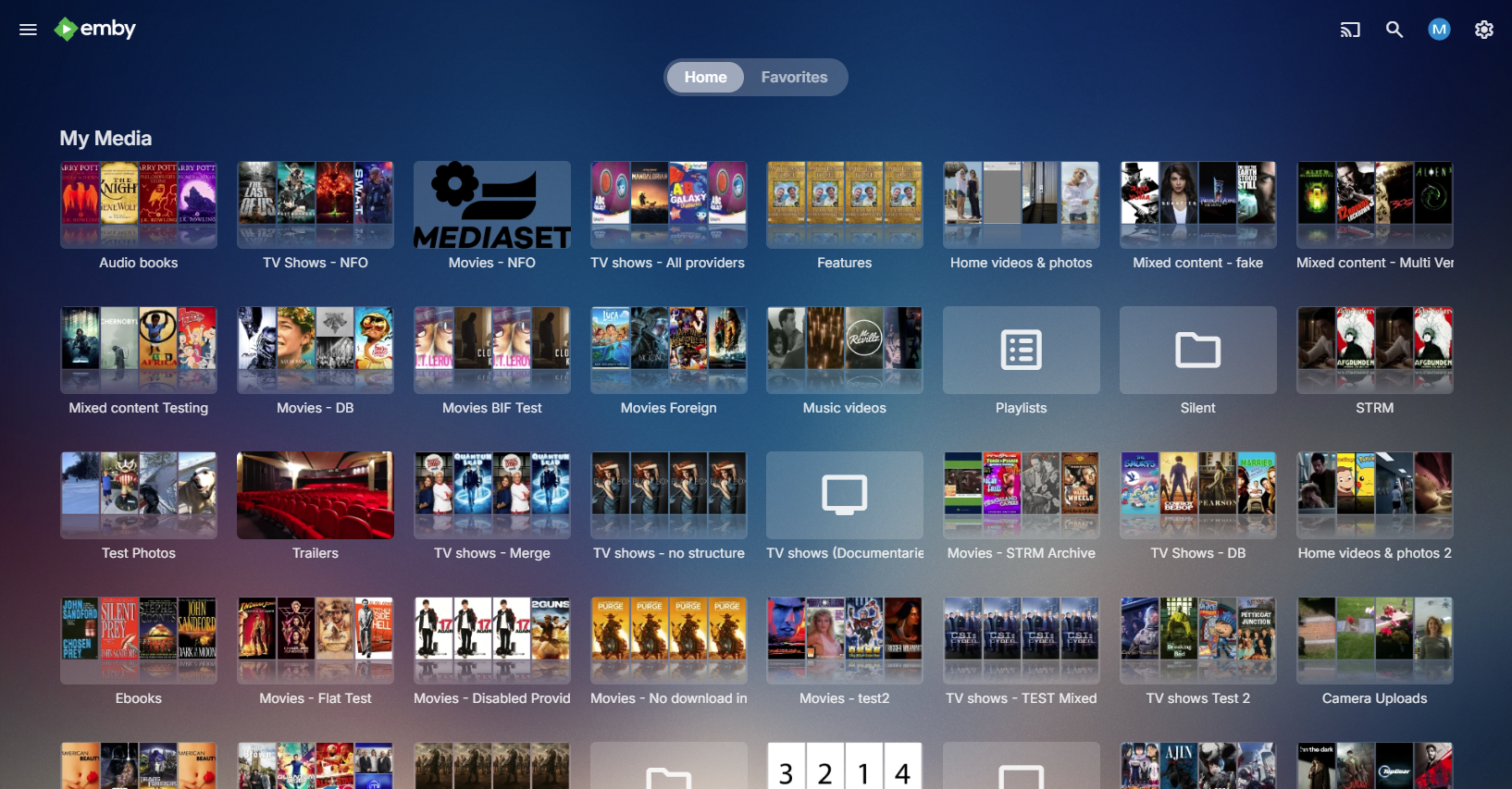

Happy2Play 9811 Posted March 13, 2025 Posted March 13, 2025 8 minutes ago, KMBanana said: Is there an easy way to do the opposite? I only have a few, and it's very annoying if I'm either zoomed in enough or on a narrow enough screen for a single item to overflow into a whole new line is very annoying. Not really as the virtual scroll only appears in specific display modes or touch screen. As by default there should be no scrolling on My Media. Will looks when I get a chance if someone else has not followed up as I don't know all the variables as the image above if I shrink the width it will go to a scroller but my stable versions does not so not sure if there is a number of libraries variable also.

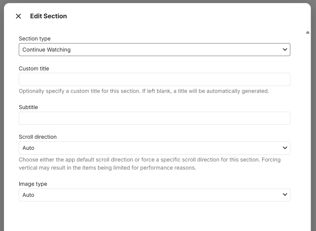

Luke 42237 Posted January 22 Posted January 22 This will be on the beta channel any day now as you'll be able to design your own home sections: 2
