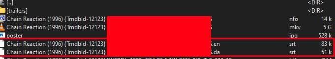

Neminem 1621 Posted January 21, 2025 Posted January 21, 2025 (edited) Since they are subrip you can extract them from you media file, and place them along side to set file. Edited January 21, 2025 by Neminem
Snics 0 Posted January 25, 2025 Author Posted January 25, 2025 (edited) Die habe keine Dateien mit der Endung .srt Edited January 25, 2025 by Snics
