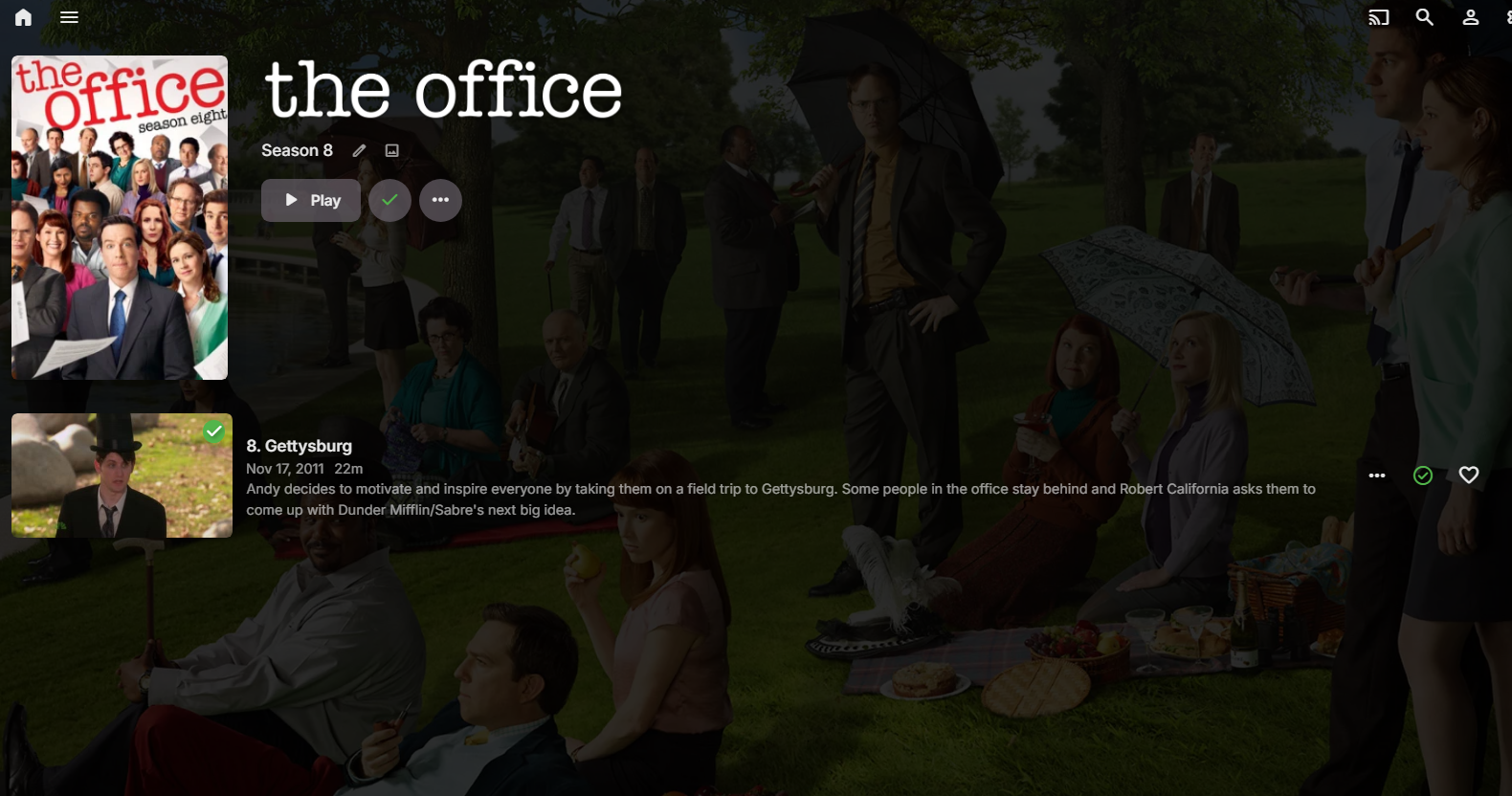

CowmanS77 1 Posted January 18, 2025 Posted January 18, 2025 I have my TV shows organized by name, season, episode. However, some episodes are not showing up in the emby Library. For example, I have all seasons of "The Office" (US version) and all the episodes across all seasons are added to the library fine, with the exception of season 8, only one episode is showing for that season. All the other episodes/files are physically there, but for whatever reason the "scan" doesn't pick them up. Any help?

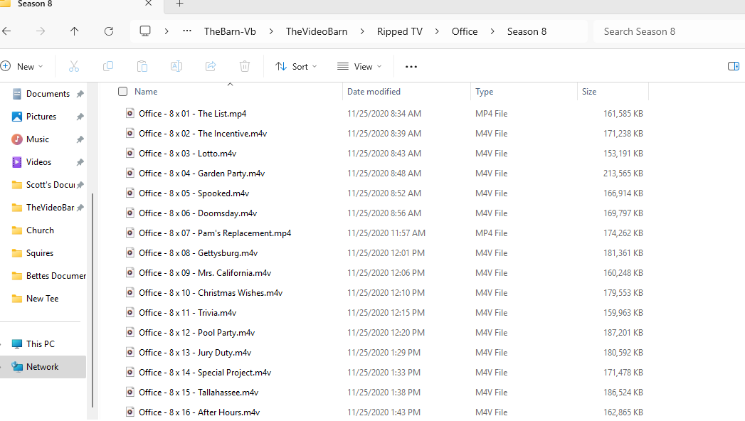

CowmanS77 1 Posted January 18, 2025 Author Posted January 18, 2025 (edited) Here is a screenshot of how they are organized. Actually, one episode from Season 8 does show up, 8X 08 Gettysburg.m4v shows up. Edited January 18, 2025 by CowmanS77
Solution GrimReaper 4896 Posted January 18, 2025 Solution Posted January 18, 2025 (edited) Yeah, dump those spaces around "x" on both sides, i.e. "8x01, 8x02..." etc instead of "8 x 01, 8 x 02..." (or use some other supported naming convention, like S08Exx). Rescan. https://emby.media/support/articles/TV-Naming.html#episode-naming-conventions Edited January 18, 2025 by GrimReaper
CowmanS77 1 Posted January 18, 2025 Author Posted January 18, 2025 That did work for the two test files, so I'll do it for the rest. Thank you for your help. A couple of points/questions: 1. Season 9 has the spaces, and that one mapped just fine? Just crazy 8's? 2. Is there a way to manually add a file? 3. Resync does not work. I have to remove and re-add the library on Synology 4. Thanks again for your help!
GrimReaper 4896 Posted January 18, 2025 Posted January 18, 2025 (edited) 2 hours ago, CowmanS77 said: 1. Season 9 has the spaces, and that one mapped just fine? It actually should have behaved same, all episodes should've been merged into S09E09, as effectively you were telling that to Emby: Quote A number of naming conventions are supported: 02 Episode Name.ext instead of: Quote A number of naming conventions are supported: anything_1x02.ext Why it didn't would require further investigation with exact example and server log(s), if you wanna chase that down. @Luke 2 hours ago, CowmanS77 said: 2. Is there a way to manually add a file? Not sure what do you mean by that. 2 hours ago, CowmanS77 said: 3. Resync does not work. I have to remove and re-add the library on Synology Running Scan media library task should've been sufficient. Again, if you want to try to trace that, post server log from the time of occurrence. How to Report a Problem Edited January 18, 2025 by GrimReaper
