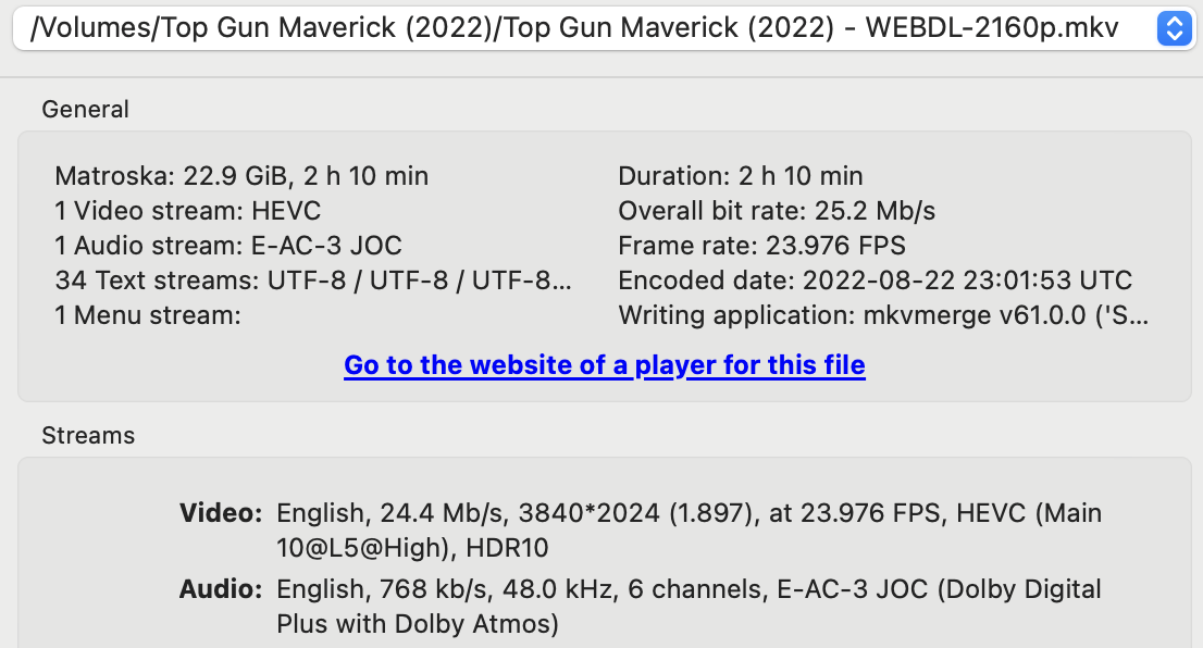

techbri 12 Posted January 30, 2025 Author Posted January 30, 2025 1 hour ago, Luke said: @techbri? Hello, I actually gave up on the shield and returned it along with the Fire TV Cube. As to how it was hooked up, The shield was connected directly to HDMI1 on my TV. The eArc port of the TV connects via HDMI so my Sonos Arc. I am using known good HDMI cables. Attached is the media info on the file I was playing. Note that I can connect my Apple TV to the same cables, use Infuse and play the file and there are no audio dropouts.
