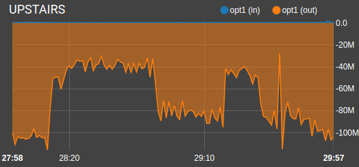

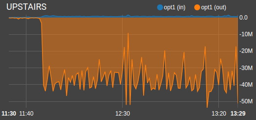

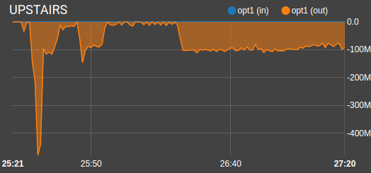

Lessaj 477 Posted January 20, 2025 Posted January 20, 2025 If your emby server is in your local network your internet connection should have nothing to do with it. If it's on a remote site that's a different story. I've tested the file again on the LG app vs the Emby for Android app on my shield - both wifi. This is what the network traffic looks like by comparison between these devices when attempting playback, and again no issue on the shield buffering or playback but the LG app took quite some time to start (as observed). LG: Shield: After letting it play for some time on the shield it kept itself around the 100 Mbit range as show above and then ranged between roughly the bitrate of the media and roughly 2x the rate, but essentially it's requesting data from the server as it needs it and remains buffered without issue.
