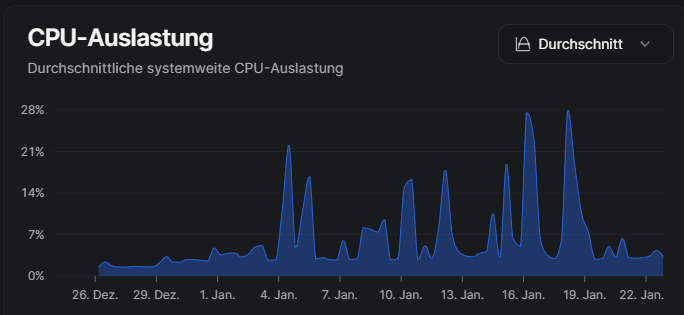

sh0rty 727 Posted January 22, 2025 Posted January 22, 2025 (edited) On 1/17/2025 at 6:02 PM, murky024 said: I picked up the NUC N150 you recommended in a prior post so I will try that out compared to transcoding with the 1070 on the computer. Seems like an inexpensive way to try and offload emby-server from that light gaming system when the 1070 meets the gaming needs my child has but is weaker on the transcoding side. Did exactly that a month ago (but with a N97 in Blackview MP80). Runs rock solid since one month including simultanous Transcoding sessions after I installed the right Intel Graphics Driver version on Windows 11 Pro. Additionally it runs paperless-ngx, an *arr-Stack, audiobookshelf and Romm for retro-gaming in the Browser, all of that in Docker Desktop (17 containers). It does all that without blinking an eye. Edited January 22, 2025 by shorty1483 2
