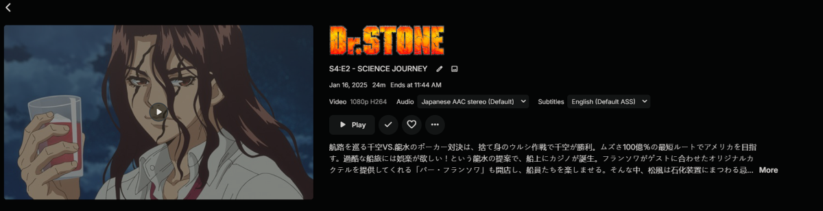

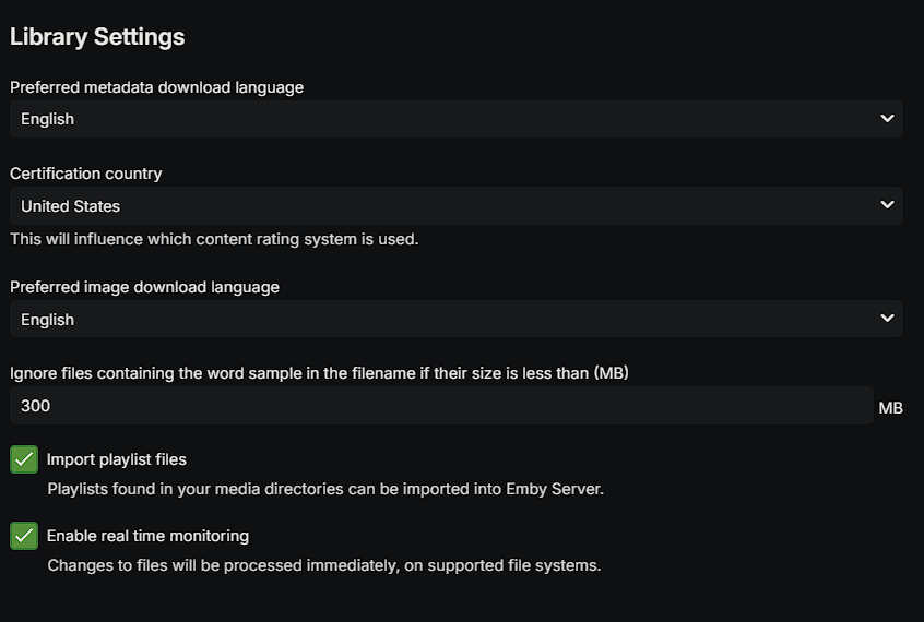

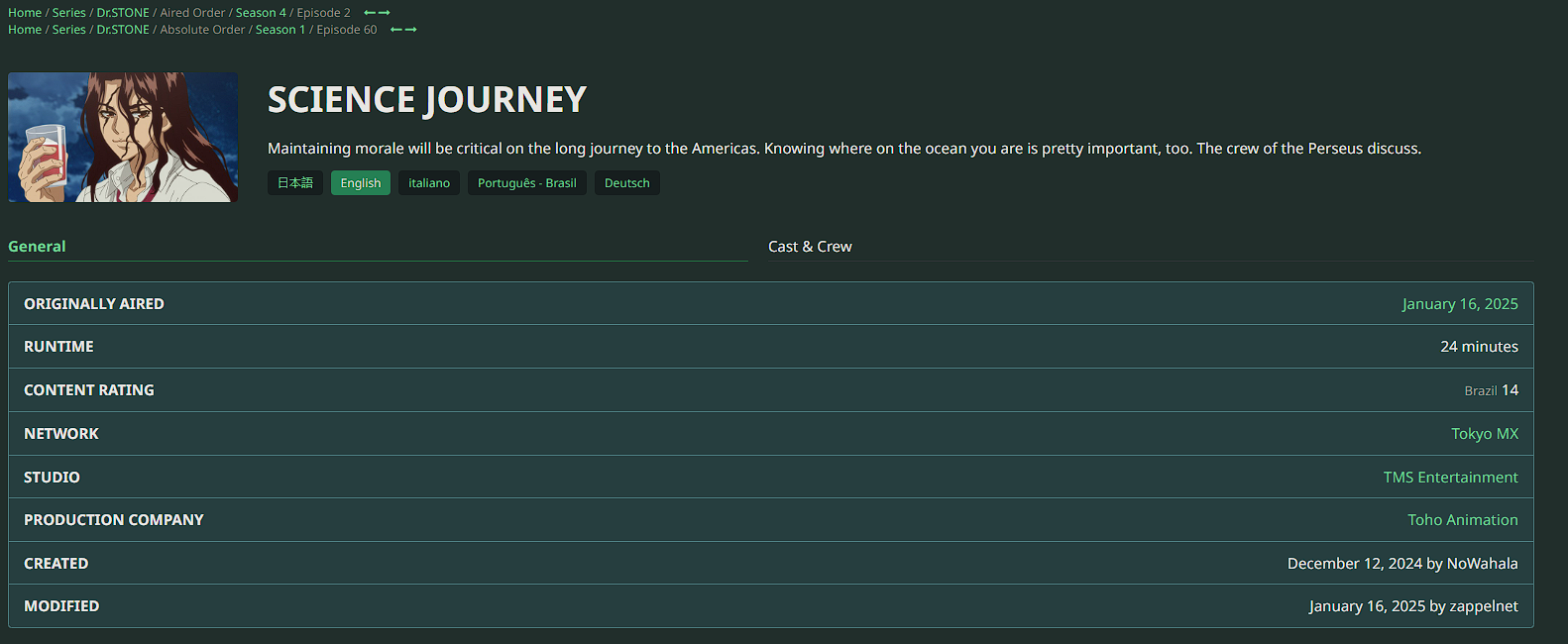

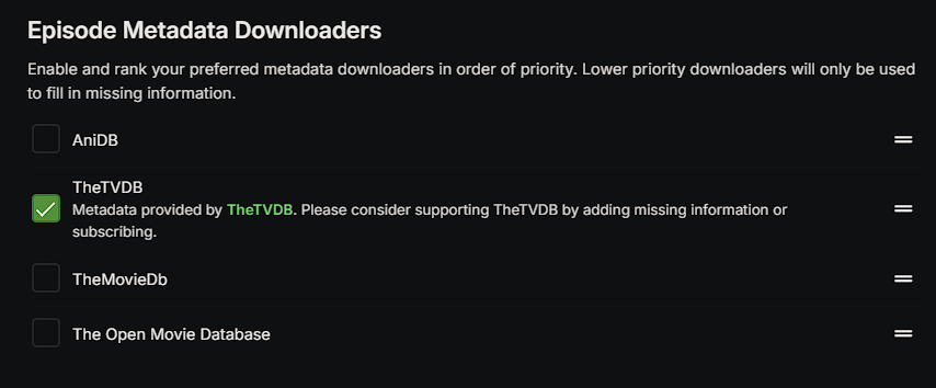

Riptide126 24 Posted January 16, 2025 Posted January 16, 2025 Hello, I am having an issue where the episode description is in the wrong language. I have attached photos of both my settings for the library as far and metadata and one of the episodes in it. I also have attached an image of the episode from TVDB and as you can see the description is available in english. If there is anything else you need from me please let me know, thanks!
Luke 42180 Posted January 16, 2025 Posted January 16, 2025 Hi, please try refreshing the metadata on it, then attach the emby server log. thanks.

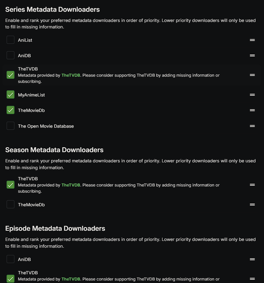

Luke 42180 Posted January 16, 2025 Posted January 16, 2025 What series metadata fetchers are enabled and in what order?

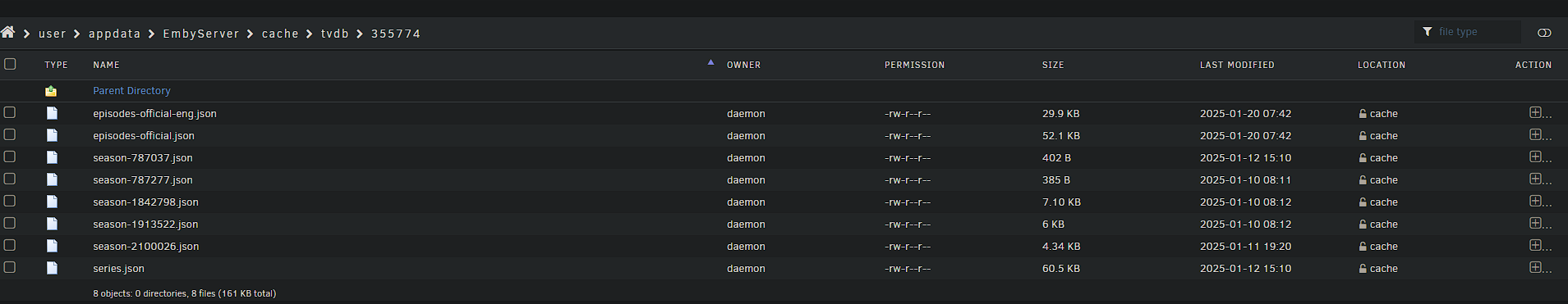

Riptide126 24 Posted January 21, 2025 Author Posted January 21, 2025 I think i found the correct files but I am not sure which one I would delete
Luke 42180 Posted January 21, 2025 Posted January 21, 2025 You can just delete the entire tvdb directory.

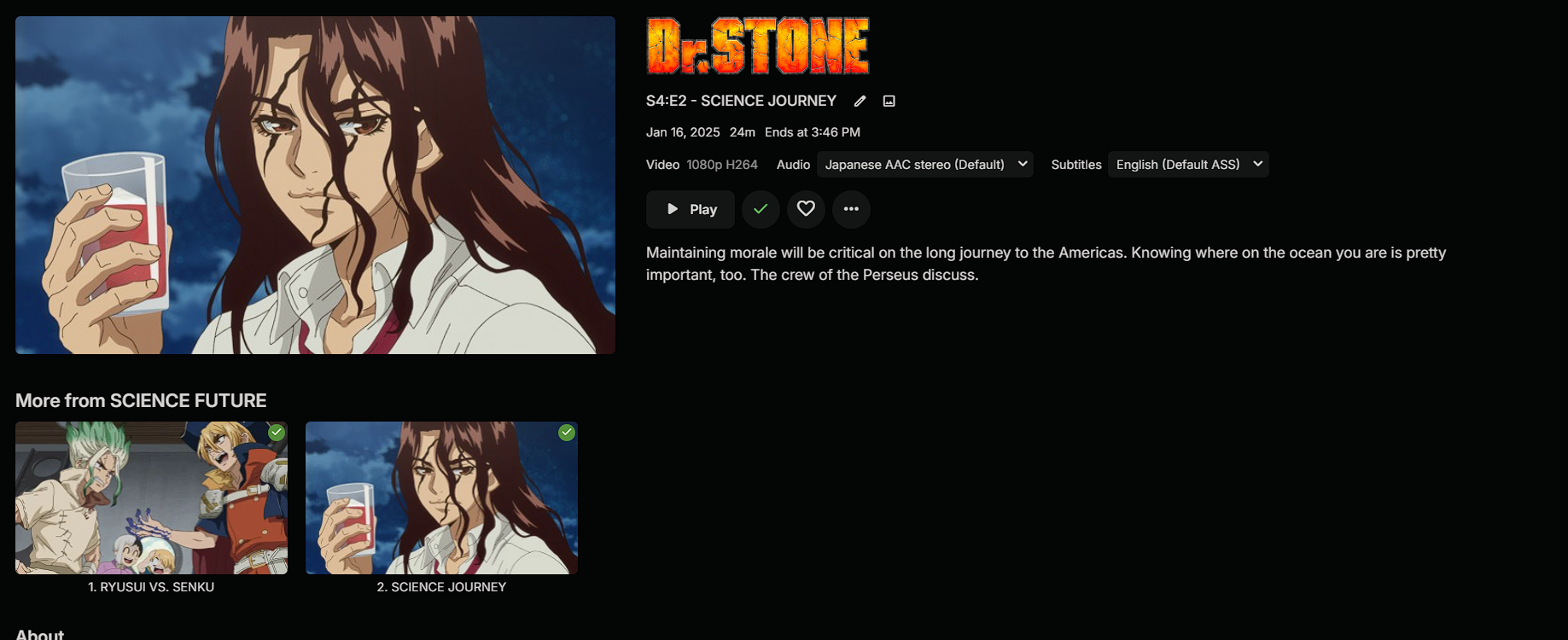

Riptide126 24 Posted January 21, 2025 Author Posted January 21, 2025 Yeah so deleting the cache and then rescanning fixed it 1
