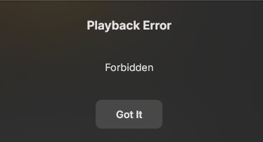

rcutanda 13 Posted January 15, 2025 Posted January 15, 2025 (edited) After a forum search, I have not found any topic I thought relevant for my problem, so I decided to create a new one. I apologise if I missed something. MY SETUP: Emby Server 4.8.10.0 Ubuntu 24.04.1 LTS IPTV stream ERROR: Playback Error Forbidden This error only happens with the IPTV stream. I have another streaming signal from a LinkPi ENC1-V3 device which plays correctly. I get the error both with the full .m3u or with its individual .ts streams. The IPTV signals have been working fine ever since I am using Emby. But I have recently made some important software and hardware changes in my network and now, for the life of me, I am unable to find out what may be wrong. 1. I have been almost two weeks without internet at home because a serious problem with the cables of my previous ISP provider, so I was forced to move to a new ISP. That means I have now a new internet router. 2. I took advantage of that extended downtime to make some changes: I upgraded my server to Ubuntu 24.04. I DID NOT directly upgrade the previous OS but decided to start from scratch formmating the server, so I recovered Emby from my previous backup. 3. I also upgraded my Ethernet network cables and switch from 1Gigabit to 2.5G. As you can see, a lot of changes but I would swear the IPTV has been working for some time after the upgrade. However, I admit I am quite confused and maybe the new setup never worked properly after all the changes. I have attached my server's log, but it is the first time that I do so and I have to admit the logs are quite daunting. There were tons of files and I was not sure what to send, so this is what I have done: 1. Created the backup folder in /var/lib/emby/logs/bk (just in case) and moved there all my logs to make sure I started from scratch and only relevant entries to my error were included. 2. I rotated the logs. 3. Played the IPTV stream. 4. Inmediately dowloaded the only log created (embyserver.txt) with the option "Anonymise log contents" marked. Hopefully, I did it right. Thank you, embyserver.txt Edited January 15, 2025 by rcutanda
rcutanda 13 Posted January 15, 2025 Author Posted January 15, 2025 PS: I would like to add that I have made no changes whatsoever to the IPTV stream. It still plays flawless on other devices using VLC and it has always played correcly on Emby since day one. Thanks.
Luke 42243 Posted January 15, 2025 Posted January 15, 2025 Hi, your provider is rejecting the connection. On the m3u setup screen there is configuration for the user-agent and referer http headers. You may need to use those in order to try and disguise emby server as some other software, like Vlc for example, or the Chrome browser. Of course additionally you could also ask your provider to tell you the exact reason why they are sending back forbidden responses. Please let us know if this helps. Thanks.

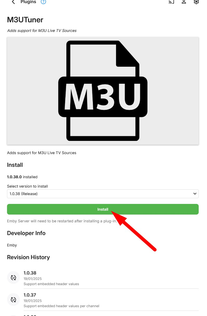

sa2000 697 Posted January 18, 2025 Posted January 18, 2025 @xfitinx@rcutanda M3U TV Tuner 1.0.36 has just been released. If you have got it, please restart the server to pick it up. if not, then restart the server to get it checked for and after it is downloaded as seen in the dashboard, please restart the server againn to complete the installation Please confirm the outcome after updating to 1.0.36

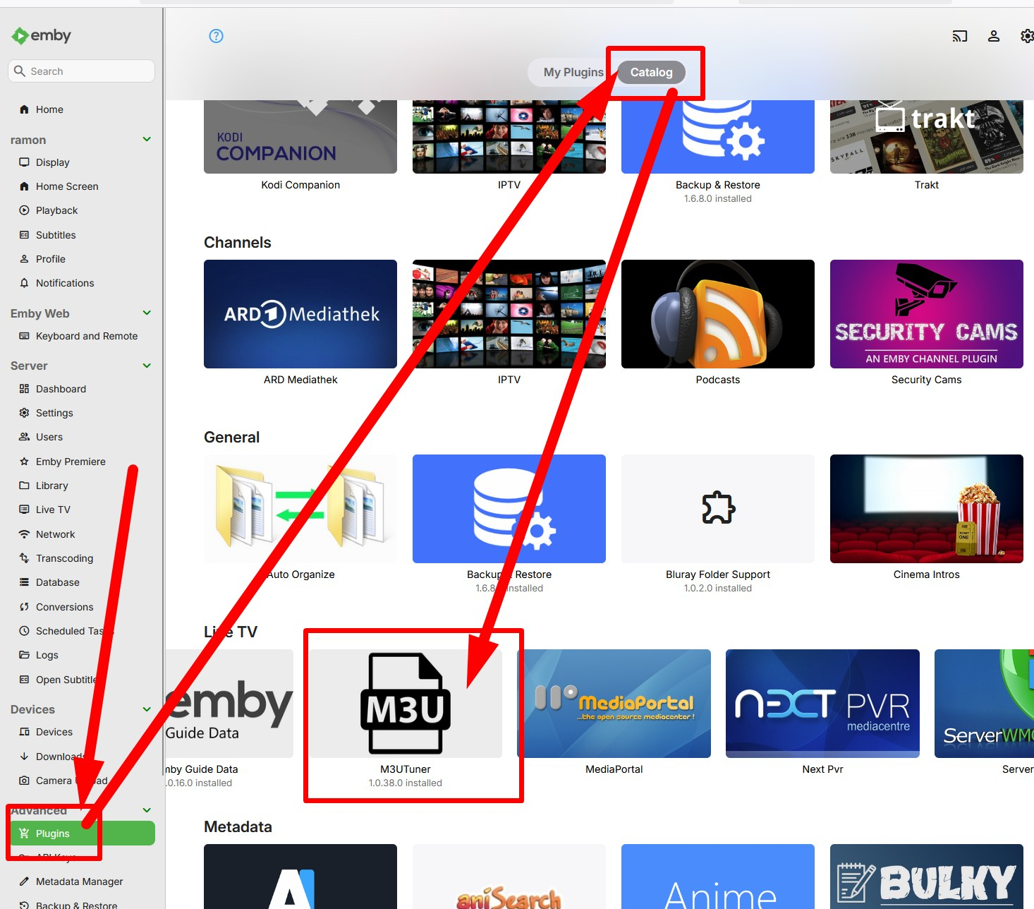

Solution rcutanda 13 Posted January 19, 2025 Author Solution Posted January 19, 2025 M3UTuner 1.0.38 works for me! I have tried it both in my real Ubuntu server and in a Windows Sandbox testing environment. Both works. Great Job, Emby team!

xfitinx 0 Posted January 19, 2025 Posted January 19, 2025 Morning!!!, Good news!!, with the m3u tunner 1.0.38 version, looks like works fine!!.... i`ll test during today.... BR!
