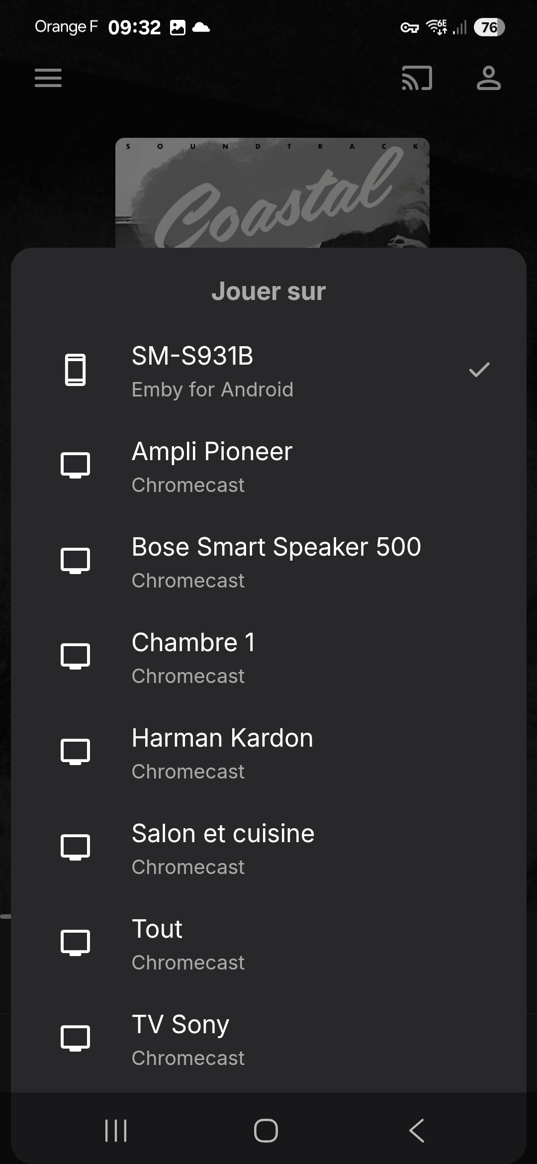

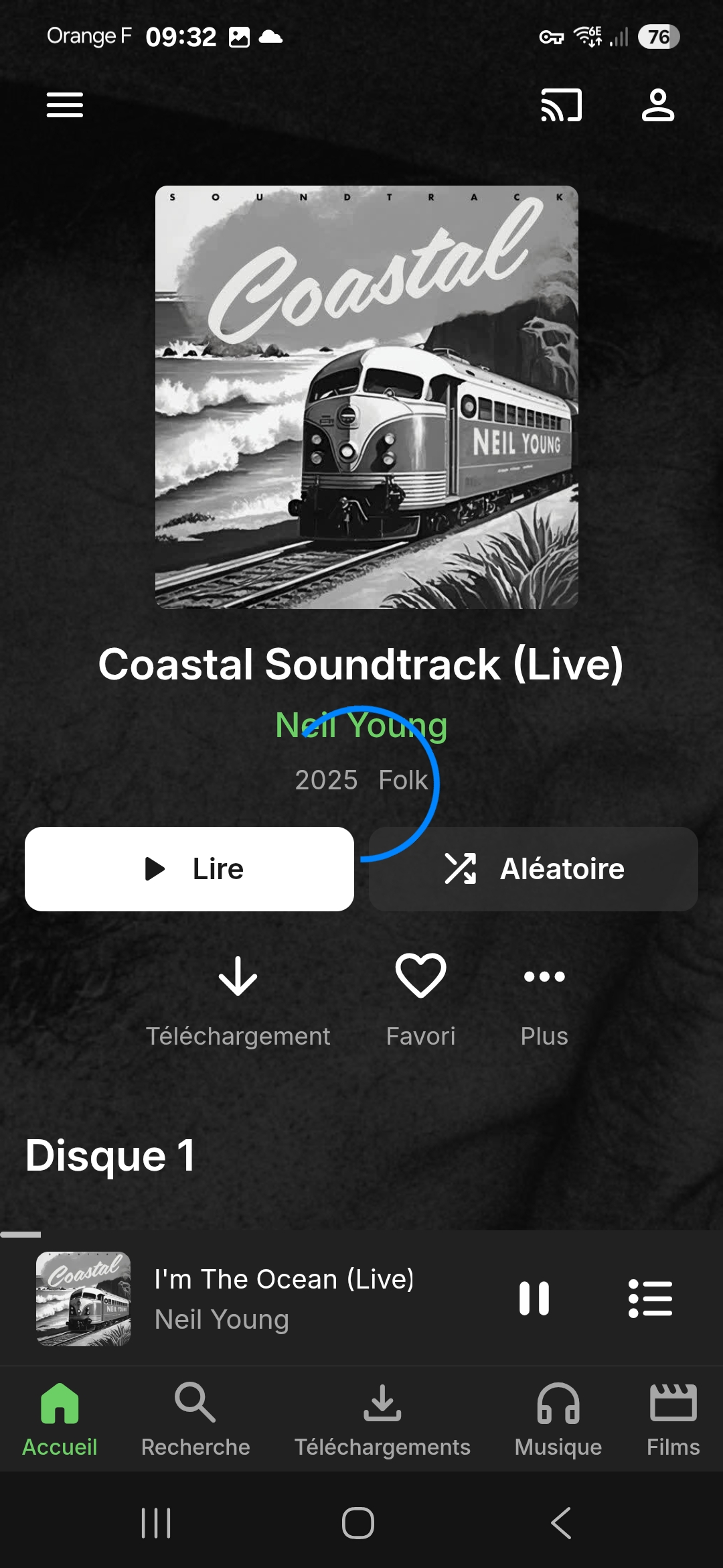

Wolas 1 Posted May 24, 2025 Author Posted May 24, 2025 Here are some screenshots 1. I play some music on my phone 2. I choose to cast it on Pionneer Amp or Bose Smart Speaker 3. The chromecast device wakes up (it has received something) but the music is still playing on the phone and I have a blue circle turning 4. Same thing later the music is played on the phone and the blue circle is still there
