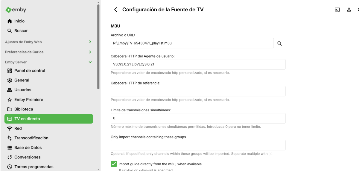

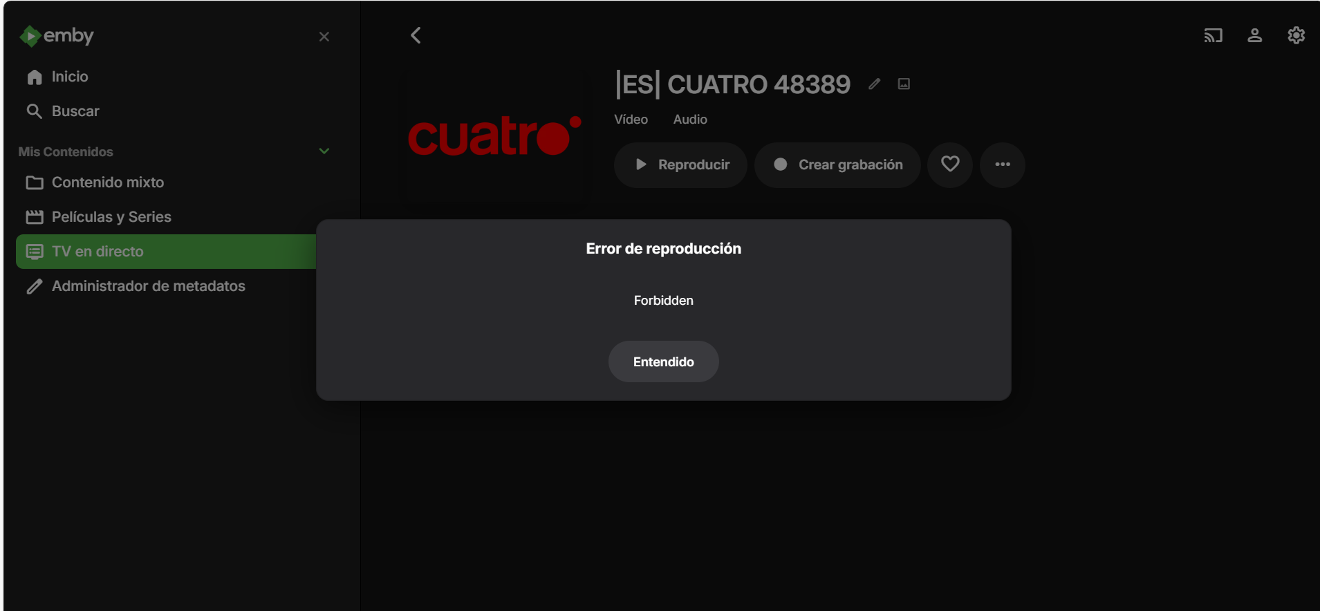

cchavagu 2 Posted December 3, 2025 Posted December 3, 2025 Hello, I've the same problem. My IPTV lis m3u works with all the programs like IPTV smarters and with Emby was working perfect, but yesterday suddenly it stops working and it appears the error of "forbidden". I prove to change the version of the M3uTurner to de 1.038 and it didn't works. I prove with de currenctly version 1.042 to and it didn't works. I prove adding the VLC/3.0.21 LibVLC/3.0.21 and it doesn't works to. My emby server version is 4.9.1.90 I need help please!
sa2000 695 Posted December 3, 2025 Posted December 3, 2025 35 minutes ago, cchavagu said: 've the same problem. My IPTV lis m3u works with all the programs like IPTV smarters and with Emby was working perfect, but yesterday suddenly it stops working and it appears the error of "forbidden". I prove to change the version of the M3uTurner to de 1.038 and it didn't works. I prove with de currenctly version 1.042 to and it didn't works. I prove adding the VLC/3.0.21 LibVLC/3.0.21 and it doesn't works to. If this is working on vlc with the same m3u file, I would suggest using wireshark or tcpdump to look at the http requests and responses and when finding the one the one that gets a 403 forbidden on emby, to look for the same request that goes out when using vlc and then compare the two requests checking the http headers You can use wireshark filters like filter on http to make it easier to view the network requests going out and responses With debug logging enabled on emby server (settings / Logs / settings) you should be able to see details of the request getting a 403 response

cchavagu 2 Posted December 3, 2025 Posted December 3, 2025 Yes in IPTV smarters PRO it works if i upload the file of the m3u and if i paste the url of the m3u. In VLC appears "no se puede reproducir"
sa2000 695 Posted December 3, 2025 Posted December 3, 2025 11 minutes ago, cchavagu said: In VLC appears "no se puede reproducir" In VLC, what happens when you select Media / Open File / R:\Emby\TV-65430471_playlist.m3u 12 minutes ago, cchavagu said: Yes in IPTV smarters PRO it works if i upload the file of the m3u Best to compare the requests using tcpdump or wireshark between emby and IPTV Smarters when specifying the same m3u file

cchavagu 2 Posted December 3, 2025 Posted December 3, 2025 The error that appears in VLC is "Su entrada no puede abrirse:"

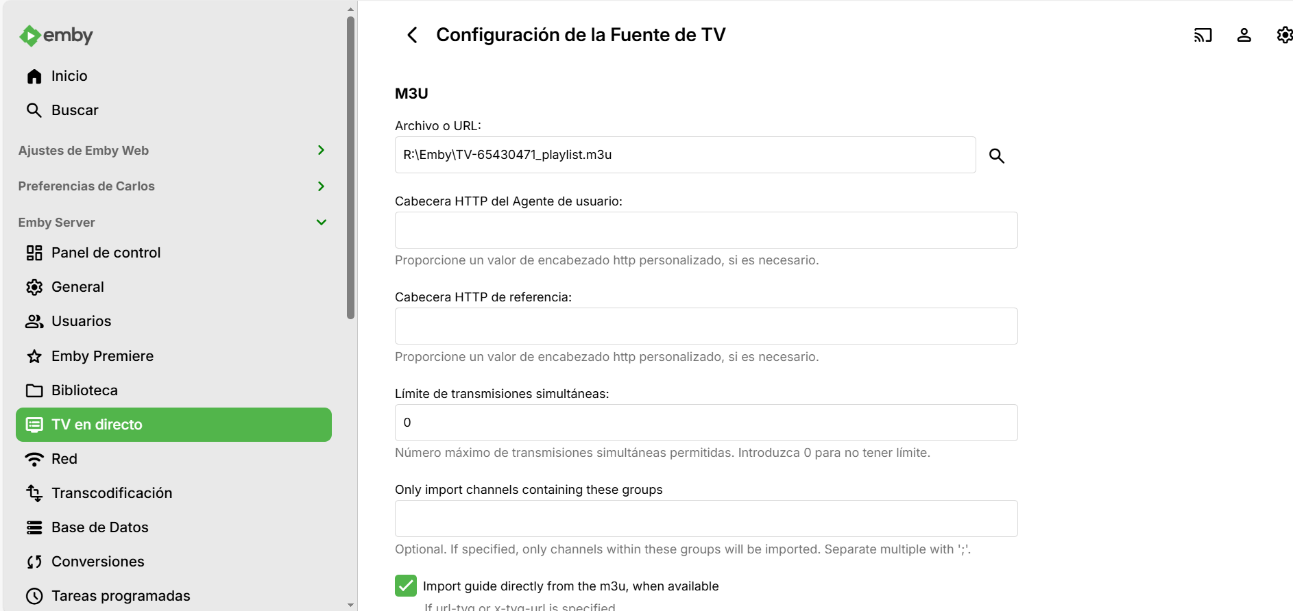

dius 4 Posted December 3, 2025 Posted December 3, 2025 Hi, you need to change the User agents setting and put this: IPTVSmartersPro 2 1
