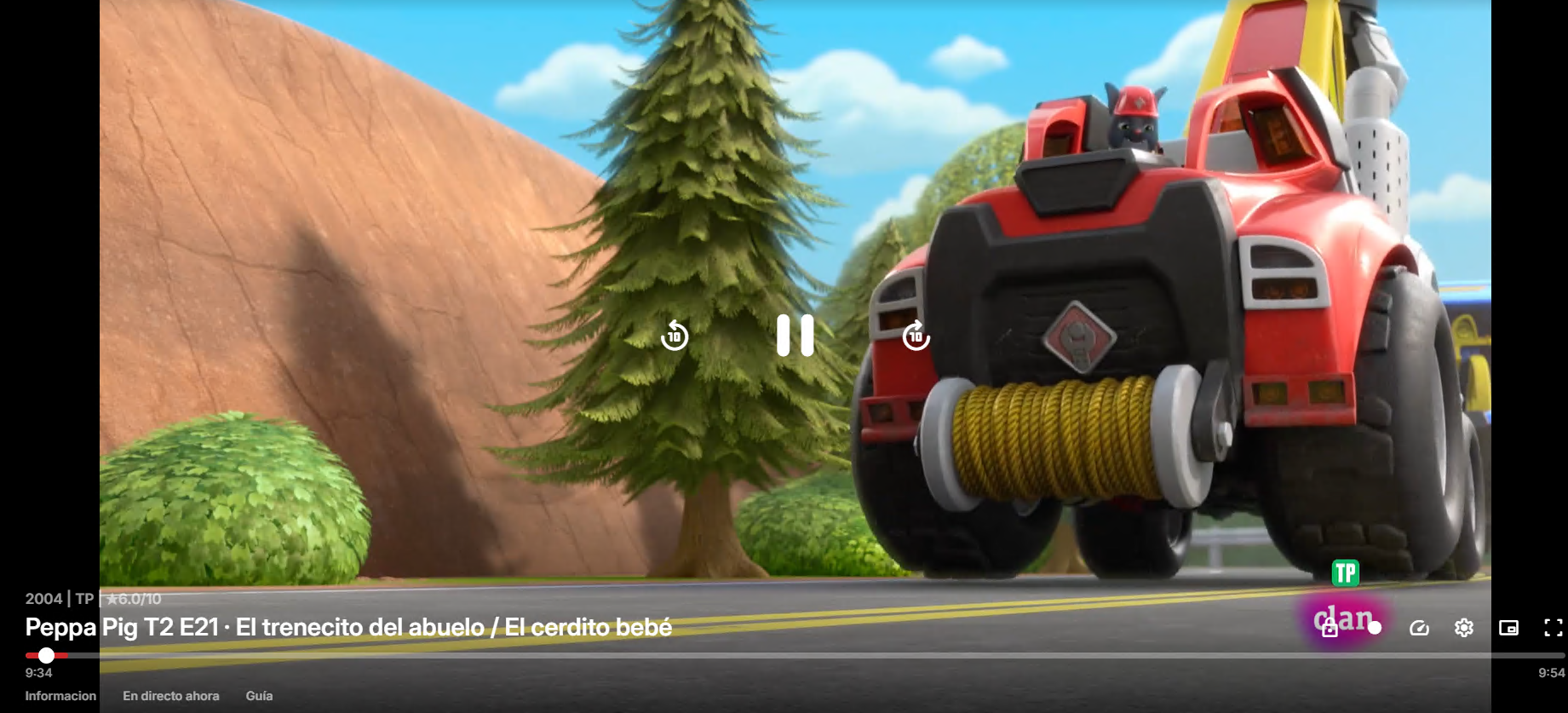

alex553 3 Posted January 18, 2025 Posted January 18, 2025 With the GSE IPTV application from your mobile everything works! The problem is with Emby.

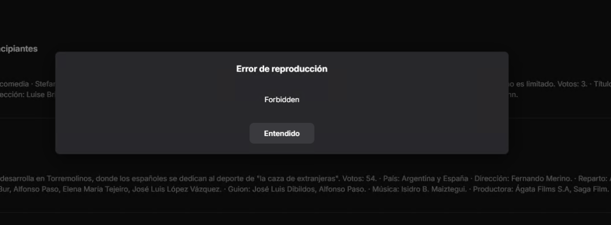

dius 4 Posted January 18, 2025 Posted January 18, 2025 1 hour ago, sa2000 said: @alex553 @dius@vdatanet M3U TV Tuner 1.0.36 has just been released. If you have got it, please restart the server to pick it up. if not, then restart the server to get it checked for and after it is downloaded as seen in the dashboard, please restart the server againn to complete the installation @sk222FYI Hi, I just updated to the new version and rebooted, and I also get the same error: HTTP Response Status [403] Forbidden

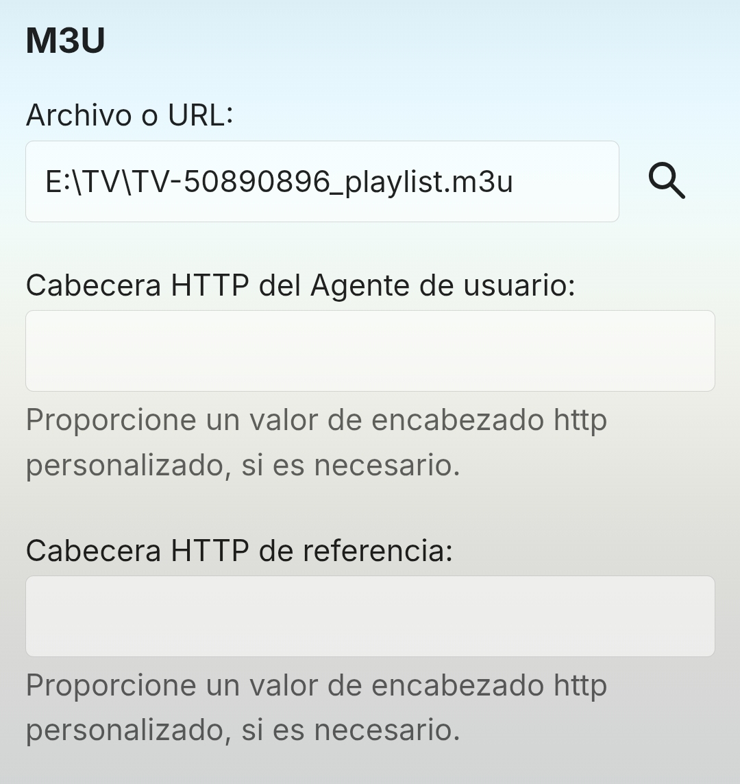

sa2000 695 Posted January 19, 2025 Posted January 19, 2025 1 hour ago, alex553 said: Can't you go back to version 34 settings? Everything was fine there! It stopped working for me on 35 and 36 doesn't work either.... I've tried other apps like vlc, kodi, gse iptv on mobile, I've talked to my iptv provider and they say they haven't changed anything! Need to understand the problem. There may be different issues here for different user configurations. Could you please help getting diagnostics so we understand the issue. I can make 1.0.34 available to you to try. Please tell me what the platform is for your Emby Server and could you provide me details about your m3u setup. The m3u TV Source setup page screenshot in Live TV Setup to see what parameters you have for User Agent and Referer and if on Windows or Mac OS to run wireshark or tcpdump if on linux and capture the http packets and make that available to me privately together with the emby server log from the logs folder. And if you can do http capture also when jusing vlc - you can pass to me all this in a private message through the forum - zipping the pcap file and log.
alex553 3 Posted January 19, 2025 Posted January 19, 2025 (edited) 28 minutes ago, sa2000 said: Es necesario comprender el problema. Puede haber diferentes problemas aquí para diferentes configuraciones de usuario. ¿Podrías ayudarme a obtener diagnósticos para que entendamos el problema? Puedo poner a tu disposición la versión 1.0.34 para que la pruebes. Por favor, dime cuál es la plataforma para tu servidor Emby y ¿podrías proporcionarme detalles sobre tu configuración m3u? Captura de pantalla de la página de configuración de la fuente de TV m3u en la configuración de TV en vivo para ver qué parámetros tienes para el agente de usuario y el referente y, si estás en Windows o Mac OS, para ejecutar Wireshark o tcpdump si Estás en Linux y captura los paquetes http y ponlos a mi disposición de forma privada junto con el registro del servidor Emby desde la carpeta de registros. Y si puedes hacer captura http también cuando solo usas vlc, puedes pasarme todo esto en un mensaje privado a través del foro, comprimiendo el archivo pcap y el registro. Mi configuración es la siguiente siempre funciona bien así cargar la lista m3u y todo lo demás en blanco como se ve en la captura, no soy el único usuario con problemas somos varios, no voy a poner registros de mi red por temas de seguridad, uso Emby en un Intel nuc con Windows 10 desde hace unos 6 años todo genial hasta este momento claro, uso licencia de por vida. En cualquier aplicacion para IPTV que cargo la lista m3u funciona correctamente , ustedes cambiaron algo de la versión 34 a las demás es fácil vuelvan a dejarlo como estaba antes es muy fácil de solucionar no entiendo por qué se está tardando tanto si es solo volver atras , ahora mismo Emby está roto para visualizar IPTV y está es una característica estrella de Emby precisamente. Un saludo. Edited January 19, 2025 by alex553

sa2000 695 Posted January 19, 2025 Posted January 19, 2025 (edited) 53 minutes ago, alex553 said: Mi configuración es la siguiente siempre funciona bien así cargar la lista m3u y todo lo demás en blanco como se ve en la captura, no soy el único usuario con problemas somos varios, Thanks @dius@vdatanet@TeraMan Are you also using default settings for User Agent and Referer/Referrer ? Edited January 19, 2025 by sa2000
vdatanet 1619 Posted January 19, 2025 Posted January 19, 2025 4 hours ago, sa2000 said: Are you also using default settings for User Agent and Referer/Referrer ? Yes
dius 4 Posted January 19, 2025 Posted January 19, 2025 5 hours ago, sa2000 said: Thanks @dius@vdatanet@TeraMan Are you also using default settings for User Agent and Referer/Referrer ? Yes, and it also worked for me in version 34. In 35 and 36 it doesn't work for me, it gives me the forbidden error.
vdatanet 1619 Posted January 19, 2025 Posted January 19, 2025 I've noticed that this error only occurs when transcoding is required. Using the Apple TV app with the MPV player selected, playback works.

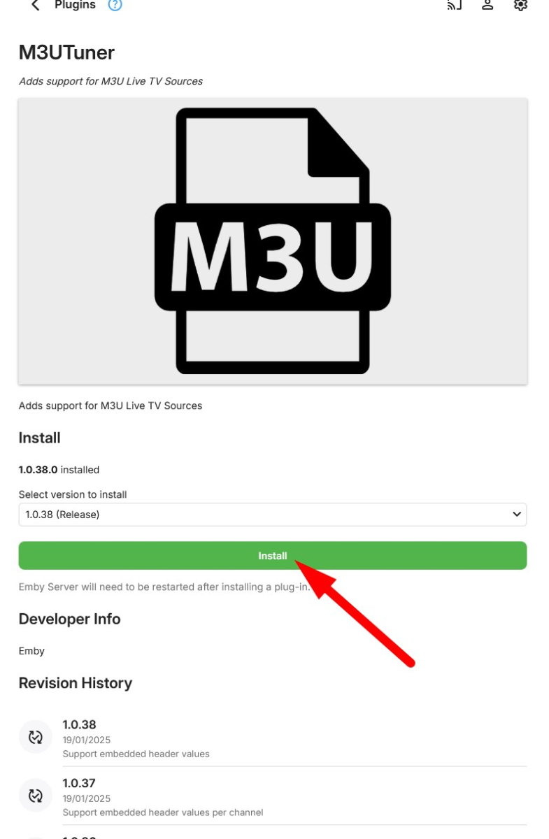

dius 4 Posted January 19, 2025 Posted January 19, 2025 Hi, I just installed version 1.0.38 and I restarted the server and I have the same problem. Can I install 1.0.34 to see if the problem is corrected?
rcutanda 13 Posted January 19, 2025 Posted January 19, 2025 M3UTuner 1.0.38 works for me! I have tried it both in my real Ubuntu server and in a Windows Sandbox testing environment. Both works. Great Job, Emby team!

rcutanda 13 Posted January 19, 2025 Posted January 19, 2025 (edited) 1 hour ago, dius said: Hi, I just installed version 1.0.38 and I restarted the server and I have the same problem. Can I install 1.0.34 to see if the problem is corrected? Following sa2000 advice I have just made the following tests with and without the following User agent HTTP header: VLC/3.0.21 LibVLC/3.0.21 1.0.31 with No headers → Does NOT work 1.0.31 with headers → DOES work 1.0.35 with No headers → Does NOT work 1.0.35 with headers → DOES work 1.0.38 with No headers → DOES work 1.0.38 with headers → DOES work If you are still having problems 1.0.38, try this user agent HTTP header: VLC/3.0.21 LibVLC/3.0.21 Edited January 19, 2025 by rcutanda 1 1
sa2000 695 Posted January 19, 2025 Posted January 19, 2025 Thanks. We have now changed the default User-Agent HTTP header - so the problems that affected users were two separate causes - one the User-Agent and the other related to the Referrer spelling change where some providers needed to see Referrer rather than Referer - we now send both. 2
