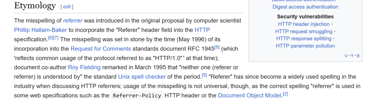

sa2000 696 Posted January 13, 2025 Posted January 13, 2025 @Luke some history info on wikipedia on this web page
sa2000 696 Posted January 13, 2025 Posted January 13, 2025 1 hour ago, sk222 said: Could you verify whether the M3U TV Tuner plugin sends the referrer header correctly as "Referer" (as misspelled by the HTTP spec) and not "Referrer" It is using Referrer I am discussing this with @Luke

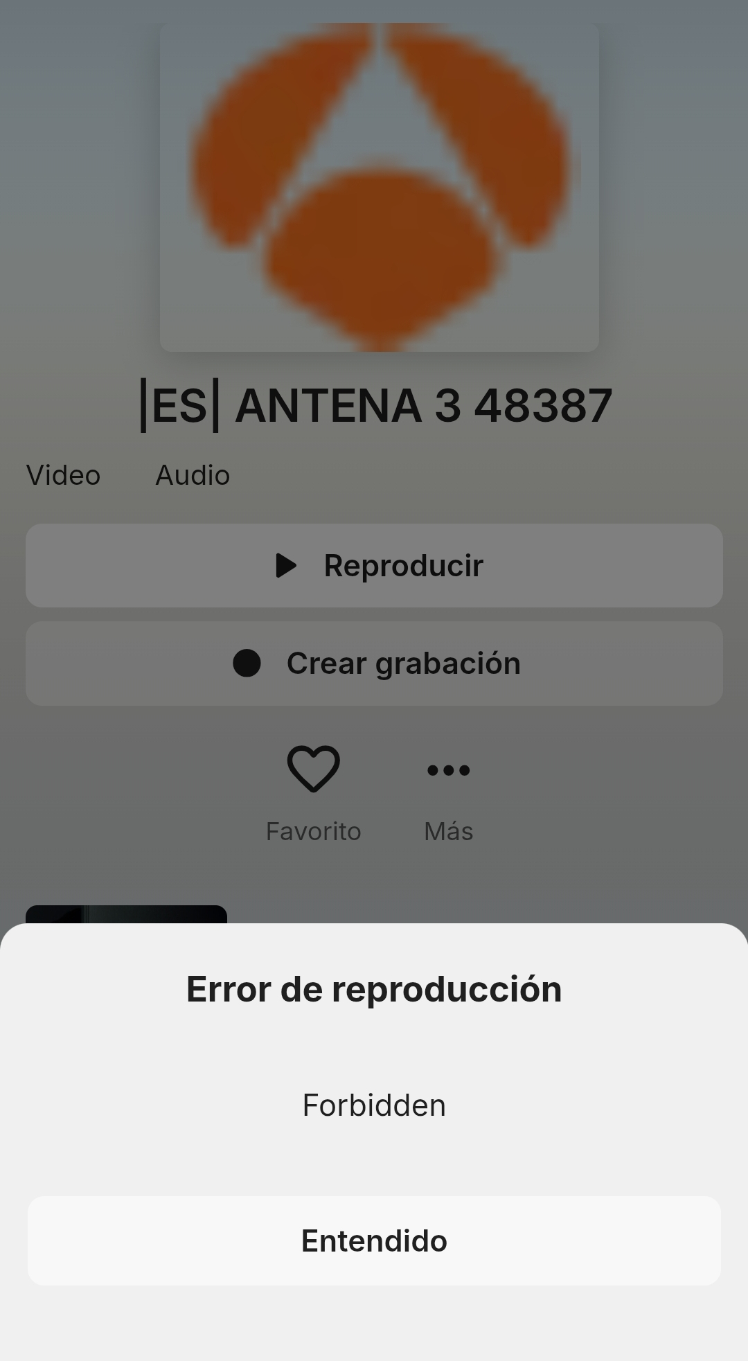

alex553 3 Posted January 18, 2025 Posted January 18, 2025 I have the same problem and everything was fine before, this must be solved for me, it is very important to enjoy my IPTV and now it says forbidden! Use el traductor , soy español use Emby desde hace más de 6 años , necesito que se corrija este error por favor hace días que no puedo ver mi IPTV!

alex553 3 Posted January 18, 2025 Posted January 18, 2025 (edited) error right now the forbidden error no longer appears now that error appears ... Edited January 18, 2025 by alex553
sa2000 696 Posted January 18, 2025 Posted January 18, 2025 @alex553 @dius@vdatanet M3U TV Tuner 1.0.36 has just been released. If you have got it, please restart the server to pick it up. if not, then restart the server to get it checked for and after it is downloaded as seen in the dashboard, please restart the server againn to complete the installation @sk222FYI
alex553 3 Posted January 18, 2025 Posted January 18, 2025 (edited) 17 minutes ago, sa2000 said: @alex553 @dius@vdatanet M3U TV Tuner 1.0.36 has just been released. If you have got it, please restart the server to pick it up. if not, then restart the server to get it checked for and after it is downloaded as seen in the dashboard, please restart the server againn to complete the installation @sk222FYI New versión error FORBBIDEN! Edited January 18, 2025 by alex553 1
