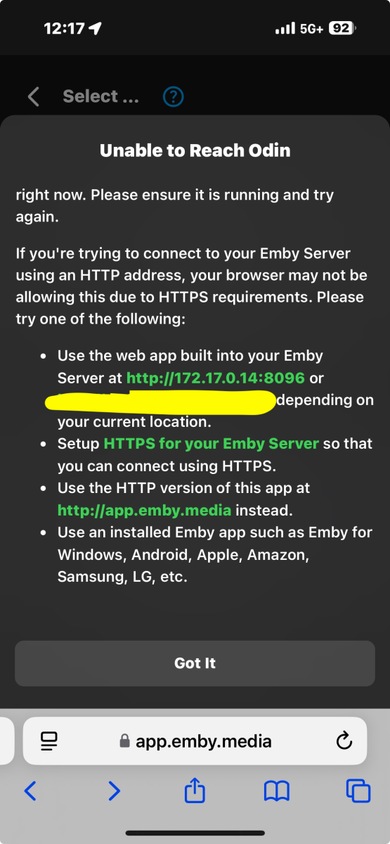

simonmason 19 Posted January 11, 2025 Author Posted January 11, 2025 (edited) Following on to this I was playing around with the emby connect forgotten password which I think is the preferred method for a user to handle this? When going though that process as a test I landed on this screen (below) - which again is showing an internal IP. Also I am about to shutoff the http port so need to figure out where this is coming from and display my https port. Have checked through the configuration but haven't gotten to the bottom of this yet. Edited January 11, 2025 by simonmason

Lessaj 613 Posted January 11, 2025 Posted January 11, 2025 (edited) 1 hour ago, simonmason said: Following on to this I was playing around with the emby connect forgotten password which I think is the preferred method for a user to handle this? When going though that process as a test I landed on this screen (below) - which again is showing an internal IP. Also I am about to shutoff the http port so need to figure out where this is coming from and display my https port. Have checked through the configuration but haven't gotten to the bottom of this yet. It looks like you tried to use the HTTPS emby connect and not the HTTP emby connect, so you'll need to finish setting up HTTPS and then you shouldn't see that. Browsers are often redirecting to HTTPS automatically now so even if you started the process on the HTTP page it may have redirected at some point. Also you should probably remove that screenshot because it has your domain, or an admin can do it for you. Edited January 11, 2025 by Lessaj
simonmason 19 Posted January 11, 2025 Author Posted January 11, 2025 16 minutes ago, Lessaj said: It looks like you tried to use the HTTPS emby connect and not the HTTP emby connect, so you'll need to finish setting up HTTPS and then you shouldn't see that. Browsers are often redirecting to HTTPS automatically now so even if you started the process on the HTTP page it may have redirected at some point. Also you should probably remove that screenshot because it has your domain, or an admin can do it for you. Thanks - domain blinded. Luckily I have followed all of the security recommendations and don't have an admin account and my admin user is well hidden, etc. I thought I had https setup correctly. I am using NGINX Proxy Manager so I didn't follow the Emby instructions exactly. My Emby server does work on my external https port. And I have the emby server Network configuration setup with the correct ports. Where is app.emby.media getting these links?

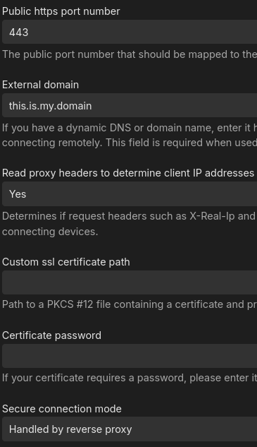

Lessaj 613 Posted January 11, 2025 Posted January 11, 2025 (edited) It gets them from your dashboard so make sure you've set your public ports correctly in the Network tab and set Secure Connection Mode to handled by a reverse proxy. You can continue to use HTTP within your LAN if you want, and even use HTTP from nginx to the emby server, you just need to tell emby what you're going to use as your external port and domain so that it can map it for emby connect. Edited January 11, 2025 by Lessaj 1
simonmason 19 Posted January 11, 2025 Author Posted January 11, 2025 5 minutes ago, Lessaj said: It gets them from your dashboard so make sure you've set your public ports correctly in the Network tab and set Secure Connection Mode to handled by a reverse proxy. You can continue to use HTTP within your LAN if you want, and even use HTTP from nginx to the emby server, you just need to tell emby what you're going to use as your external port and domain so that it can map it for emby connect. Thanks for sticking with this. When I look at the dashboard I only see an internal external http. I don't see any reference to https. When I try to access emby on the local lan with the 8920 response using https I don't get anything. Does the https server need to be turned on somehow?
Lessaj 613 Posted January 11, 2025 Posted January 11, 2025 No you shouldn't specifically need to configure https on the emby side for this. I just tried on a test system, I set my public https port to 443 and set my domain and set the connection mode to handled by reverse proxy and the remote access address is now my https domain. I did not set up https on emby.

Solution simonmason 19 Posted January 11, 2025 Author Solution Posted January 11, 2025 11 minutes ago, Lessaj said: No you shouldn't specifically need to configure https on the emby side for this. I just tried on a test system, I set my public https port to 443 and set my domain and set the connection mode to handled by reverse proxy and the remote access address is now my https domain. I did not set up https on emby. Thanks - Secure connection mode was set to preferred and not handled by reverse proxy. Changing that updated the dashboard to show my correct https external server address and port. 1 1
