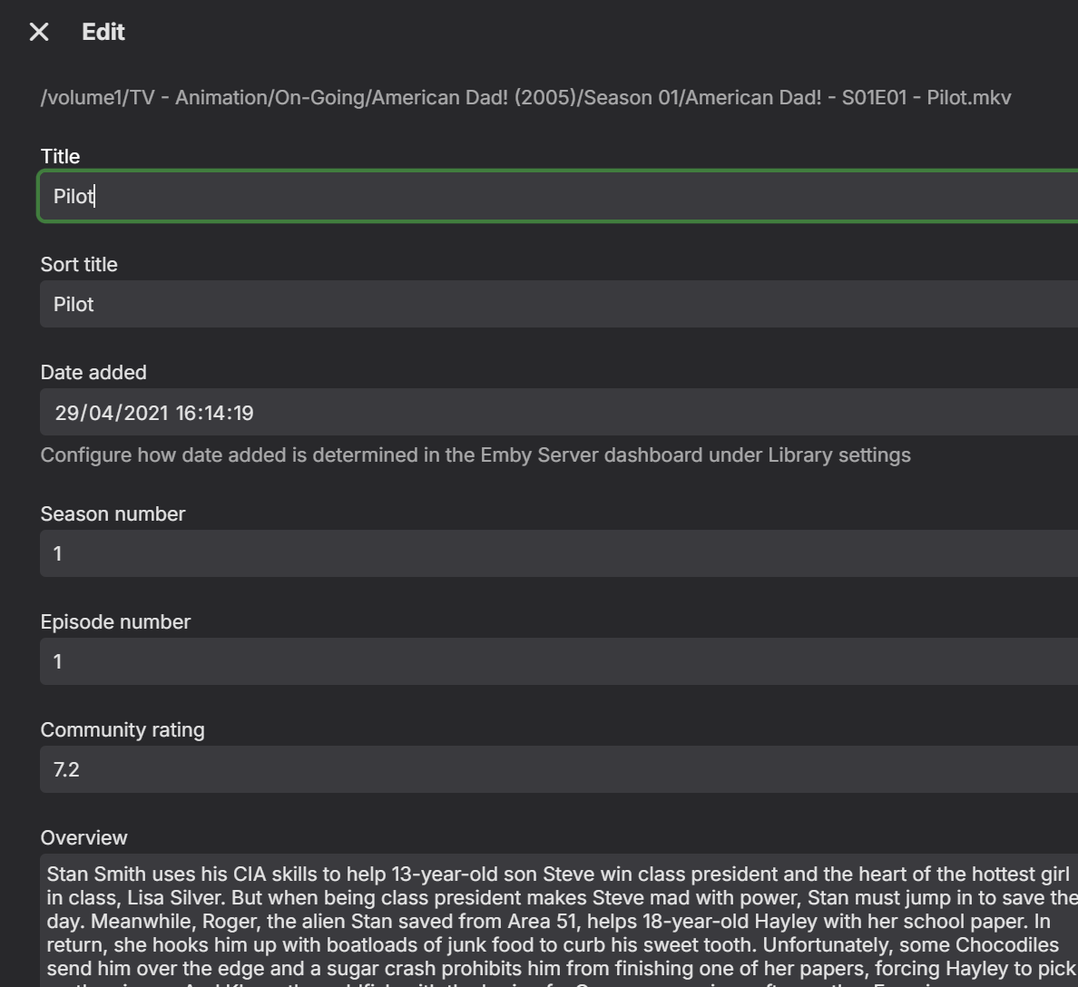

TeresaJane 0 Posted January 11, 2025 Posted January 11, 2025 Ive noticed an issue with any tv series that go over 9 seasons once it gets to 10 it starts merging 10+ specials, 11+1 ,12+2, im at a loss as to what might be causing this I manage my metadata with Tiny Media Manager, ive confirmed everything is correct n TMM + the nfo file and using emby metadata manager i can see that shows are listed correctly as season 1 and season 11 but its still merging, can anyone assist??

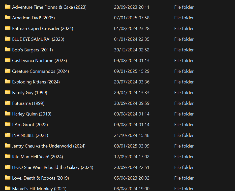

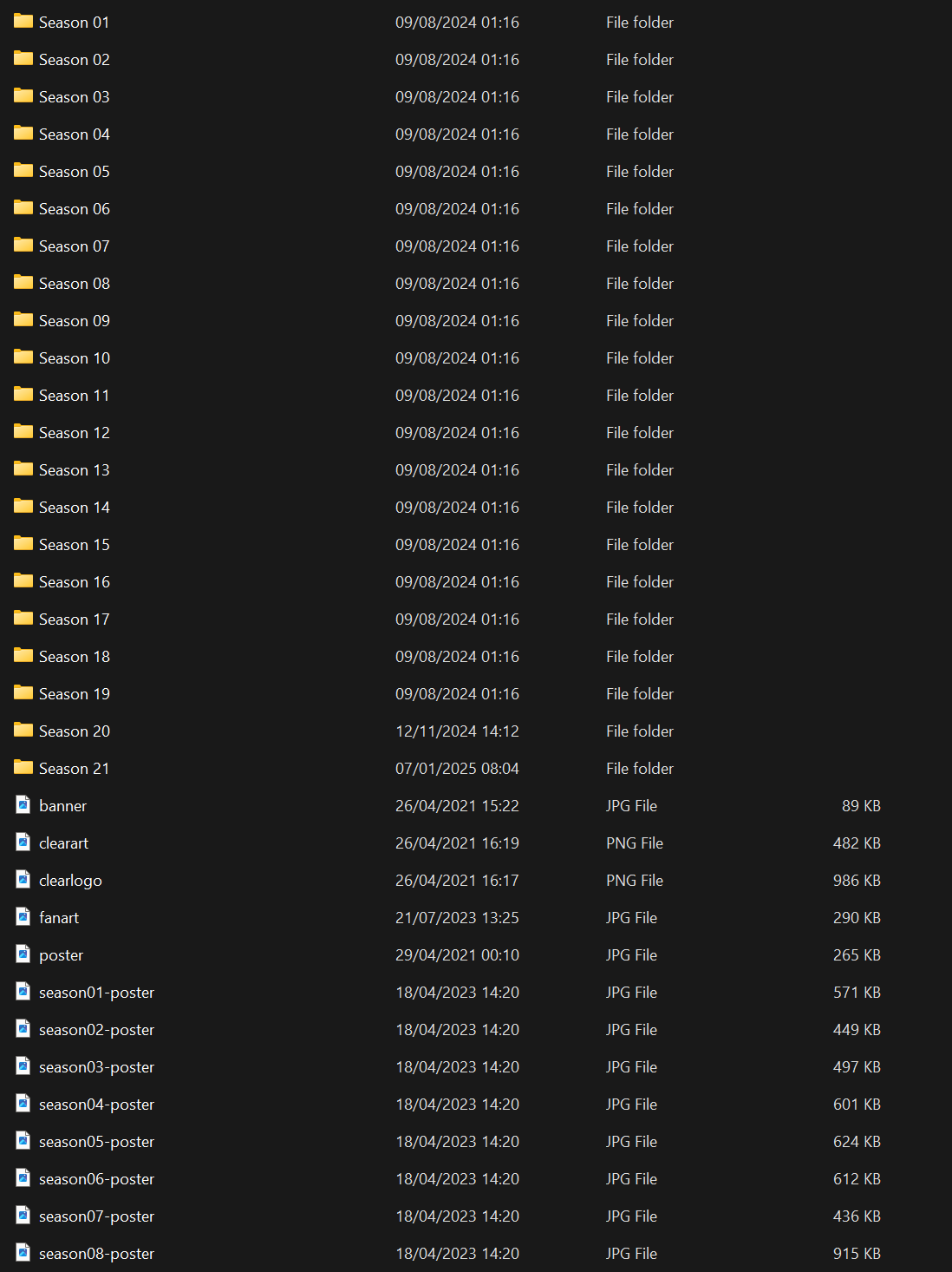

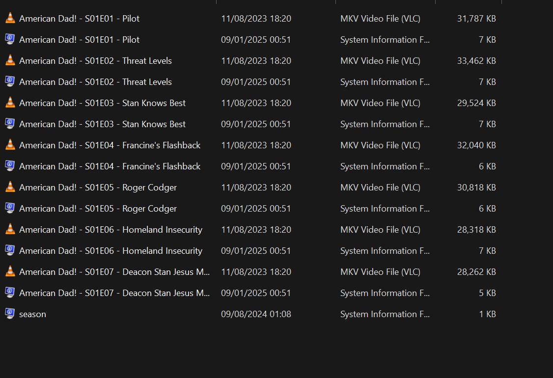

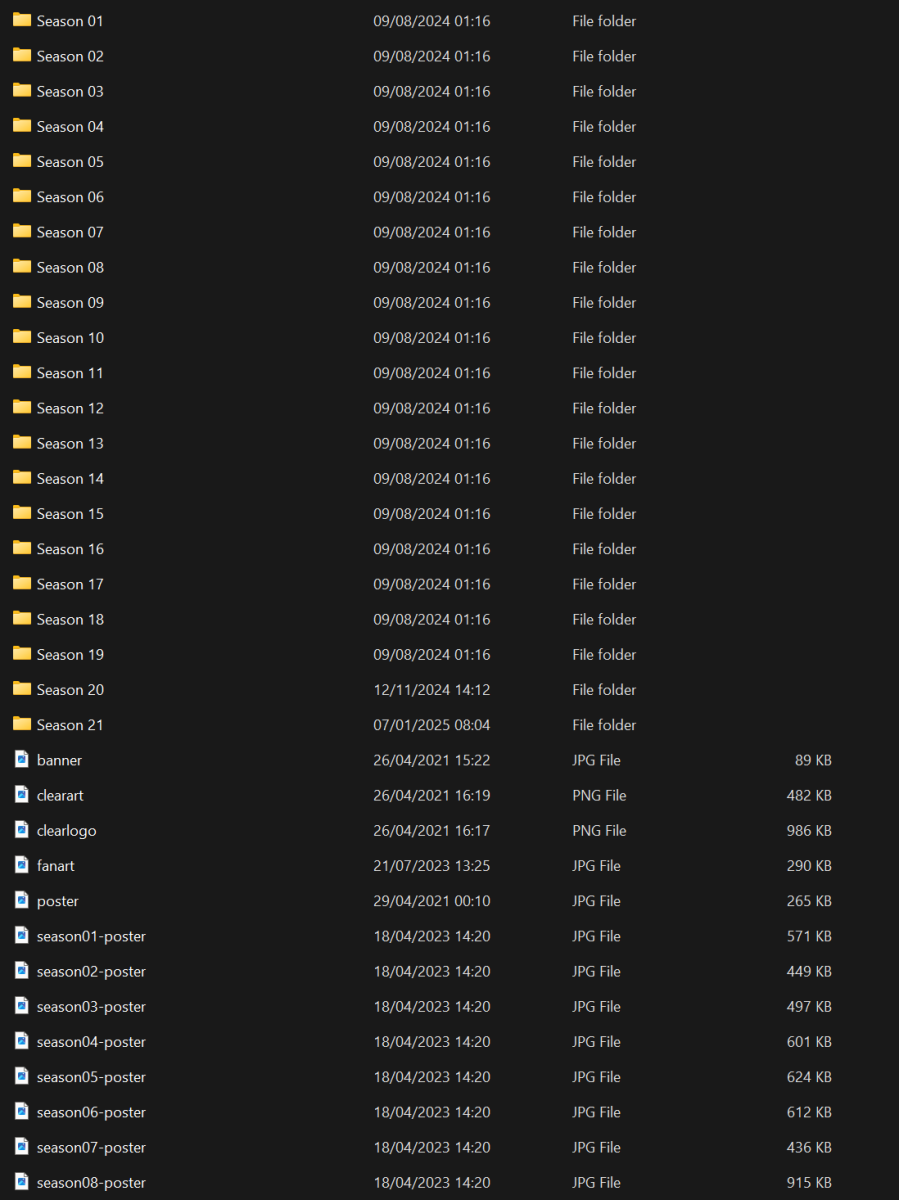

DaniRaiQ 0 Posted January 11, 2025 Posted January 11, 2025 Find attached screenshots to show folder structure and sample nfo file for local metadata afaik this is not the issue American Dad! - S01E01 - Pilot.nfo

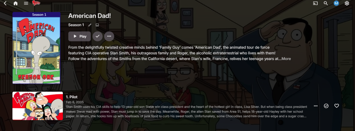

ebr 16306 Posted January 11, 2025 Posted January 11, 2025 3 hours ago, TeresaJane said: once it gets to 10 it starts merging 10+ specials, 11+1 ,12+2, Hi. Can we look at the seasons that have the problem? Also, a screenshot of exactly what you mean by the above would be helpful. Thanks.

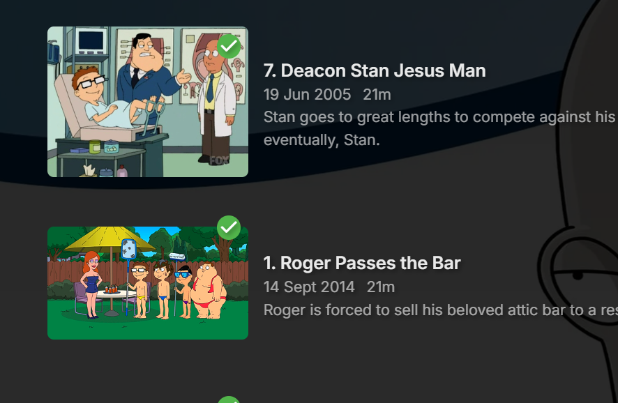

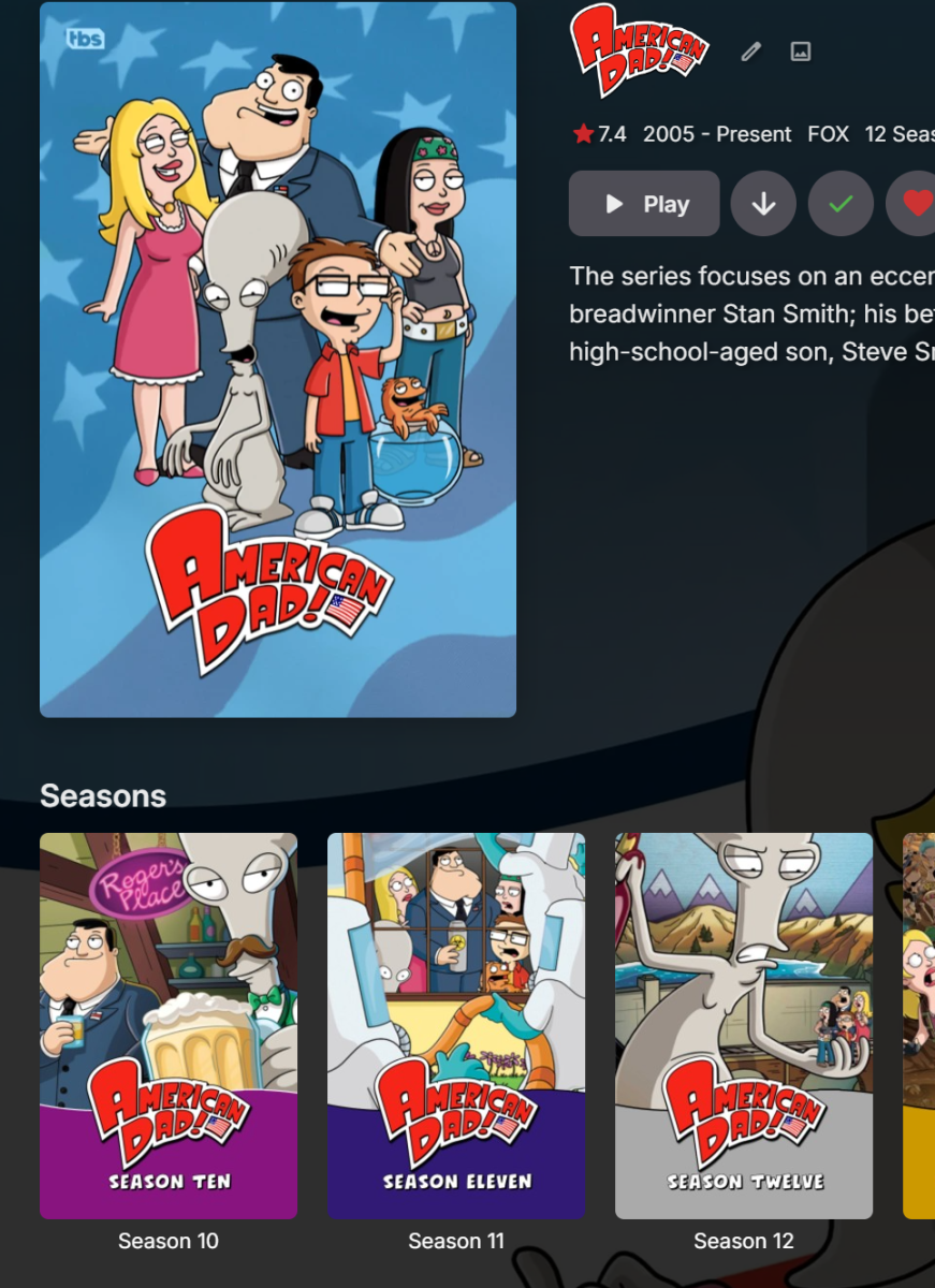

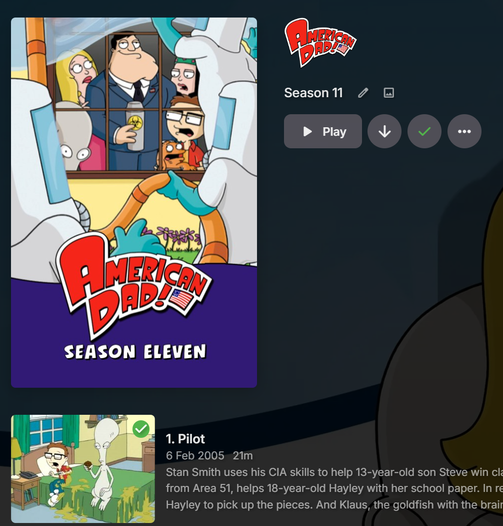

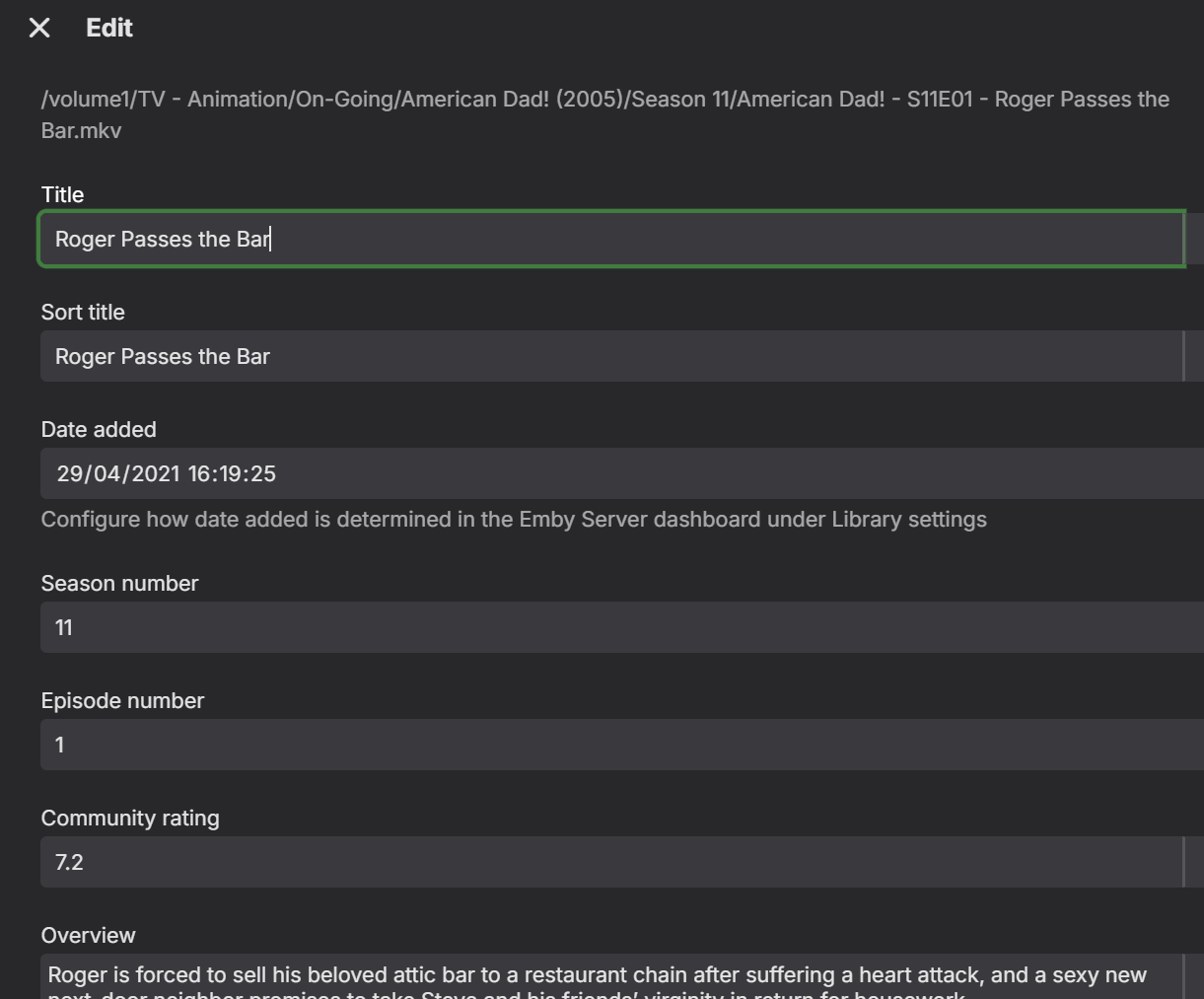

DaniRaiQ 0 Posted January 11, 2025 Posted January 11, 2025 (edited) so the screenshots show the show starting with season 10 season 11 starting with the pilot episode the jump between the end of season 1 and the actual season 11 the metadata pages for s01e01 and s11e01 Edited January 11, 2025 by DaniRaiQ
DaniRaiQ 0 Posted January 11, 2025 Posted January 11, 2025 note: almost every show with >10 seasons is effected and it only effects 0-9 being merged with 10-19 any shows that exceed 20 seasons everything from 20 onwards is fine
