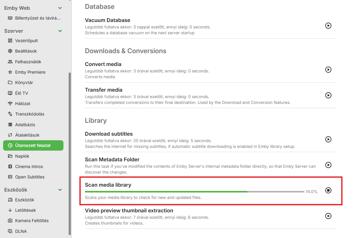

The media search task stops at 74% and halts after the set timeout.
Hi!
I am using the program on a Synology DS420+ NAS.
OS version: DSM 7.2.2-72806 Update 2
Emby version: 4.8.10.0-724081000
My issue is that the new media search task stops at 74% and halts after the set timeout. It reaches this point relatively quickly (around 20 minutes) but doesn't progress further for 6 hours. At this stage, the server either freezes or becomes unusably slow.
What could be the cause of this? The server contains about 3TB of media content.
LOG:

hi @ZoleeBBplease attach the complete emby server log file. Thanks !
@ZoleeBB
Hi, are you still having an issue?
13 hours ago, Carlo said:
@ZoleeBB
Szia, még mindig problémád van?
yes, unfortunately. :(
You have another error that will affect RTM 0 Real Time Monitoring
"The configured user limit (8192) on the number of inotify watches has been reached, or the operating system failed to allocate a required resource."
The log shows the same problem as above.
"Connection to https://www.mb3admin.com/admin/service/EmbyPackages.json timed out"

  • Test IPv6 Connectivity:
    Run the following command to ping the specific URL:
    ping -6 www.mb3admin.com
    What to look for:
    If the ping test is successful, you should see replies indicating the IP address and response times.
    If the ping test fails, you may see error messages such as "Request timed out" or "Destination host unreachable".
Step 2: Test Connection to Specific URL
  • Use the curl Command:
    To test the connection to the specific URL, use the following command:
    curl -v https://www.mb3admin.com/admin/service/EmbyPackages.json
    This command will provide detailed information about the connection attempt and help identify any issues.
Step 3: Check Network Configuration (If Step 1 Tests Did Not Work)
  • Check IPv4/IPv6 Configuration on Synology NAS:
    If the ping tests in Step 1 did not show successful replies, ensure that both IPv4 and IPv6 are correctly configured on your Synology NAS and Emby Server.
    Go to Control Panel -> Network -> Network Interface.
    Select the network interface you're using and click "Edit".
    Verify that both IPv4 and IPv6 settings are accurate.
Step 4: Network Interface Priority (If Step 1 Tests Did Not Work)
  • Set Network Interface Priority:
    If the ping tests in Step 1 did not show successful replies, in the Network Interface settings on your Synology NAS, ensure that the network interface you're using is set as the primary interface.
    Check for any IP conflicts and resolve them if necessary.
These steps should help diagnose the connectivity issue on your Synology NAS.
Let us know if this helped resolve the issue or not.  If you still require help, post the results of the two ping commands and the curl result.
Thank you very much for your help!
I created the RTM fix task and ran it successfully.
I logged in to the server using SSH through Putty and ran the pings with the sudo command. The ping (v4) responds immediately, but IPv6 is disabled on my side, so the "ping -6 www.mb3admin.com" doesn't work. I also tried the JSON query with curl, and I immediately received the JSON file content, so the server can reach it. I have now rerun the "Scan media library" task, but the result is the same.
I’m not sure if this is related, but another issue I’m facing is that the Emby app on Samsung TVs is very slow. After logging in, it doesn’t load anything for 3-4 minutes, it just stays gray, and then suddenly the content appears, and from that point, it works fine. But during the first 3-4 minutes, nothing works. I have about 2-3 TB of data, and I don’t think that’s too much.
I also checked the server load during tasks. During the media scan, the CPU is at ~30-40% and the RAM usage is around ~60-70%, which I think is normal.
hardware_detection-63873479538.txt embyserver.txt
