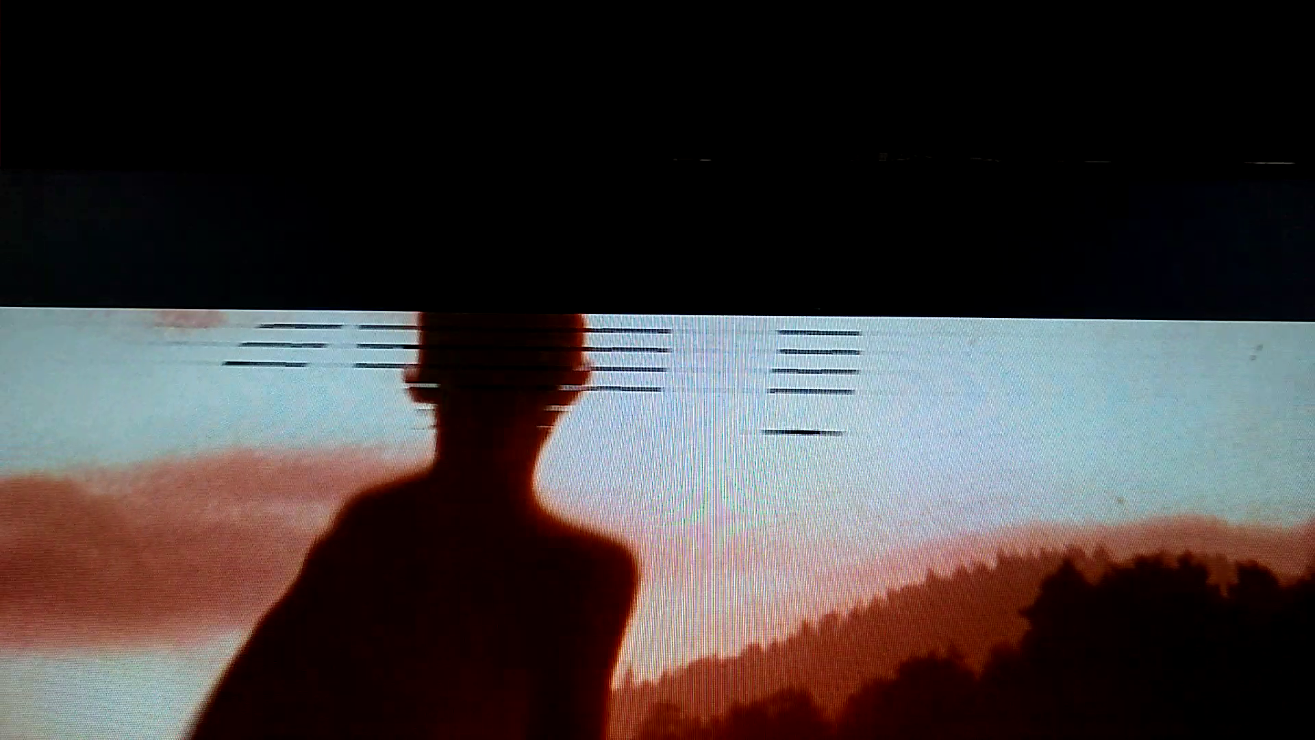

TheShanMan 41 Posted January 8, 2025 Posted January 8, 2025 With the new app I see random horizontal lines of varying lengths near the top of the screen in video playback. I've only watched 2 shows so far with it, one a 1080p movie and one an old standard def TV show, and it was worse in the movie, leading me to believe perhaps it's related to overall bit rate. I haven't noticed any playback options I can change that I think might fix it. Being random and somewhat infrequent, I haven't tried to capture an image/video of the problem, but will do so if this isn't yet a known issue with the new app. And to be clear, the same videos have no such problem in Theater. Do I need to tweak a setting? Is it a known bug? Do I need to get an image or video and a log file?

TheShanMan 41 Posted January 12, 2025 Author Posted January 12, 2025 Energy efficient has seemed fine so far. Going back to balanced, the lines returned. You say that's the rough equivalent of Theater but as a reminder and for whatever it's worth, I didn't experience this problem there. Picture shows a bunch of horizontal lines. Video shows the various lines appearing and disappearing. Emby app's log file for playback of this video attached as well. VID_20250111_154904.mp4 mpv-20250111T154704865.txt
Guest Posted January 12, 2025 Posted January 12, 2025 I think it's the scaling algorithms. Choose customize and use these options:
TheShanMan 41 Posted January 12, 2025 Author Posted January 12, 2025 That worked. Does that mean the default settings for Balanced have a bug? Or is it just that some settings will work for a given hardware configuration and some won't? If it's the latter, I wonder if there is some way Emby can guide a new user (new installation) to these settings with suggestions (e.g. prompting after stopping playback to ask if the video played correctly)? TBH my first impression was that the new app is buggy and I'm not exactly a novice type of user. I'd hate for others to have a poor experience if tweaking these settings goes with the territory. But... hopefully it's actually a bug that'll get fixed and there's no need to worry about that "first time" experience. Thanks for figuring out the optimal settings for me in the meantime!

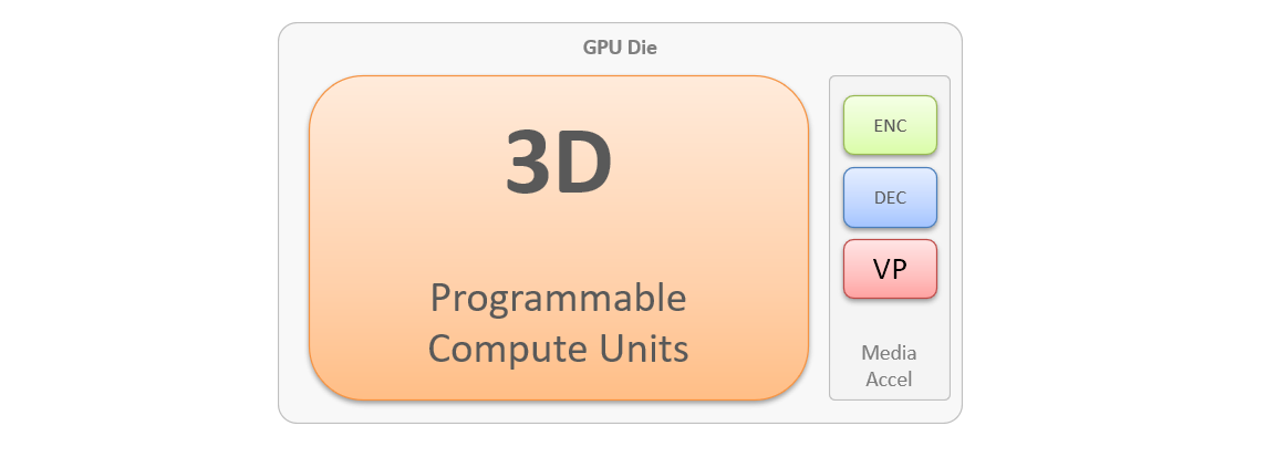

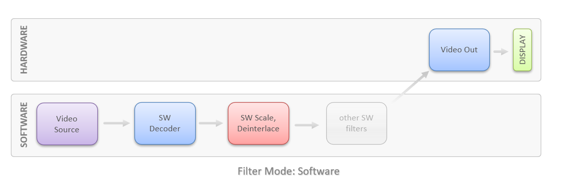

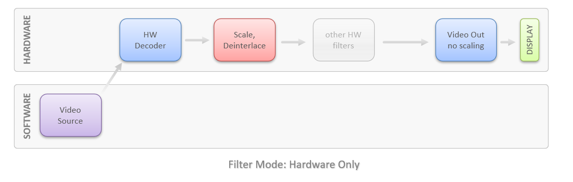

Guest Posted January 12, 2025 Posted January 12, 2025 Here's some information on how it works On 10/24/2024 at 8:08 PM, softworkz said: Technical Background Some parts of the options logic may seem a bit confusing or even unsuitable, and that needs some explanation. Let's start by looking at a GPU with support for hardware media acceleration: Obviously, this is insanely simplified, but just right for what we need to know. GPUs primarily implement media acceleration features by placing "fixed-function" blocks on their GPU dies, some kind of "asics", which means that they have a fixed logic which cannot be changed or re-programmed and provide certain sets of functionaliies which they can perform with maximum efficiency and low power consumption. Typically there's one or more encoder blocks and one or more decoder blocks. Some (like Intel) also have special units for video processing (Nvidia only has fixed-function deinterlacing and scaling, but that's built into the decoder chips. For all other processing, you need to use CUDA - and CUDA in turn uses the primary compute resources of a GPU - those for which we are all buying them (traditionally 3D applications and games. This is just scratching the surface, but it's all we need to know by know. What's special about MPV Player? What an average simple video player with HWA would do is similar to this: Feed the source video data into the DEC unit for decoding Use video processing (scaling, deinterlacing, color conversion) from the VP block (or elsewhere) And now the video frames are already done and just need to be copied (or ideally blended) onto the the desktop window hierarchy MPV has a variety of video output modules, but we focus on the primary ones: gpu and gpu-next. A leading narrative among MPV developers and enthusiasts is that the video quality of scaled video using GPU fixed-function (hardware acceleration) would be horribly bad and that's one of the reasons why shader-based scaling is the nonplusultra way to do it. So, what does that mean, "shader based scaling"? In contrast to the example above, processing is done right at the place where video is being rendered to the screen. Various stages of processing are applied at this stage, most importantly: Scaling and tone mapping or color adaption. All this is done via shader kernels which are mini-programs, running on some or all of the thousands of units the GPU has - which means that it is using the GPU's 3d resources, and that's a whole different dimension when comparing to fixed-function scaling which has close-to-zero cost. So MPV is going for quality rather than saving energy. The Filter Modes A recent discusion and internal tests brought the conclusion that it would be desirable to also have an energy-efficient mode which can be used when running on batteries or energy consumption is crucial for other reasons. MPV doesn't provide such mode, so we needed to create it. As a result, we have three filter modes now, which also map to the three primary presets. Hardware-Only This mode is intended to provide the best efficiency, least power consumption. The concept is to eliminate what is conisuming the most energy: Shader-based scaling at the video output. So, in this mode we are disabling scaling at the output stage and instead, we are inserting a hardware scaling filter. The video size and the video window size is being observed continuously. On changes, these values are used to calculate a new scale factor for updating the hardware scaling filter. In this mode, not all aspect ratio options are available. The dynamic cropping feature does not work here, because its need software filtering while this mode aims to do everything in hardware. Fit, Cover and 100% are still available, but are processed by custom logic in this mode rather than getting applied to mpv. Mixed Mode The purpose of this mode is to do as much as possible in hardware but still be able to use software filers. From the image below, it can also be seen that it's possible to use two different GPU's (blue boxes) - so there are always two possible stages which can be hardware-accelerated. In this mode, pre-scaling is performed via hw accelerated scaling. Pre-scaling only gets active in case when the width or height of the video is more than 20% larger than the monitor (not the window) resolution on whch the Emby app is displayed on playback start. It scales down then video in those cases but leaves it still 10% larger than the monitor, so the final scaling is always done by the video output (shader-based scaling). Software Mode Enthusiasts often want the best possible filter implementations, which can usually be rather found as software implementations. They will typically also prefer to have all scaling be performed by the video output, using shader-based scaling, so there's no need for a hardware (fixed-fnuction} filter. There's no hw decoding in this preset, because that's not efficient. Experience has led to the following rule of thumb: Don't use hw decoding unless you are doing something with that data (deinterlacing, scaling, etc.). For a 4k video for example, hw decoding makes sense if you also process or downscale the frame. But just for decoding, the data transfer has usually a worse impact than the benefit of hw accelerated decoding (which is generally small) - especially when uploading fromes to hardware again later, like in our case
